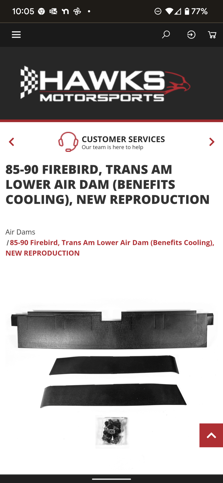

Is this it...

Originally Posted by simo
OEM Part Number 12395557
Is this it....

Re: Under carriage 1988 firebird GTA radiator cooling components
Yes, that is it.
I just put this on my ‘88 GTA and the temps stay right around 180deg now rather than running up to 220-240deg.
So is this Hawk's aftermarket air dam recommended over the OEM air dam? My OEM is still in place with no defects.
Hawks is a copy of the later GM revision. Functionally there's not much difference. If what you've got is intact and in good shape, stick with it.
The GM one from what I could tell is a more pliable material it seems from the ones ive seen in the junkyards. the Hawks one is very stiff and has no give!
Not a bad thing but it is less forgiving over parking tops and scrapes etc...
