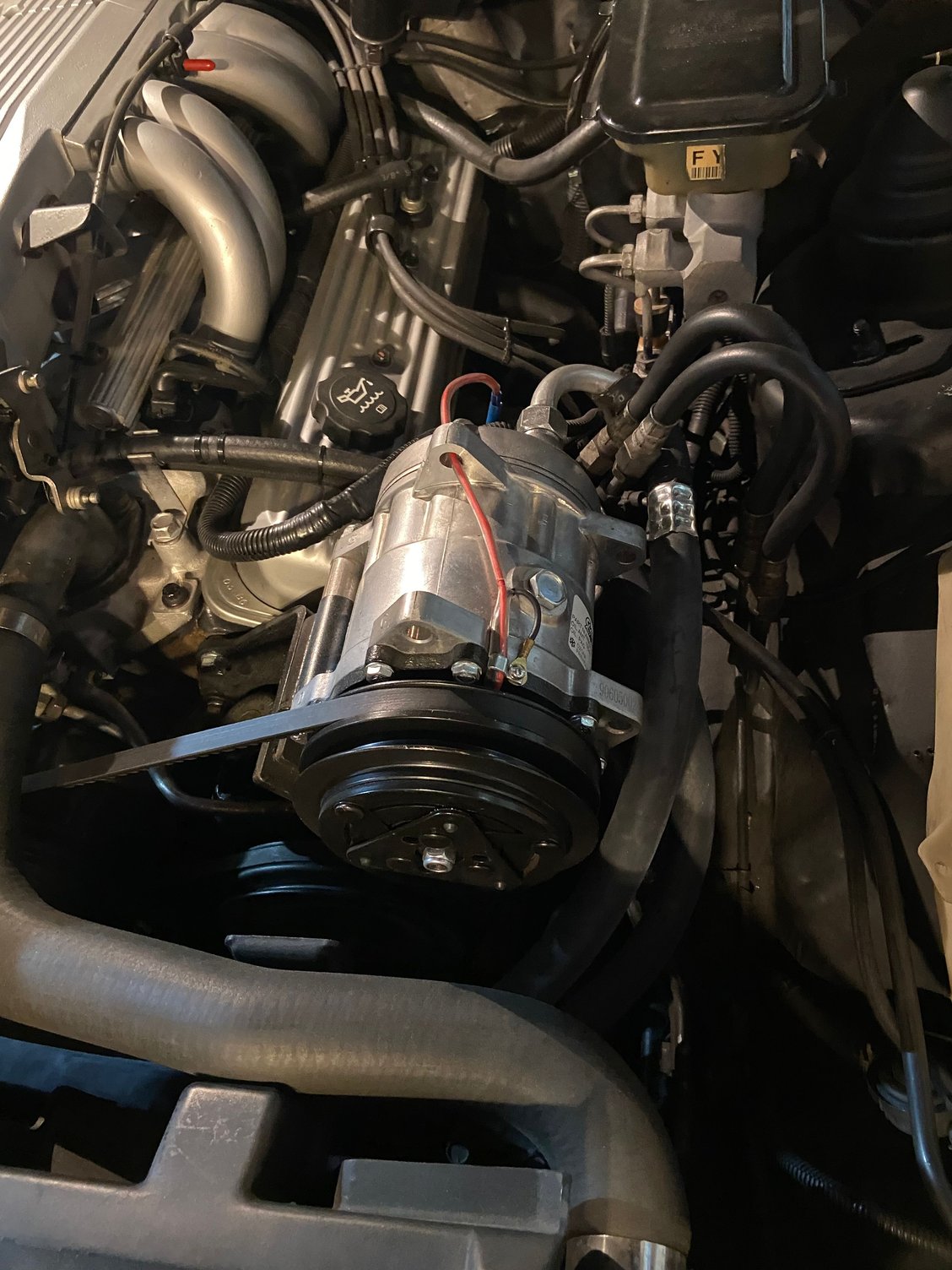

Hello, I’m trying to get my ac to blow colder, it blows cool but not cold.I have read where a bunch of you guys change the AC orfice tube to a red or blue ford orfice tube.my question is what do I ask for at the parts house? What year/model fords had the red or blue orfice tubes???thanks

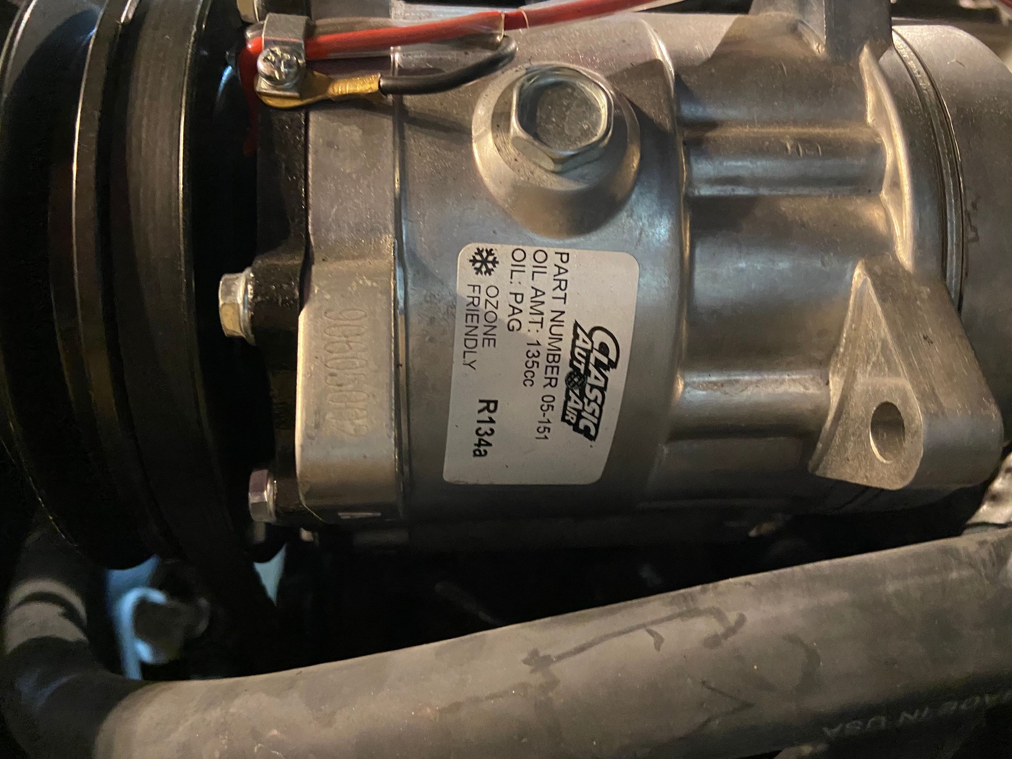

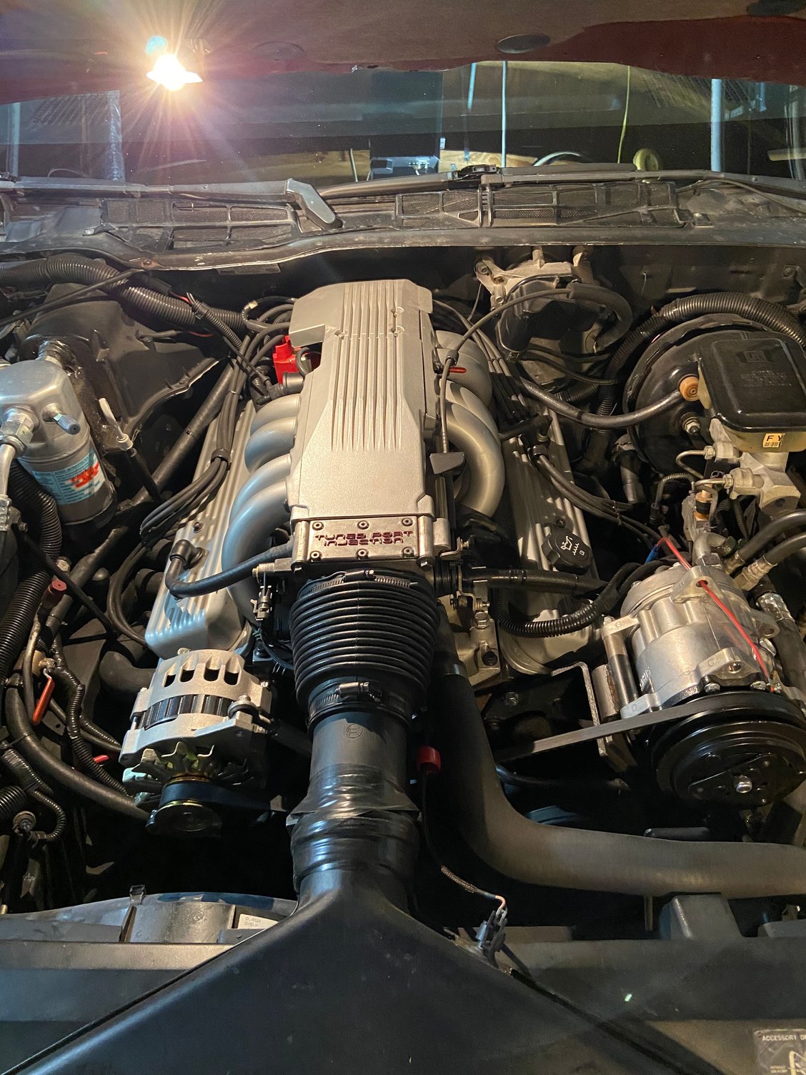

Thanks for everybody’s response.I installed this kit, has new condenser, compressor, orfice tube, I have upgraded LS1 dual fans (not over heating issues sofa!!) basically it’s all new stuff. Had it ducked down and check for leaks, no leaks and had it charged at a local auto shop.like I said it blows cool just not cold! I was just think if I changed out the orfice it might help, even if it’s just a little bit.

Is the label accurate?
You DO realize that you have to discharge it (bust it open) to change the OT, right? And afterwards, pull a vacuum on it, change the accum/dryer if it stays open for more than just a few minutes and especially above all if it's outdoors (non-climate-controlled, moist non-conditioned air), maybe change whatever O-rings you disturb, pull a vacuum on it, and recharge?
If, AND ONLY IF, the label is correct, the red/orange one would have been a better choice. If you're willing/able to do all the above then that's probably the best next choice if the OE white-ish one is in there now. The original OT is optimized for R-12; R-134 has a different pressure <–> flow <–> temperature curve. That's what changing the OT does, is to select an orifice diameter (really quite a simple detail difference, actually) to match the system's behavior to what the refrigerant characteristics want.
