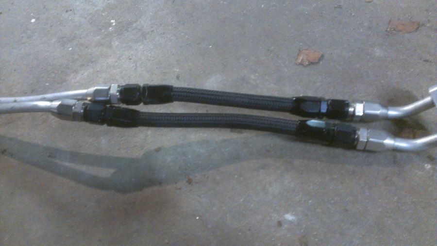

After a few "Trial and Error" fitment experiments; I decided to implement a short section or High-Pressure Crimped Braided-Stainless (Teflon Core) Hose.
I use a Three Inch section of the Hose for each Aluminum Pipe (Inlet and Outlet)...
This makes it very easy to get everything aligned nicely, for the Two holes in the Fire-Wall.
Here is an Image of My modified Stock Engine Oil-Cooler Lines below (Black Braided Material over Teflon Core).
Just Imagine a 3" section of Braided Stainless Steel in the middle of 1/2" or 5/8" Aluminum Pipes, for the Heater-Core:
