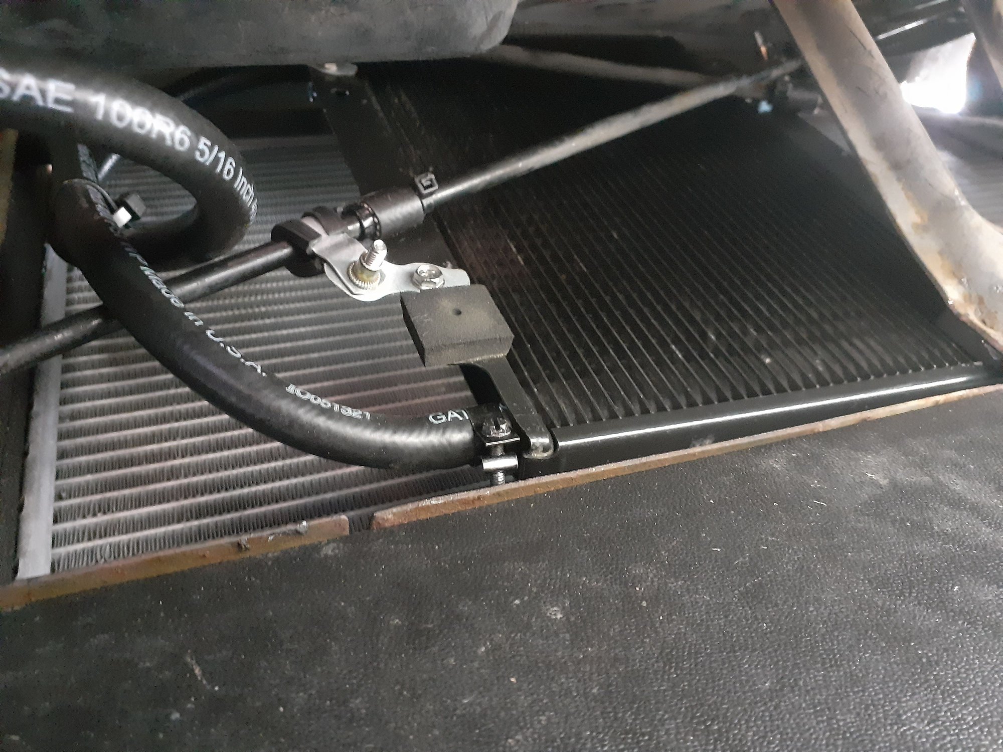

I'm digging into my A/C delete, removing the condenser, and currently have the best access I'm going to get to this aftermarket trans cooler:
It's attached via two zipties to the body and a pair of three foot long rubber lines clamped to hacked off hardlines under the car. It leaks at that connection and I'd like to redo this whole situation. What would be the best way to incorporate the factory trans cooler in the radiator and this one together?
Would the ziptie style through straps work to mount it directly to the rad with my stock twin electric fans, or should I make brackets? Can I feed trans fluid into the bottom of the radiator cooler, output fluid from the top into the top of the aux cooler, and then return from the bottom of the aux cooler to the trans? Or should I always go from top to bottom?

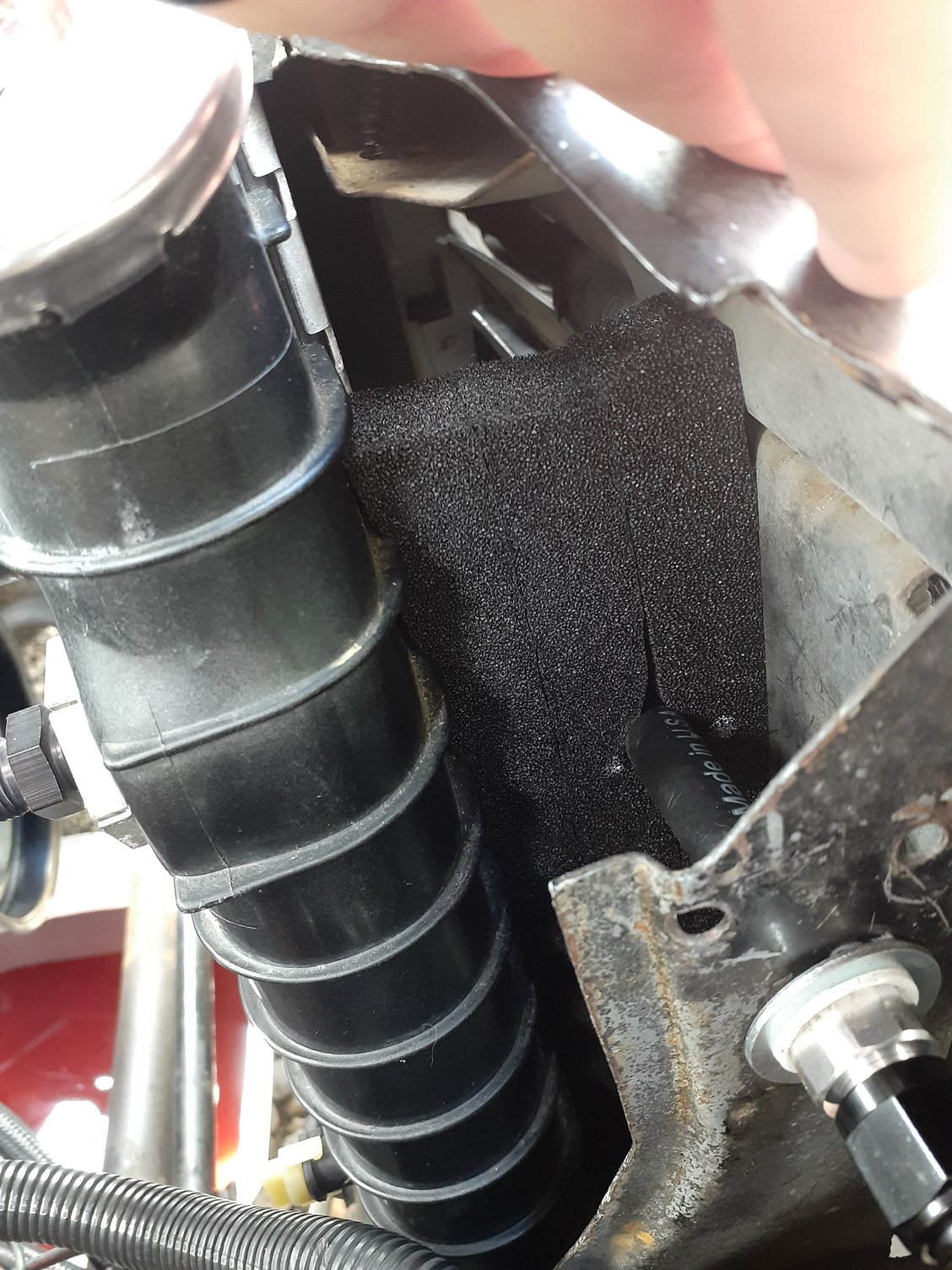

  • Magenta lines are to and from cooler. For the sake of simplicity, I think I'm going to mount it in front of the rad. Does distance matter here? Should I duct any / all of the coolers? There was some thick foam between the condenser and rad, but I'm not sure if I need to replace it without the condenser there.
I am no expert but I would re-use or get new foam pieces if you mount to the radiator to be safe. From what I have read that little bit of distance helps to not create a hot spot and get a little more air to help cool. But tru cool also states that using an aux cooler should lower system temps as there is less load and will not increase engine operating temps when asked about placement in front of the radiator.
I think you have a solid plan, I would check for a part # on your current cooler, it might already have the thermostatic bypass as some cone with them.

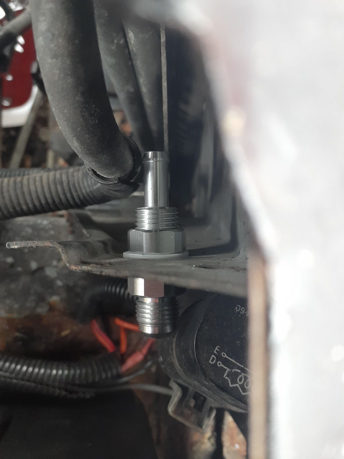

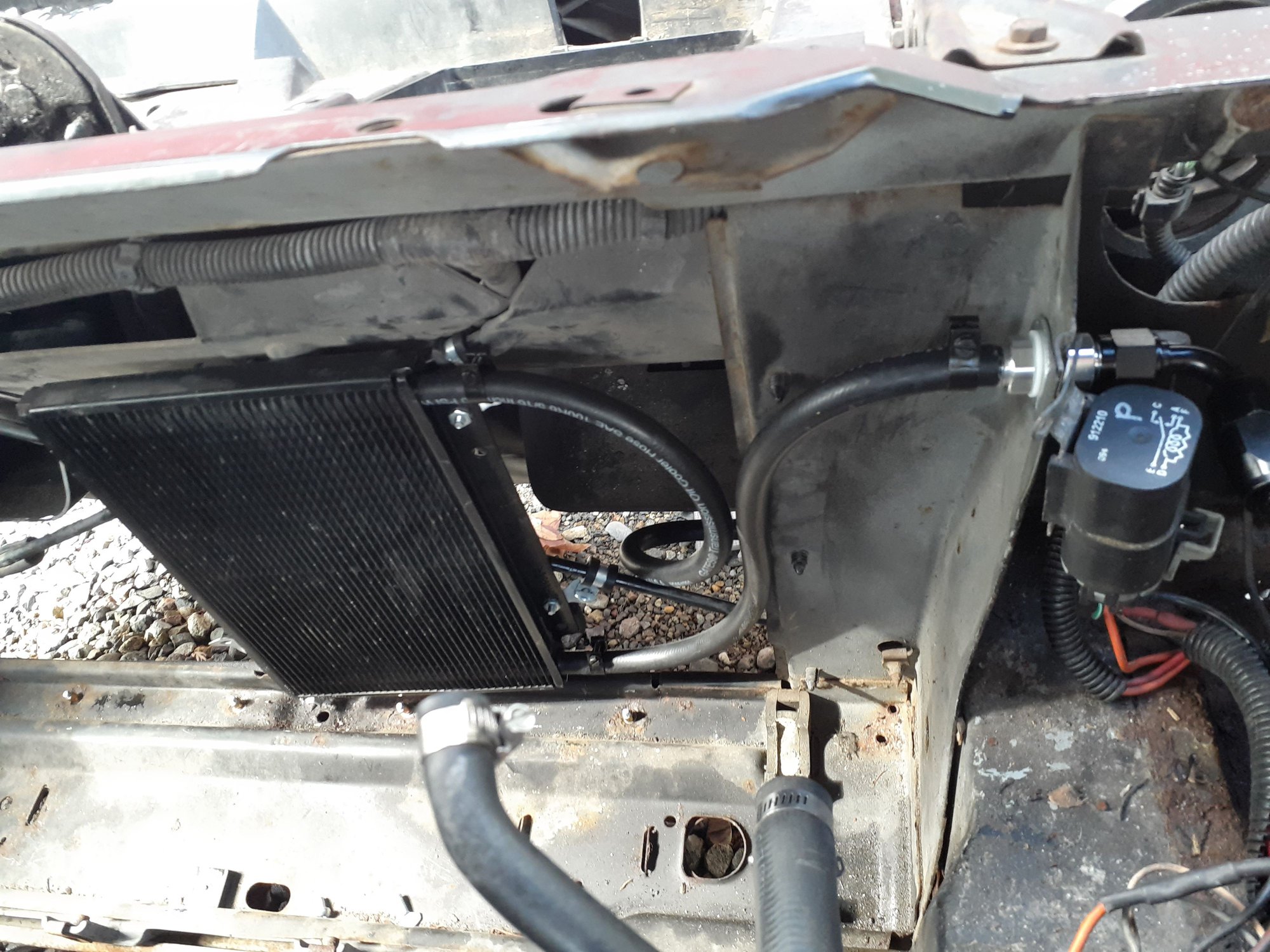

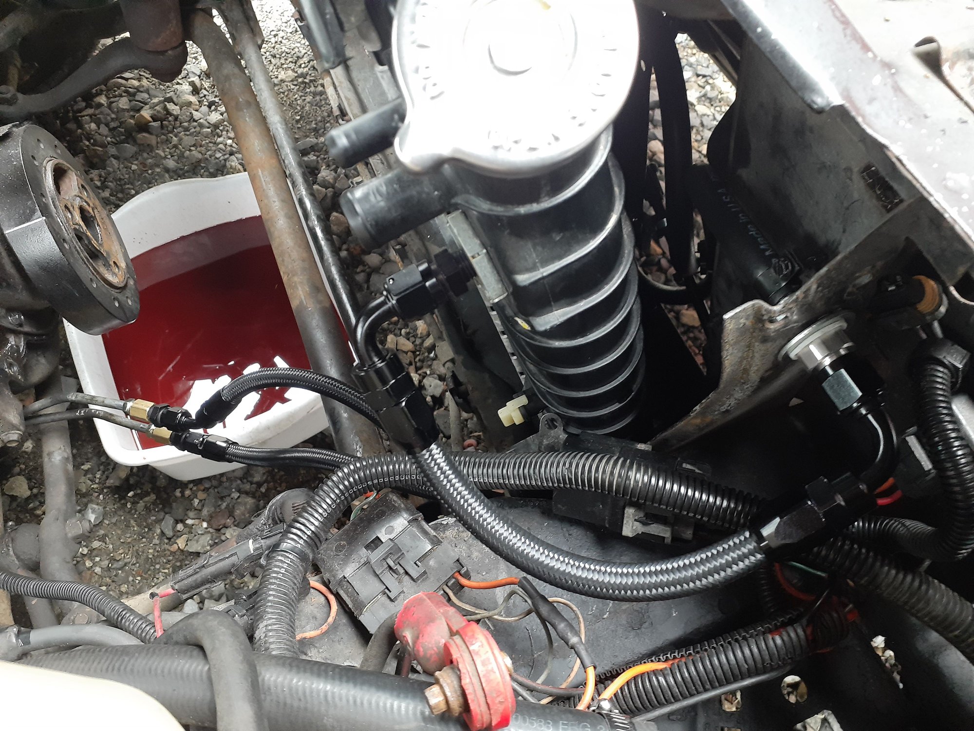

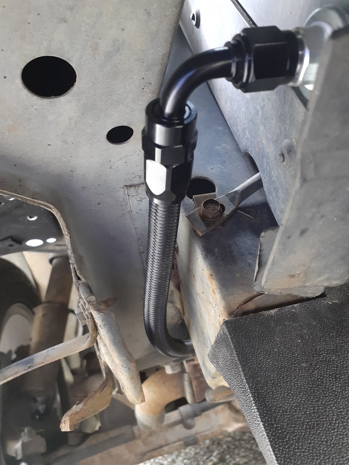

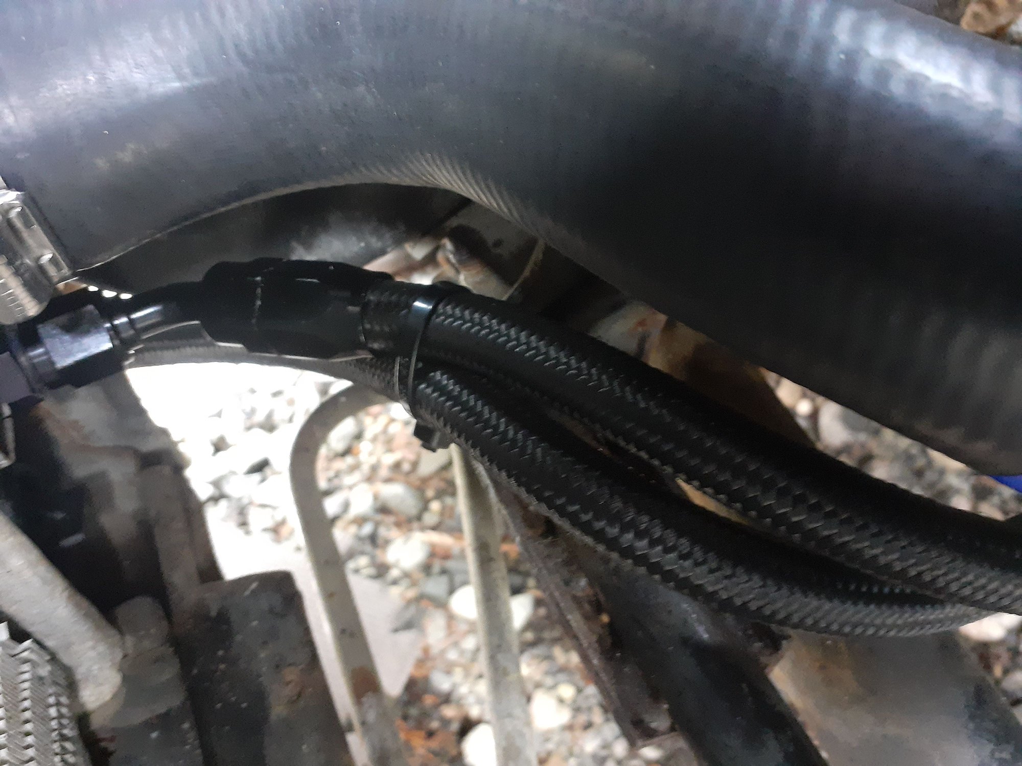

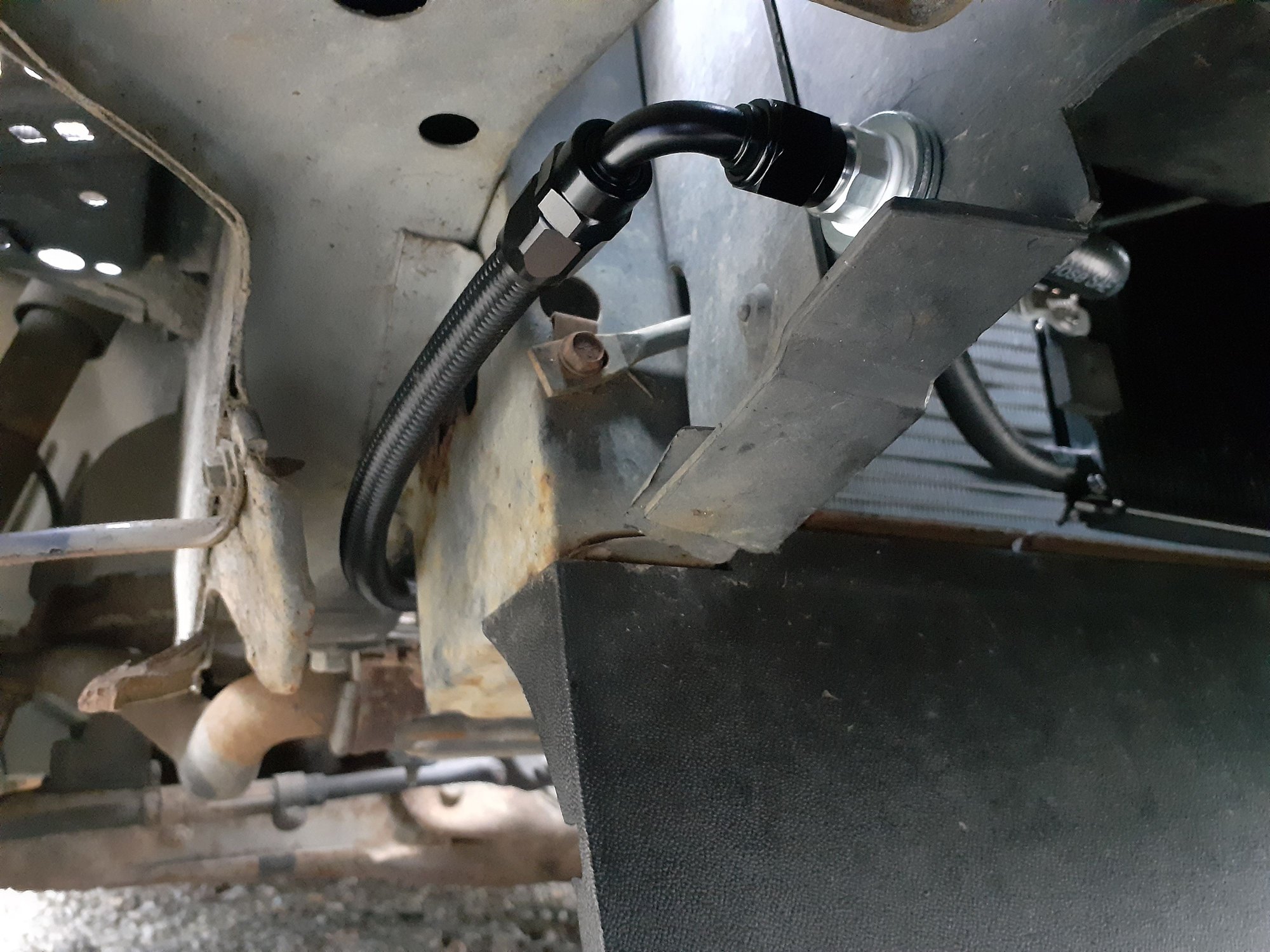

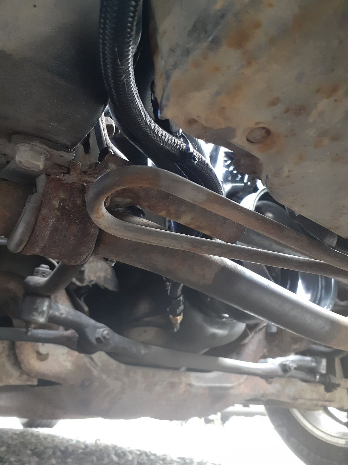

FWIW, I added a B&W 70273 cooler after upgrading the converter. Sorry, pics aren't very good, but I plumbed AN fittings to the top radiator transmission cooling line.

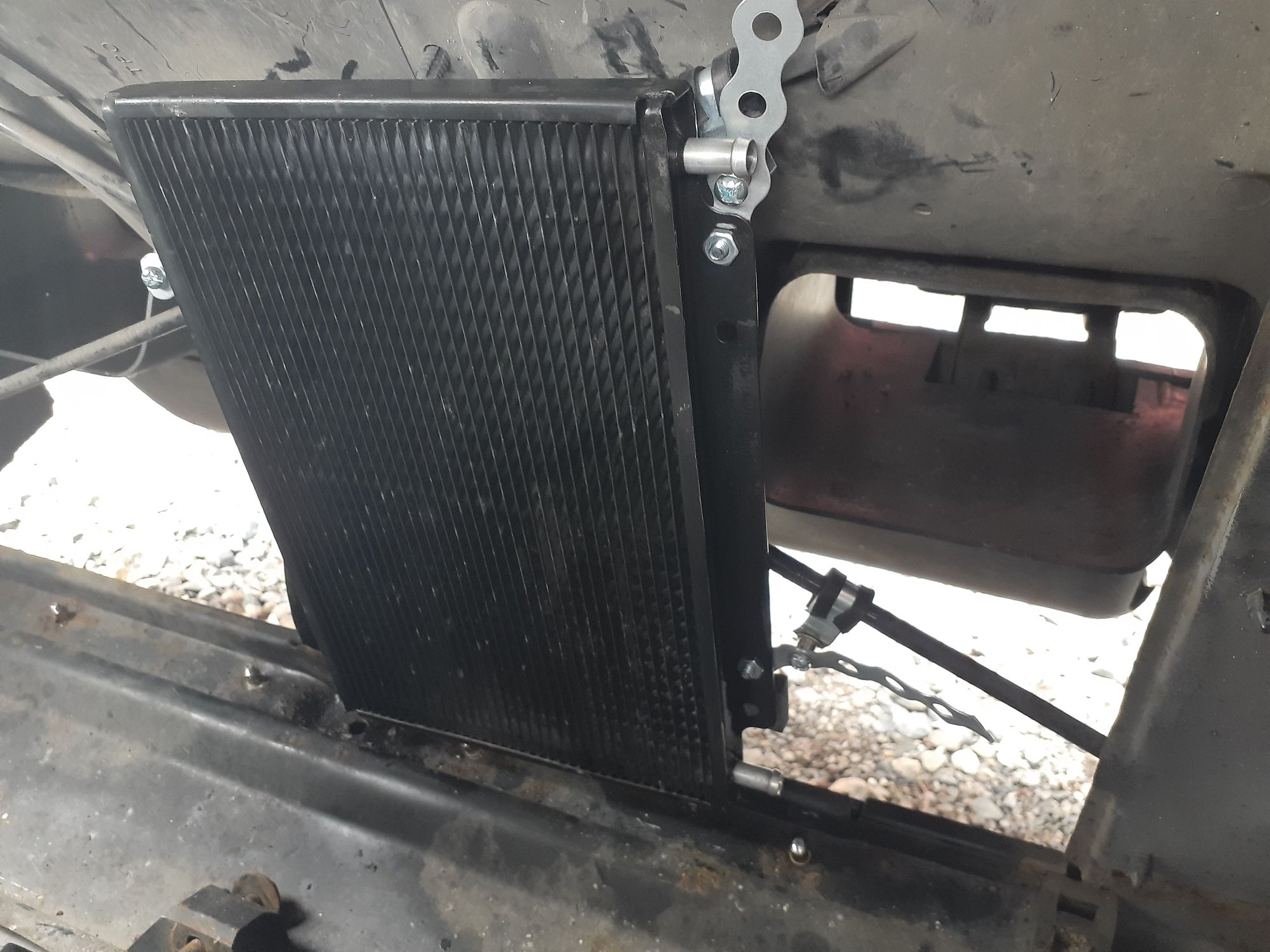

Progress update, I'm considering this a first functional mockup of the best idea I've had so far. I decided to try a non-destructive approach to attach it to the car, so I've got three cable clamps to get bolt holes on the cross bars, with one direct connection that reuses the factory bolt that secures the front bits together. Mostly stuff found in the home depot electrical section. I will probably swap out the hardware for hex head bolts once I finalize sizes and lengths. It's surprisingly secure even without the clamps fastened.
I had to flip the cooler around so the flat side is facing towards the front of the car. Looking through the cooler, it doesn't appear to be directional so I think that should be ok.

That is really slick, I like how you utilized what is there. It will be a clean install and definitely better than zip ties IMO.

Agreed, I'm doing both in that order. I think the previous owner came up with this idea to get heat out of the rad to "fix the overheating", all the while running the car without a lower air dam .
Feed lines into both coolers are going in from the bottom ports to fight aeration, and I'm adapting my hard lines to AN where they've been cut and running custom lengths. I got a pair of bulkhead fittings to pass them through the stock holes on the body, depending on fitment with the condenser.
I went with the absolute cheapest AN equipment on ebay. Clearly nothing could go wrong here.

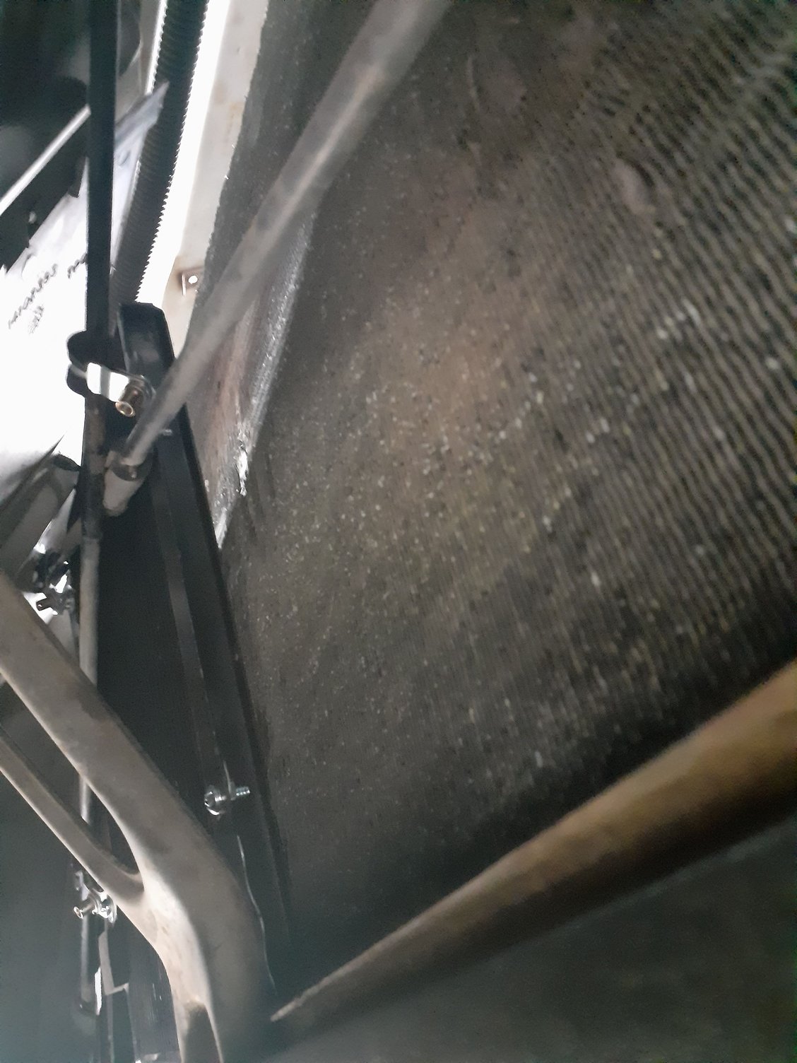

It fits with the condenser! 1989karr you were right, it's very tight on the bottom.
I might try to get it to sit up a little higher, but I didn't have to fight the condenser at all so I don't think they're touching. The cooler is very secure with everything clamped down, the cross braces start moving before the cooler does when I tugged on it. My idea to use the factory holes for the bulkhead fittings probably isn't going to work:
But, there does appear to be enough room available to still use that area with a new hole for the feed into the cooler. Still deciding on how to pass the return back to the trans, there are a few possible routes since the line can travel lower in the bay.

I ended up ovaling out that upper hole a little too give the feed line just a little more space, but it sneaks behind the condenser just fine. I'll need to put a gap in the sealing foam strip to let it pass through but that's no big deal. Looks like I can mount the primary fan relay using the middle hole on the bracket to the left hole in the factory spot, and the 90 AN fitting sneaks right around it:
I tried to go for the easiest bends I could get:
For the return, I decided to go through the plastic ducting, which will point another 90 AN fitting directly back across the frame rail. The idea is to sneak up into the engine bay, overtop the wonderbar and sway bar, and hook right back into the return hardline:
Nothing is clamped down yet, just loosely fitted. Check out the brutally broken tow hook. This car has seen some interesting stuff.

I finally have all the pieces together and somewhat finalized. Trans cooler hardware is all locked down with stainless and nylock nuts. The rubber trans cooler line has the perfect ID to wrap around the cross bars, I used discarded hose end bits as vibration isolators where the cooler might touch and locked them into position on the bars with zip ties. I also jammed one of the original cooler pads with some fresh double sided tape between the center frame support rail and the cooler. It doesn't make any noise or move at all when I jiggle it so I think it's good.
Flared what's left of my hard lines on the car. It wasn't easy, but I think my result is acceptable:
Here's what the beginning and end AN lines look like. Hopefully the double adapter won't bite me, doing it this way saved me $30 in fitting costs. I'm thinking about tying the two lines together, and the slight residual tension between the two lines will keep them centered between everything once it gets busier in this area.
This is the intermediate line, radiator cooler out to aux cooler in.
And this is the other end of the return to trans line under the frame rail.
Will it leak? No idea, lol. Picked up some 1"x1" expanding weatherstrip foam at the hardware store today. I figure I can double or triple up on it and fill the gap between the rad and the front of the bay.

Update: it works! I got everything back together today and after tightening down 3 minor leaks (both flare nuts into the brass union, and a softline to bulkhead connection), I have a leak free setup. I guess we'll have to see if these cheap fittings stay that way but so far, so good. Here's some pics of the final orientation:
Weatherstrip foam, 3x 15 or so inches on each side. I guess I could have filled the gap at the top as well by making them longer but this should duct as well as oem I reckon.
Ended up using the 45 to sneak around the lower rad hose:
45 feed into the rad, holds up lower hose with zip tie:
Everything hangs nicely and doesn't rub:
Final hardware for cooler, as viewed from underneath the bumper:
Easy bends all the way:
