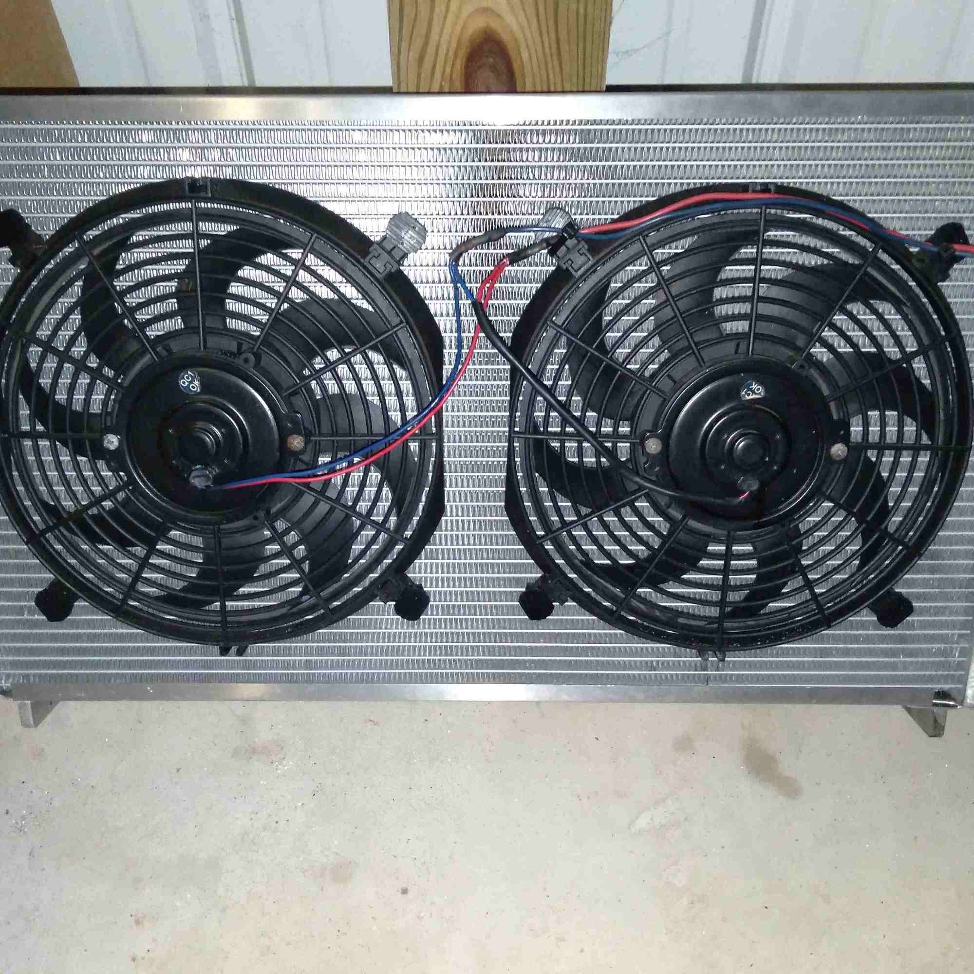

I just got a 91 Z28 350 auto. It has an aftermarket radiator with aftermarket twin fans that are wired together. No name on fans. When I apply power to the wires only one fan comes on. Is it possible/probable that the second fan has an internal temperature switch? Haven't had it on the road so I don't know if I have a problem. I know I should probably wait and see but if I have a problem it's a lot easier to fix now that I have the radiator out of the car. The fan does come on when I turn the a/c on (low pressure switch jumped). Should each fan be wired separately. They are now wired to the wires shown circled in red. Both sets of wires have a black wire & a black wire w/ red stripe.

They look kinda inadequate... like ebay $10 specials.... Im guessing the one that doesnt run is dead or something is wrong with that wiring.... they should be run separate too.
No shroud etc... the wires look thin so I don;t think they pull much current which is the only plus..... I doubt it has any kind of internal temp swatch
id dump those and go LS fans! ...even a stock single fan should cool better.
if originally it had only ONE wiring harness for a single fan, i don;t think its a 350 unless it was swapped.

VIN verifies a 350. In the pic with the wires there are two sets of wires. That's why I was wondering if it is supposed to be wired for two fans individually. One for a/c and one for the hi temp. Would it matter which fan is on the left or right? Any pic?

Driver's side fan was ECM controlled from the factory. Passenger side fan turned on with AC or via activation from a temperature switch in the passenger side block / head, can't remember precisely but it's up in that area. Both were hooked up to relays since they draw substantial current, schematics are available in the factory service manual.

Factory, the two dual fans were wired separate and had separate relays.
From what i can recall.... on early dual fans.....the passenger side came on when the ac came on, or when the car got to a certain temp and the computer commanded it on.... then the secondary driver fan would kick on via a coolant temp sensor in the passenger head depending on engine temp.
I read that on I think 89 - 92??? both fans came on for the ac since it made the ac work better. but the fans were stil controlled separately for actual cooling.
I swear there was a more detailed tech article about it but I found this:
GM F-Body Electric Coolant Fan Specifications and Modifications (Dual Fan) - ThirdGen.Org
I can get pics of the original TPI dual fans and a Ls1 dual fan since I got both lying around. .
The Ls1 fans will plug right into the TPI connectors as the motors are the same physically.....BUT they do suck more energy as they are internally different and pull more amps than TPI fan motors....... My compromise so far is a LS1 fan shroud but with the TPI fan motors since they drop right in.... even the fan blades themselves are the same! .
IMHO though, if you are going to go and get original stuff, id just upgrade to a set of LS1 fans.... the shroud pulls / directs more air. for better cooling vs the shroudless TPI fans.. .
Just beware of the extra power they draw and consider using the TPI fan motors.

If I went to a junk yard and found one that would match up to my radiator I could get the pig tail that I'm missing? Would most newer than 91 fans/shrouds out of a v8 work good enough?

I would start by defining how / when you want your fans to run, then come up with a wiring game plan based on what's left in your engine bay. The factory harness will only be a substantial benefit if you're running a stock setup, otherwise you'll have to mod it and might as well just start with fresh wires.
Ls1 shrouded setup is pretty popular for upgrades.

There's all types of fans... and any would work really....you'd need to get creative with the mounting depending on the design.... I personally found the LS1 fans fit perfect. For me, it slides right into the base by the radiator and I modified a stock upper radiator bracket to hold it in place so it al look's stock. .I saw some people found them to be a "nightmare" to put in??? For me, someone with low fab skills, i found it extremely easy. Just a little trimming etc....
I'd just do 4th gen F-body V8s for simplicity though.... the motors are all more less the same physically and the connectors are all the same as well..... (you can buy connectors new but they are expensive)
93-97 LT1 fans are the same basic design but are thicker than Ls1 fans and would need more work to fit in. They use either TPI or Ls1 fan motors depending on the year... .blades are also the same as LS / TPI fans... the fans can be removed individually from the shroud though so technically easier to service.
98-02 V6 and Ls1- V8 fan shrouds are the same physically as are the blades.....but the v6 use smaller powered motors and actually look a little different but use the same connectors..... But the shroud is what you really want.
You can see mine in #4..I put a pic for both LS and LT1 fans

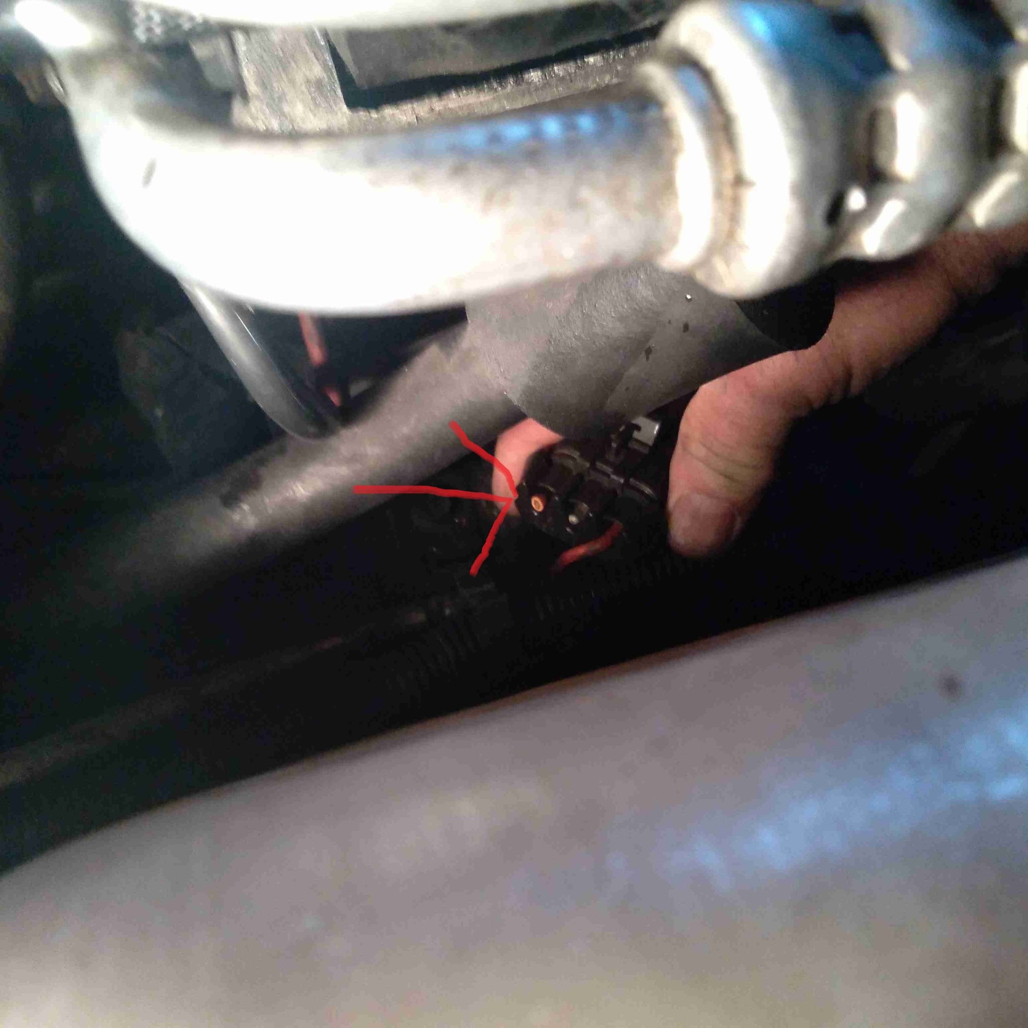

The fan wires up by the battery/radiator do not plug in to the harness. They are part of the harness. My fan relays are on the firewall left of the master cylinder. Both relays have power with key off. I tested both with a meter and they are both functioning properly. When I jump them I get power at the fan wires by the radiator. One relay per set of wires. I can not get power to the fan wires with out jumping the relays. Key on, a/c on with low pressure switch jumped. A/c clutch engages but no power at fan wires.
A large wire loom goes across the top of a/c evaporator towards the engine then down. It T's at about the intake & valve cover then towards the front of the engine. I peeled back the large loom where it goes down & the one on top of the engine and I can not find any wire that would go to the coolant temp sensor for the fan. I have a manual on the way. From what I've read the coolant temp sensor wire is yellow. Correct me if I'm wrong. I know it has to be there somewhere. Ideas?

Yeah, it looks like the PO cut the wires right before the connection. There would be a removeable connection in that area unless the newer models didn't have it.. I noticed that I only see 87 and then 88-89 dual fan connections available new......maybe yours was integrated into the whole harness by 90.
" I can not get power to the fan wires with out jumping the relays. Key on, a/c on with low pressure switch jumped. A/c clutch engages but no power at fan wires"
The fan takes a while to come on with the ac on as it reads the pressures.... the sensor in the hard line on the frame rail wil lturn it to come on and will have it come on when disconnected... but im not sure if there would be any delay in signal.
"A large wire loom goes across the top of a/c evaporator towards the engine then down. It T's at about the intake & valve cover then towards the front of the engine. I peeled back the large loom where it goes down & the one on top of the engine and I can not find any wire that would go to the coolant temp sensor for the fan. I have a manual on the way. From what I've read the coolant temp sensor wire is yellow. Correct me if I'm wrong. I know it has to be there somewhere. Ideas?"
On my 87, it connects from the connector into that large loom, and then goes with the knock sensor wire down towards that area.. .wire is black. I heard they are all black regardless of year.
have you tried checking the wiring for the knock sensor? Have you also found / seen the old fan sensor?

I thought the knock sensor was up by the intake. Where is it? I saw a pic of the coolant sensor, the wire was green. The schematics I saw say yellow. I don't know.

Knock sensor is by the starter / below the fan temp switch. They both use the same connector....you can only see them from the bottom of the car really.... the fan switch is in-between the spark plugs right under the exhaust manifold if its still there. ....The relay ground is green i think..
any color is possible really due to varying years/ what the owner did...........but im banking on the wire being black or green if its still there...

The a/c compressor cycles on and off as it should.
Engine running: I have power at the primary fan wires (black/red stripe). It doesn't matter if the temp switch is plugged in, unplugged or grounded. Nothing changes.
A/c running: if I disconnect the a/c pressure sensor in the hard line from the condenser to the evaporator nothing changes. I do not get power to the secondary fan wires (black/pink strip) no matter what I do. Exception: I get power to the secondary wires only when I jump the relay.
Now the service engine light is on and it runs ruff. I looked for a vacuum hose or wires off but they are all connected.
I found some cut wires.
The plug has a red wire cut off going into plug and coming out of plug, circled/arrow in red.
The red wire that runs through plug is cut at the green circle and has power with the key off.
Spoiler

the compressor shouldnt be cycling?.... I mean it DOES but in short operation it shouldnt be cycling if it has a full charge. Seeing as you don;t have fans installed yet though, if its cycling in that short ioperation time, im thinking theres not enough refrigerant? It wouldnt send a signal to turn the fan on if its cycling I think as it wont build the proper pressures?
Maybe someone grounded it to be on at all times... is there a switch anywhere on the dash etc? Youre talking about the ecm temp switch correct? Not the fan switch? the ECM sends the signal for the primary fan.
Overall it sounds like the car has several wiring issues unfortunately. I think the best thing to do is get the radiator and fans installed so you can run the car longer and do diagnosis without worrying about the car overheating etc...
can you see what the other wires go to?... i dont think those would be related to the fan though... pull the codes for the SES light.
i'm thinking the former owner ditched the OEM fans and decided to install those two small fans... they didnt cool enough so they somehow wired the primary fan to be on constantly. (mine was on..turned out to be a short in the wires at the relay cause they were al lcorroded)
Id sort out the coolant temp circuit before the ac fan operation first.
Try look at the primary fan relay. ground wire ..... I THINK its the same color as mine... so the relay ground wire would be green with white stripe. Try trace it down. My guess is that they grounded it somewhere
Mine is connected to the ECM and I added a fan switch circuit so it comes on via the fan switch in the head first. ... if it were grounded directly to something it would be on constantly.
As for the secondary fan switch activated fan... regarding it not getting power when the fan switch wire is grounded... trace the ground wire back to the relay... it should be simple. it could be cut or broken in between the switch and relay.. if thats so, just wire in a new wire to the fan switch.
You;ll find the issue. You'll just need to dig a bit deeper to find it.

I was looking under the dash right side and found a few drops of antifreeze. GREAT. So I have a new heater core now. The dash has a plastic cover on that covers the badly cracked dash. This car isn't the gem I thought it was but when I get it all done it will be. I have the power steering pump out.
New coolant sensor in intake by thermostat.
I didn't find any wire that was grounded/spliced.

Ugh.. heater core... its not as bad as it seems though. ...Im not sure about camaros... but for Firebirds i was able to remove the top heater box bolt by using a flexible extension... it was actually super easy.. .the HARDEST part was removing the hoses nd this was back in 2002 when I didn;t know about inserting a pick to break the seal etc.. or much about cars lol
I think the easiest would be to get some fans installed and see what happens / how it operates. Could be a short in the wiring / relay somewhere?
