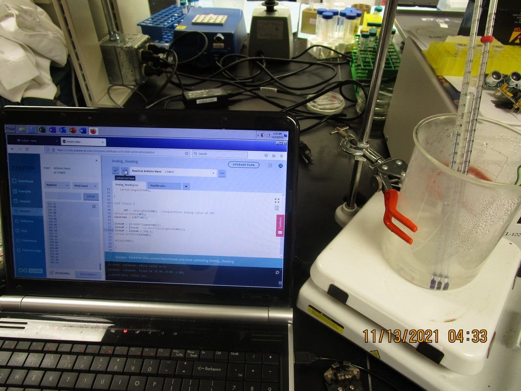

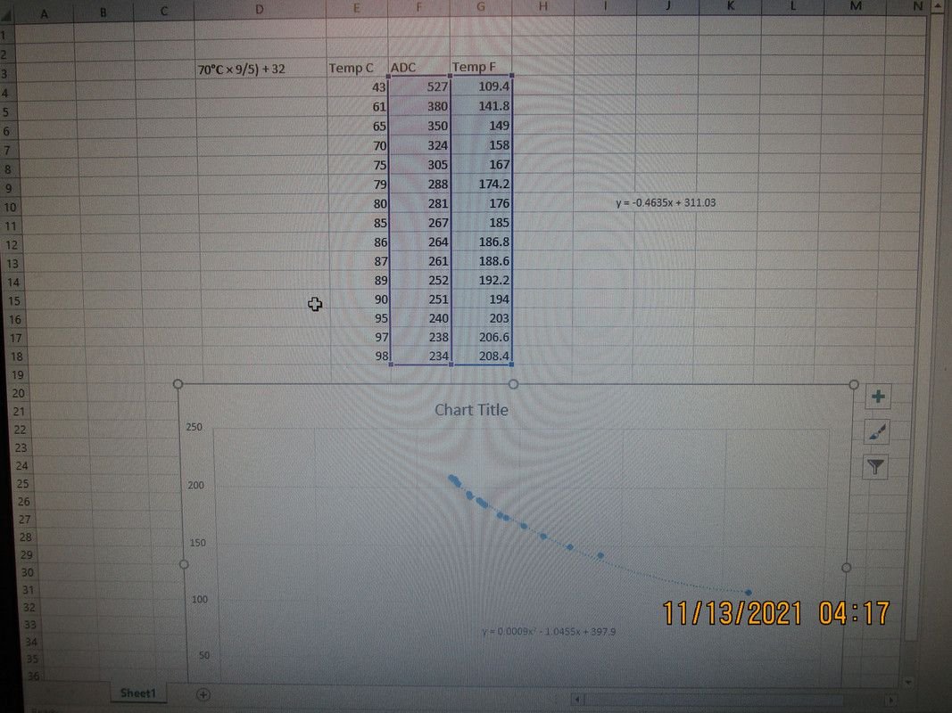

Arduino is very cheap microcontroller that can control fans using $0.25 temp sensor and $0.12 transistors to drive fan relays.
https://forum.arduino.cc/t/arduino-n...estions/620615
I've since improved the layout and use of parts a bit. I now use a darlington pair of 2N2222 NPN transistors to drive a pair of fan relays.
I always use 2x 40-Amp Fan relays to drive 1x 30-40amp Fan. Never use a single 40amp relay to drive a ~40amp fan, it will eventually melt in my experience.
40amp relays are not designed to run 40amps continuously apparently.
The microcontroller can be fitted with an LCD screen to view temp monitor, and manually activate fans for testing, etc...
It can run pretty much any device on the vehicle. It can activate fuel pump relay (or deactivate for security/theft). It can run little LED lights on your dash for warning. I can activate servos or small motors to run water spray or unlock things from the inside... its a handy thing to learn to use.
Heres a pic of the LCD screen fitted to monitor temps.
I used excel to curve fit the resistance of the temp sensor I got from ebay to a non-linear expression you just plug back into the microcontroller to monitor temps.
I used a hotplate to determine the various resistance of the sensor through a voltage divider, the purpose of this is to verify the accuracy of the sensor using different voltage inputs and different resistor voltage drops through the divider, making the most robust setup possible.

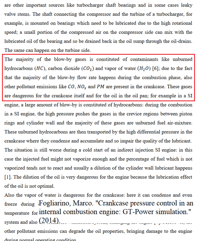

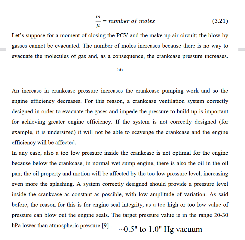

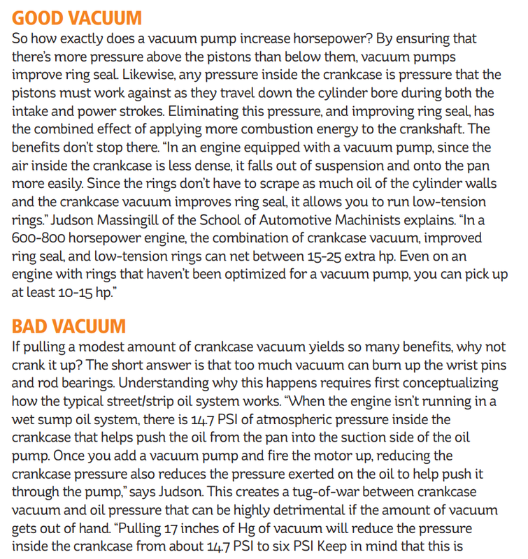

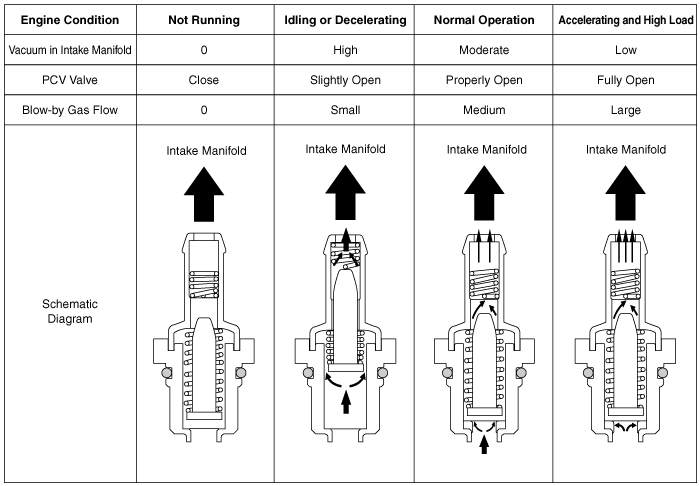

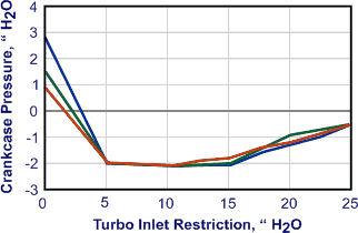

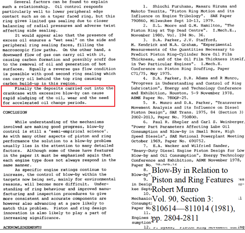

Ohhh we wana talk about crankcase evacuation
My favorite topic. Please review the following work I've done in this regard, and it shall serve all any combustion engines applications.
Every engine has blow by so every engine has PCV flow. If pressure rises above atmospheric there is a slew of issues ranging from oil contamination to partial pressure of dissolved gasses to the density of gas flowing through the pcv system carries more oil. Crankcase pressure must be set by the engine owner per specific application to maintain 0.5" to 1" Hg at all times.
Dangerous crankcase gas
Partial pressure of dissolved gas, dynamic equilibrium from chemistry textbook applies to all liquid-air interfaces
Blowby gas influence on ring function
PCV valve blows oil out to the intake manifold in natural aspiration when crankcase pressure rises
A vacuum pump article statement regarding influence of gas density
Proper crankcase suction due to filter restriction is a measurable quantity
Published paper PCV crankcase pressure target 0.5" to 1" Hg for OEM engines
Threads where I cover these items in sometimes excruciating detail
https://www.supraforums.com/threads/.../post-13980010
https://www.thirdgen.org/forums/powe...ml#post6462919
https://www.theturboforums.com/threa.../#post-2050290
https://www.corvetteforum.com/forums...post1604427919
https://www.corvetteforum.com/forums...post1604386206
crankcase pressure situations with dry sump
https://www.corvetteforum.com/forums...post1601048750
http://www.turbosport.co.uk/showthre...=1#post3147205
Crankcase pressure, oil leaking
Electric vacuum pump , importance of crankcase pressure practical application for oil control
https://www.evolutionm.net/forums/ev...l#post11930508
I decided the short the Hobbs switch to check out the vacuum with the air pump turned on. To my surprise it wasn't turning on. Upon inspecting the 15amp fuse it had blown so it was not working when under boost. This might explain why I had oil pushing past the rear main seal. I swapped in a 20amp fuse and it works like it should and pulls ~5" at idle. Because I monitor the pressure with my AeroForce Gauge it allows me to set a warning light. I now have the warning light come on anytime the PCV presssure exceeds 0psi.
notice it applies to all engine crankcase systems. Symptoms take time to develop. A major warning sign in Natural aspiration apps is pcv valve orifice flowing oil, which can only happen if the engine crankcase pressure at WOT is going higher than intake manifold pressure. Leading to people blaming the pcv system and baffle system when it was the air filter preventing WOT pressure drop on the crankcase which causes PCV valve to flow oil.
As to water, combustion creates water, so the engine oil inside crankcase is constantly exposed to water. By maintaining a crankcase evacuation system with pressure drop signal (partial pressure of water leaving as a gas state influenced by crankcase pressure, see dynamic equilibrium above from textbook), and making sure that oil can reach near the boiling point of water, it will ensure most of the water is evacuated by the PCV system. Water should not be allowed to collect in any portion of a pcv system, such as catch can stagnant reservoir, because water participate innumerable chemical reactions in the presence of heat cycling, carbon conglomerates, and atmospheric contents cycling through a pcv system.

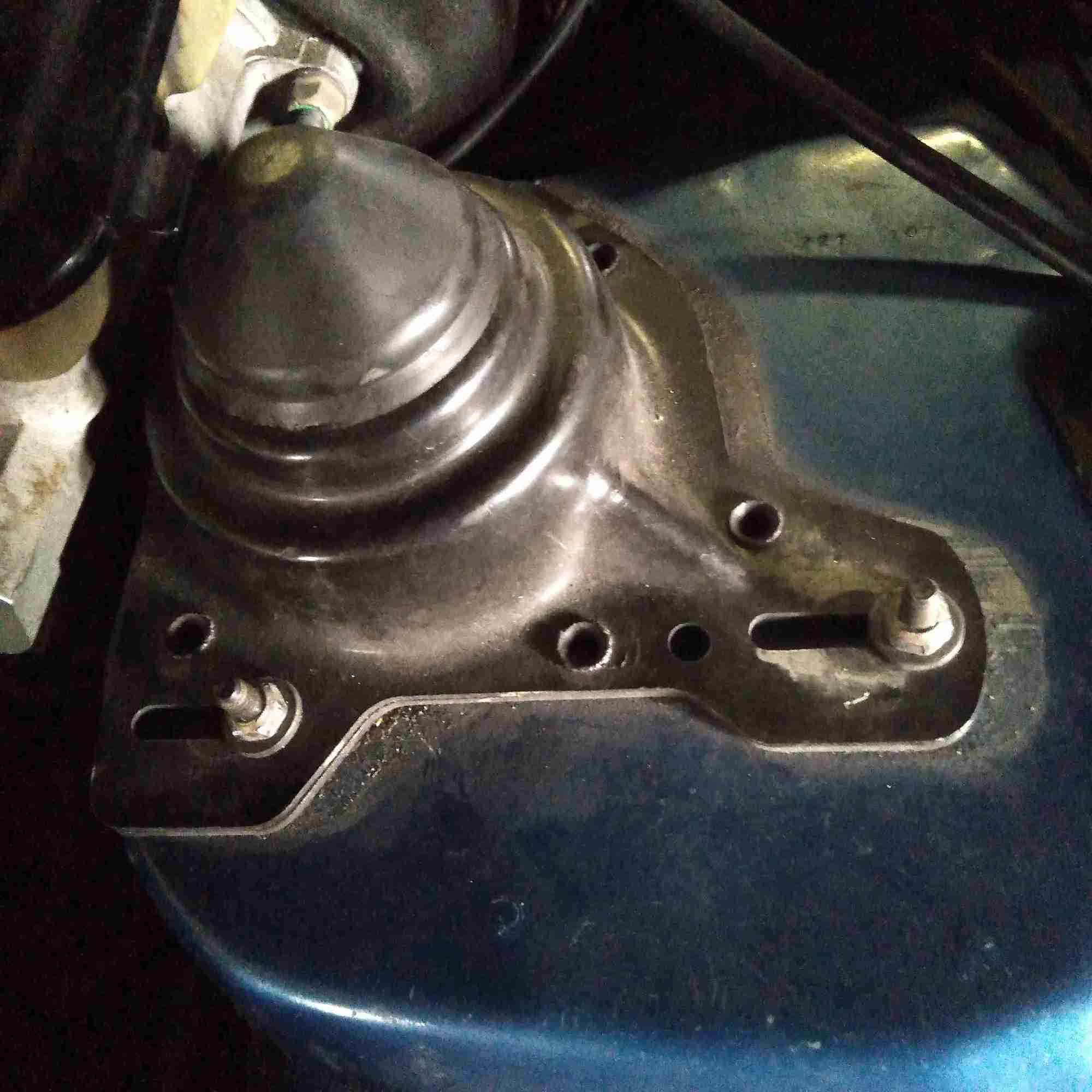

I'm satisfied with the way the fans are working. I held a thermometer up to the air vent with a/c on. It got to 44 degrees. Maybe would have went colder if I held it there longer. I'm happy.
When I got the car it had lowering springs in it. I put new replacement springs on the front with new struts, brake hoses & caliper kits. Used OE springs on the back. Tires balanced. Alignment this afternoon.
I have the trans fluid/filter & rear end oil. Will change soon & see what I have for a rear end/posi.

The front end sits almost 2" higher with the new springs. The back about 1.5". I don't like low riders.
I changed the gear oil in the rear end. I have an open differential. Explains the one wheel peel. The carrier has some gouges from the pinion gear. It looks like the pinion came lose and came in contact with the carrier. It appears to be fixed. Just the scares left behind.
I will be changing to posi at some point. Maybe this winter.
I changed the transmission fluid twice. It needed a rinsing. The PO must have used a half a tube of RTV on the gasket.

I got it aligned Thru. What a difference. It looks like the top of struts are moved inward about as far as it will go. Both sides the same. It's in spec and handles well.

Wow, it looks great!! Worth the effort!!!!
