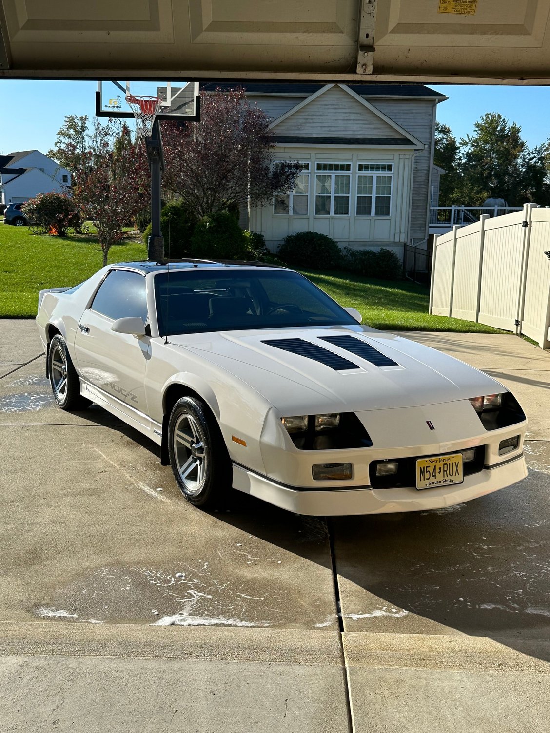

Hello all new to the platform. I have a 1986 IROC Z28
the cooling fan does not turn on. I replaced the fuse and the relay.
