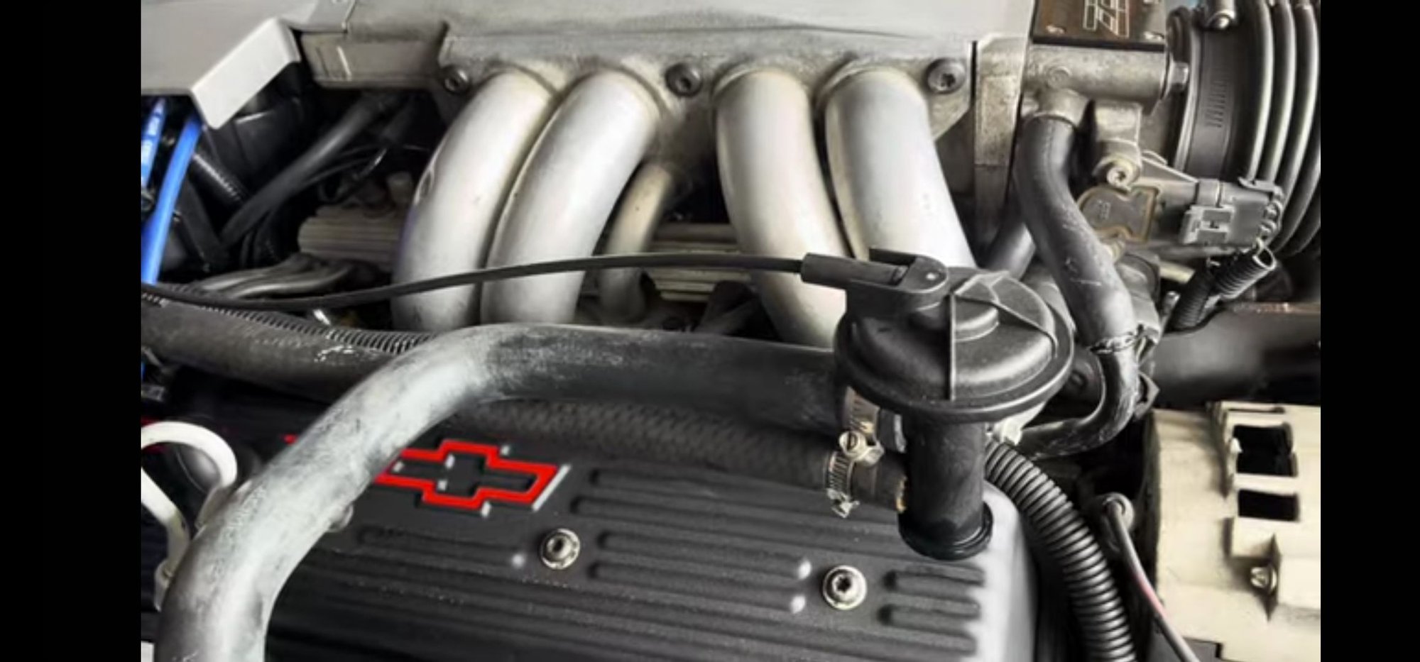

Cut into existing vacline for the interior circulation.

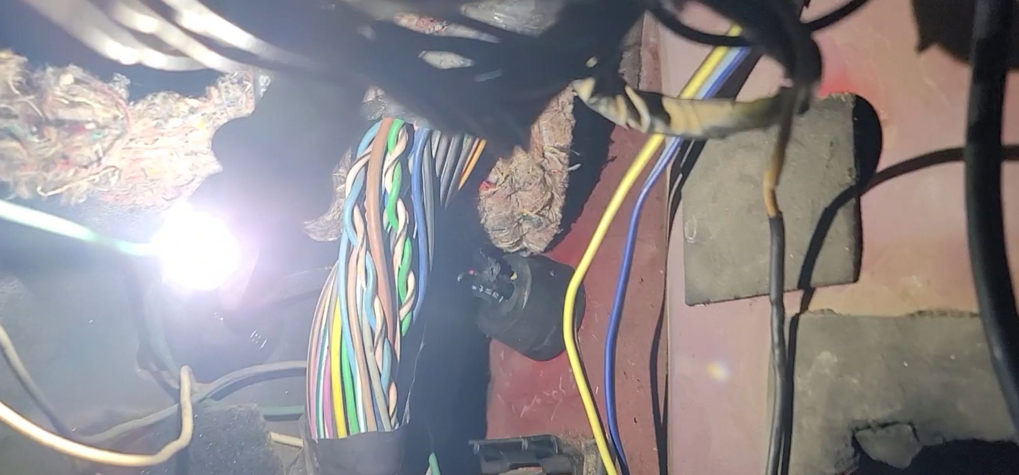

Vacline heading into fender area using the existing antenna cable grommet.

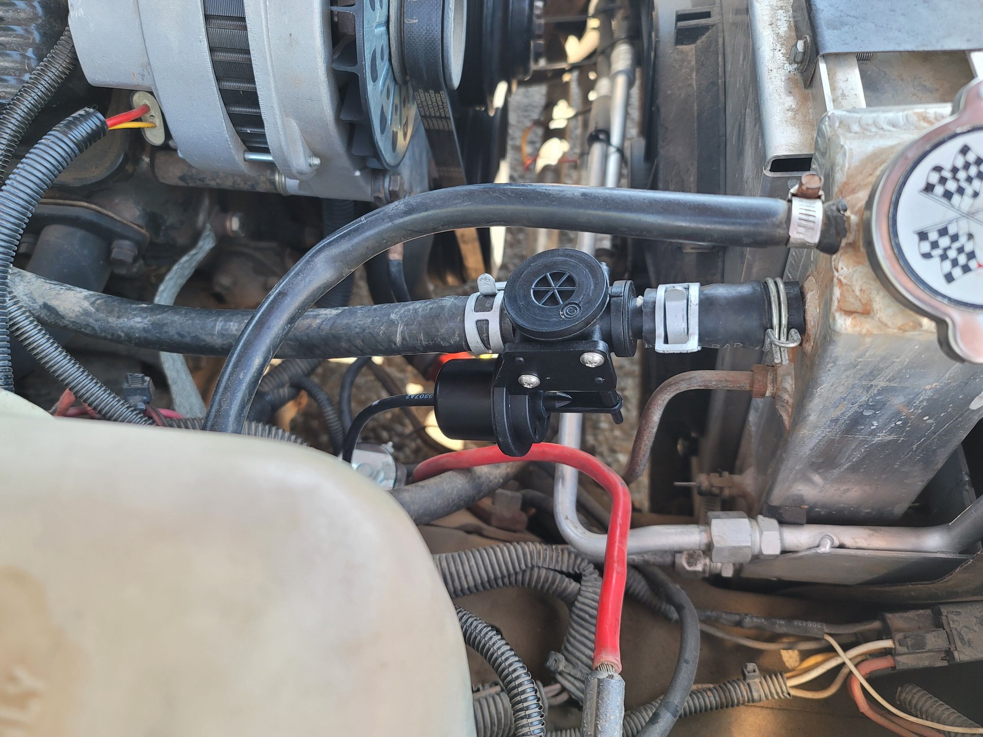

Ford valve.
Ford valve.

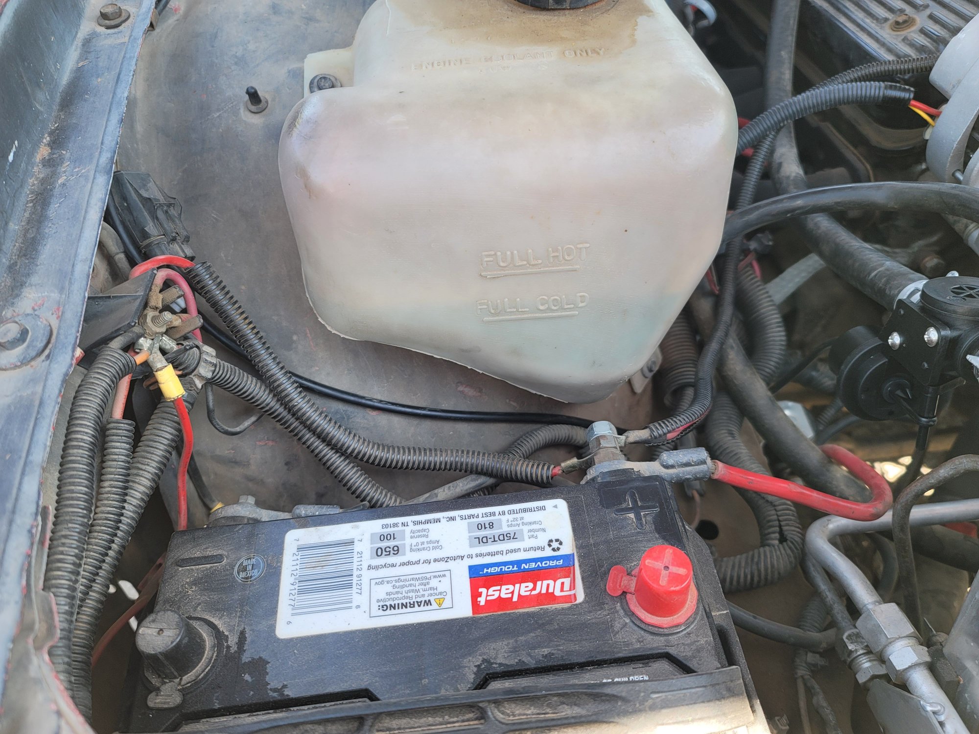

Install completed.

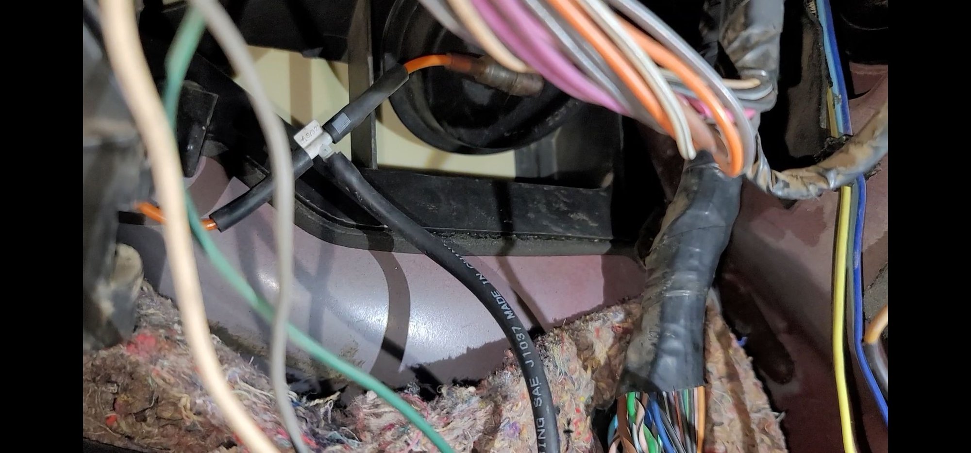

Rounting of vacline.
