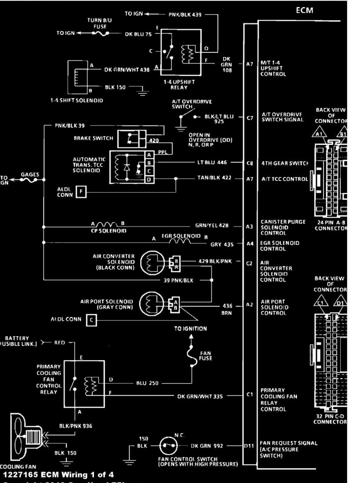

I have a 1987 trans am GTA with the 5.7, my radiator fan fuse keeps blowing, but only when I start the engine. If I just turn on accessories the fan comes on normally. I’ve been reading some other posts but none are really helping me figure out why it’s only blowing then. I’ve (hopefully) checked every wire to the fans and I don’t see any issues, could it be a switch somewhere that I’m not aware of or something deeper?

Could be many factors, bad ecm, stuck relay, a/c commanded on or wrong ac pressure switch. What all have you tested ?

I would start with unplugging the a/c pressure switch , if no change then pull the relay and test the green/white wire. If that’s fine toss in a new relay. The blowing fuse is a short or to much amp draw. Can’t help you being short on time. Take it to a shop I guess
