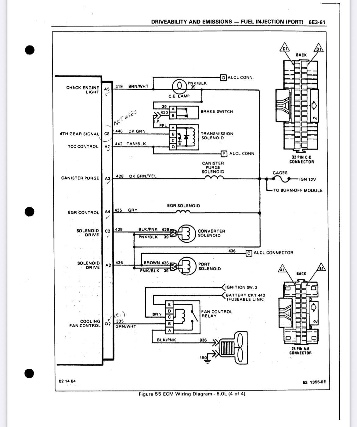

Re: 1985 Z28 305 TPI Fan wont start.
On your 85 tpi, Key on jumper the aldl a to b the green/white wire should activate the relay. Fan kicks off at 35mph unless commanded on. I didn’t see if your air dam is still intact ?
Posts: 16,901
Likes: 1,014
As you can see the ecm grounds the green/white. It uses the cts in the front of the intake to read coolant temp. At 106.3 c the fan gets enabled through the ecm that’s a stock setting in the prom .

@Tuned Performance Yes the air dam is still there. I was about to get rid of it until i read what its there for. Thanks for the help and Diagram.

I think im a little closer to a solution.
Someone (probably the pre owner of the car) disassembled the (ABCDE) plug that connects to the relay and put in the wires wrong.
The brown wire was in the D Position (where the Relay has no terminal). I undid this and when i ground the green wire the fan does its fan thing.
Now i have to do a little driving around town to check if the switch works.
