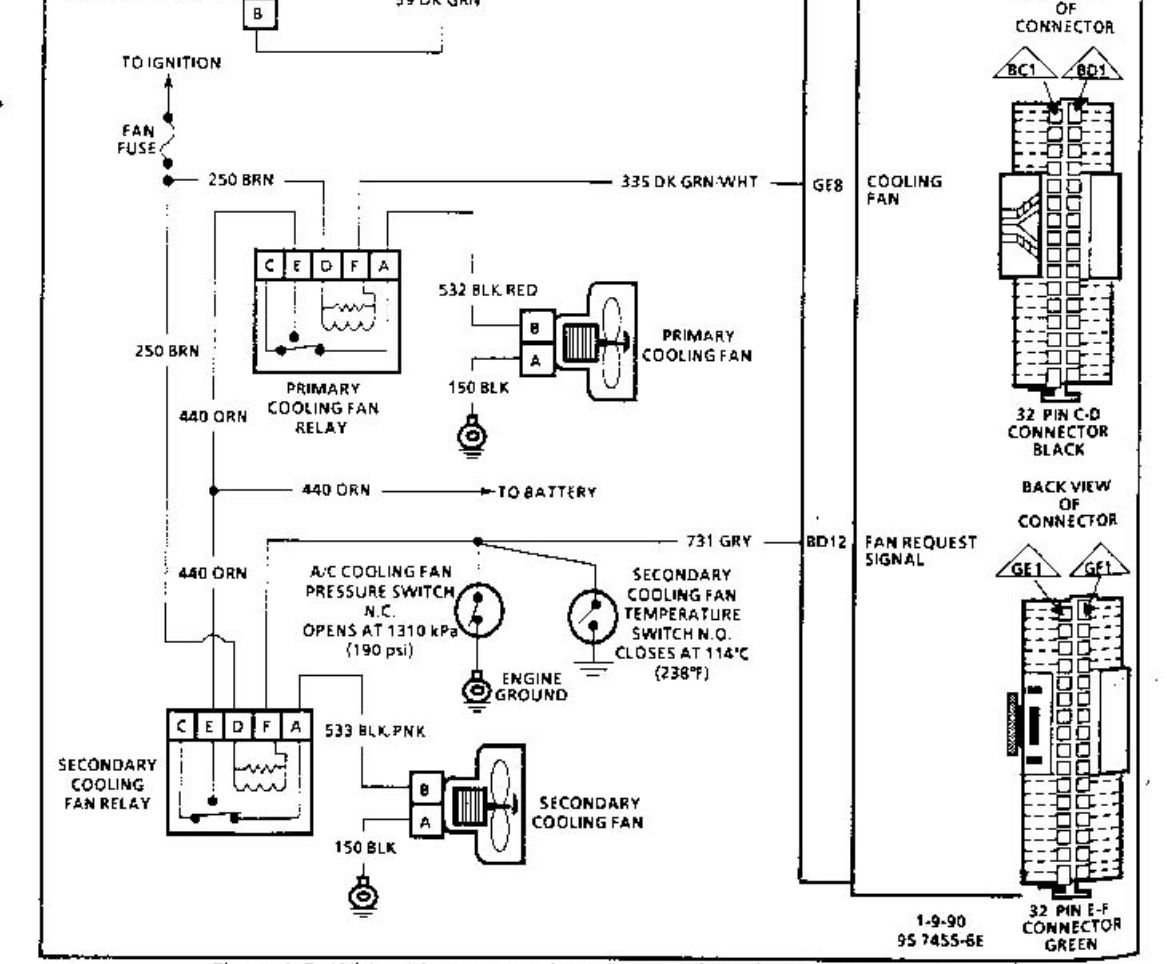

Here’s a schematic I think it’s the same for 3.1 and tpi. Can jumper the aldl then test the green/white relay wire

I'll have to test that tomorrow afternoon, I've got some life stuff that I now have to go deal with haha. Thank you for the schematic, I'll see what happens tomorrow

If your radiator has only one cooling fan similar to my 1986 2.8L ,your schematic may look like this.
The fan pressure switch is only present if you have an air conditioned car.
