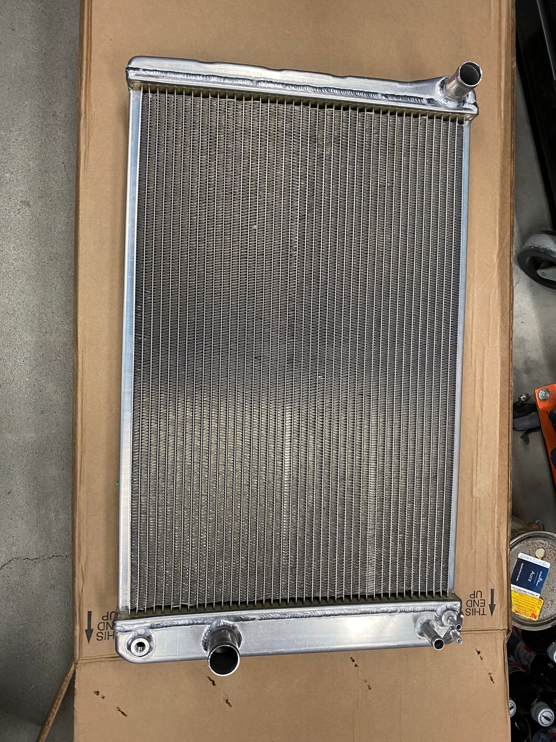

what radiator do you have?
went through 3 autozone radiators every one blew the drain plug out, anything i can do to fix it? also this time it blew out oil pressure fluctuates a lot easier, should i be worried? crate motor 350 with 1500 miles on it. oil on dip stick looked normal

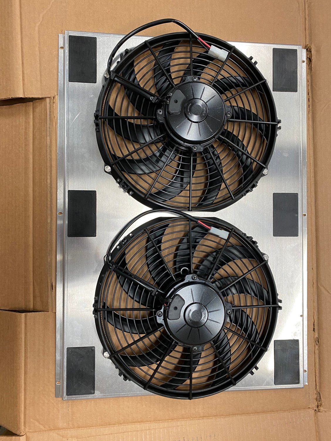

Griffin MegaCool combined with dual 12” Spal fans

Have you ever pressure tested your cooling system? they also have radiator caps with pressure gauges on them so you can check. I personally am running a Be Cool Radiator with dual spal fans.

Ive had champion, griffin, afco and cheap *** ebay special ones. Never had one blow out. Definatly check your pressures.
