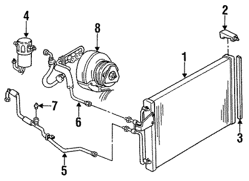

I’ve got a 1991 Camaro RS. Just finished up A/C overhaul. High side pressure line for the a/c snapped off the end where it connects to the condenser. Anywhere to find this line? I’ve looked all over with no luck.

I’ve got that one, it’s the hard line that runs down the frame on the right side down to the condenser. Number 5 on this schematic. Apparently it’s a real pain to find. Anyone got one by chance?

Maybe a salvage yard.

You may have better luck making a new line from soft hose components
#8 fitting to #6 hose 90* near the box for the orificetube
Metric pressure port tee for the fan switch
#6 hose end for the condenser
Basic #6 hose, standard or RB whichever your fittings match
Those small hardlines are getting scarce as more and more break

I believe classic auto air used to make it,.. but i heard it was discontinued.
it looks like only the older unit is available which you can use but you'd need the older evaporator.
82-88 Camaro/Firebird A/C Liquid Line | Classic Auto Air
The best you can do for the 89 up line would be to get a used unit.
