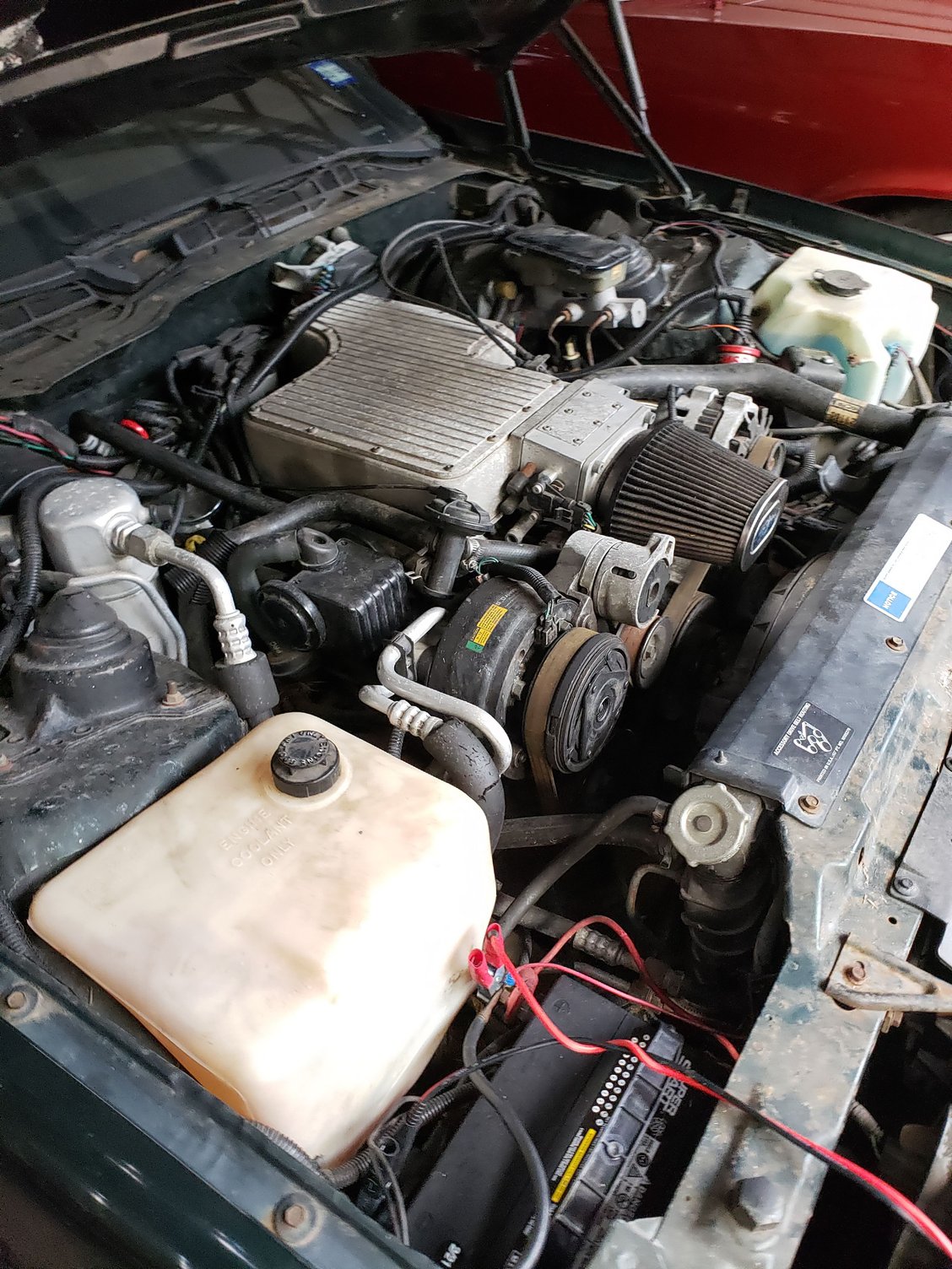

Posts: 5
Re: 92 camaro, no injector pulse
If your using a stock 96 ecm better to get a hz modulator from eBay or have the ecm flashed no chips to remove in that ecm.
https://www.ebay.com/itm/GM-VATS-or-...EAAOSwXQpeq1fC
It is that ecm ,,do u think that could be the problem
Lmao, yes that’s the ecm it’s dos based os.
thats not a lt1
