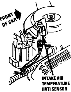

Re: Code 23? Thought I fixed it.
just for good measure, here is a diagram of where the IAT is located.
