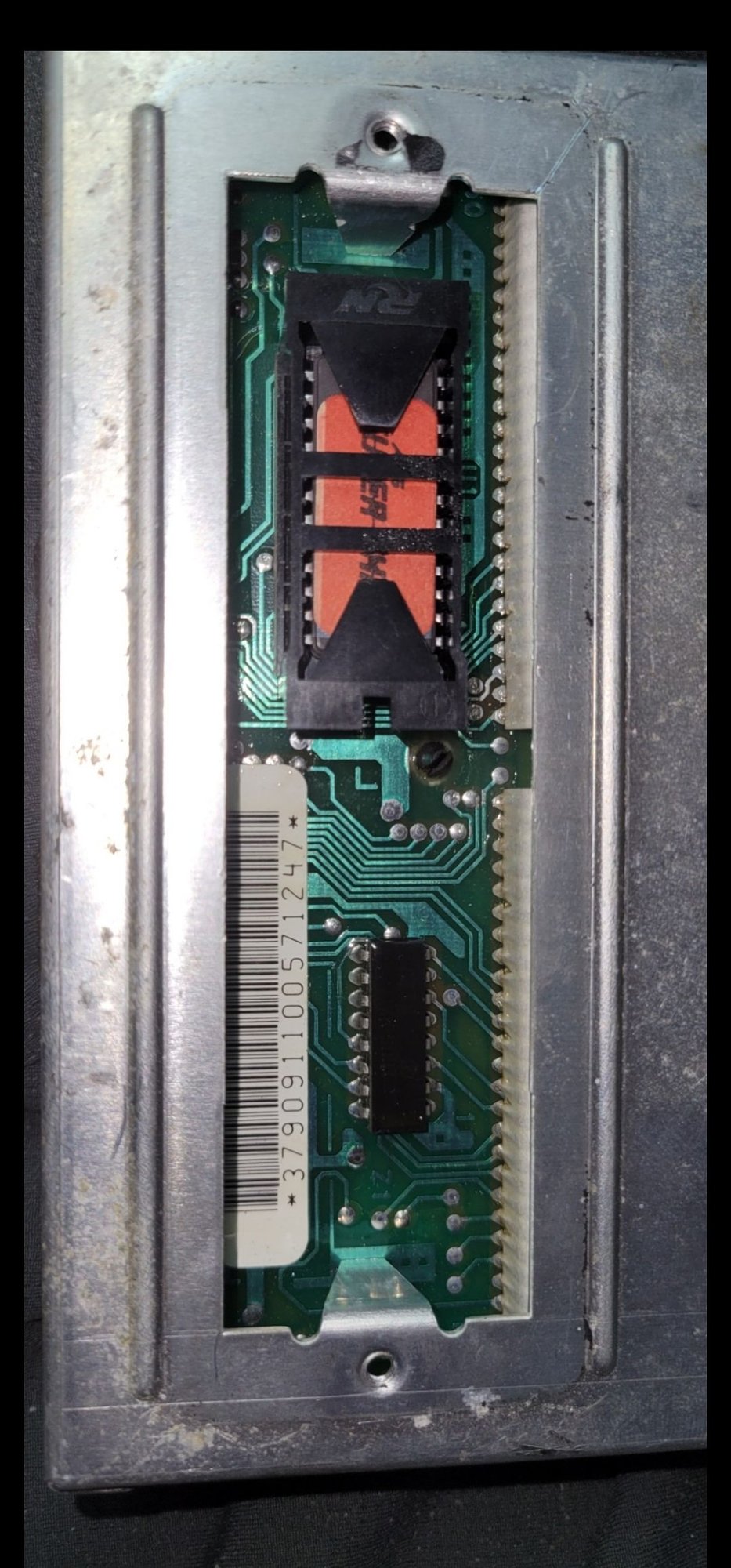

Okay. My english is not that good, but i will try to explain further the situation.
My Trans Am started to have problem a few while ago. Engine shutting down every corner and check Engine light up, then off, etc. Went to the garage. We try to get RPO codes but it was a failure because the check engine was always blinking, flashing like, and getting the RPO code was not possible. Then, my repairman just gave a gentle hit on the gloves compartiment (well under of it), and the tcheck engine stopped to blink.
We try 4 Different ECM. 3 used, 1 refurbished. All had the same problem.
Then he did try on my 1989 Trans Am old ECM, a used memcal from one of his friends 1988 Camaro.
I was not there, but he told me all my problems were solved instantly.
Old Jun 26, 2012 | 11:59 AM
This a sign that the PROM is bad. The ECM was in limp mode which is why you couldn't pull codes.
Note that the codes are referred to as DTC's, Diagnostic Trouble Codes. RPO codes are Regular Production Order, and are found on the underside of the console lid or the glove-box lid. They list what equipment & options the car has.
See if you can find another MEMCAL in the classifieds here, and/or PM utilityguy2.
RBob.

Okay, i'm back from the garage. My repairman took some metalwires and got them between the PROM and the MEMCAL itself. Then, my car started like a charm!
Now, he wants to just (braze, weld; not sure about the right word) those wires between prom and metcal) as some temporary solution.
BTW, now i'm 100% sure about what i need.
EPROM 3506APYR. For my ECM # 1227165.

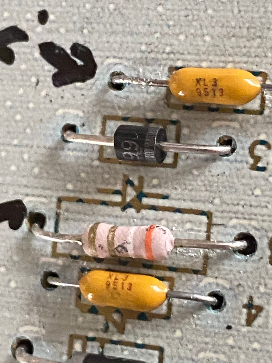

I know this is a old thread and this is a Longshot but I have a 1992 camaro rs 5 speed that I swapped a 5.7 tbi in from a 1990 gmc v1500. According to my research they made a 1990 v3500 5.7tbi in a 5 speed manual. I orderd that eprom. Will it be compatible with my camaro ecu or do I have to buy and wire in a v3500 ecu?

Not the correct mask for the ecm. What’s the broadcast code letters on the chip ?

Old May 30, 2022 | 10:38 PM
Drew1857's Avatar
Joined: May 2022
Posts: 6
Re: EPROM for beginners.
My camaro has a aftermarket chip in it, and I orderd a jet performance chip that is for the v3500. Here is a pic of my existing chip if it helps.
Old May 30, 2022 | 10:45 PM
Drew1857's Avatar
Joined: May 2022
Posts: 6
My camaro has a aftermarket chip in it so idk the numbers, and I orderd a jet performance chip that is for the v3500. Here is a pic of my existing chip if it helps. Just need to know if it will work.
Old May 30, 2022 | 10:46 PM
Tuned Performance's Avatar
Community Influencer
iTrader: (95)
Posts: 16,906
Likes: 1,014
From: Mile High Country !!!
Car: 1967 Camaro, 91 z28
Engine: Lb9
Transmission: M20
The chip for the 90 v3500 should be used in
a 1227747 make sure your using a v8 calpak as well might find a used ecm and calpak on eBay
https://www.rockauto.com/en/catalog/...computer),2896
Old May 30, 2022 | 10:51 PM
Drew1857's Avatar
Joined: May 2022
Posts: 6
So once i get the chip in the mail i should check the part number on my ecu to verify it is the same as the one you provided before plugging In the eprom. And if it isn't i need to order the correct one? Is the part number on the ecu itself? And what is a calpack?
Old May 30, 2022 | 10:54 PM
iTrader: (95)
Posts: 16,906
Likes: 1,014
Engine: Lb9
Transmission: M20
The calpak is not used in your 1228746 ecm it sets fire rate of injectors v6 or v8.
Old May 30, 2022 | 11:00 PM
Drew1857's Avatar
Joined: May 2022
Posts: 6
so the sticker on my ecu is shot. With no way to verify the part number im stuck and i dont want to throw a new ecu at it un nessacarly. If I just plug in the chip I get will it blow something up or does it just have a chance at working or not working.
Old May 30, 2022 | 11:11 PM
iTrader: (95)
Posts: 16,906
Likes: 1,014
Engine: Lb9
Transmission: M20
If your not sure I answered your question call jets ask them if $42 mask

HELP
Need help with the electronics on a 96 Firebird cluster.
I’m new here and need some help and guidance.
Speedo when traveling at say 60 MPH registers over 100MPH.
Odometer is dead on when checking it against GPS and Mile markers.
VSS has been confirmed as good and since the signal from the PCM is shared with the speedo and odometer I suspect there is a resistor or capacitor failure in the cluster circuit.
I am a mechanic but by no means am I an electronic GURU like RBob etc.
Could someone please lead me in the right direction in order to make the cluster repair myself?
I do know how to solder and read a digital meter as needed.
I have not been able to find a cluster schematic anywhere.
I’m attempting to do this car on the cheap for my granddaughter, so buying a $100 cluster or sending it off for an expensive repair is not an option.
Thanks for any help that can be provided.
