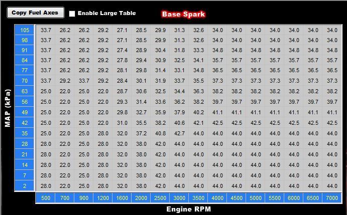

Post your combo and timing table

I dont know what the combo table is, but here is the spark table.

Combo i mean motor details. Cam specs compression heads intake stuff
Timing looks ok. Some of the mid lower map cruise areas under 2000 rpm could take abit more timing but its not a deal breaker
