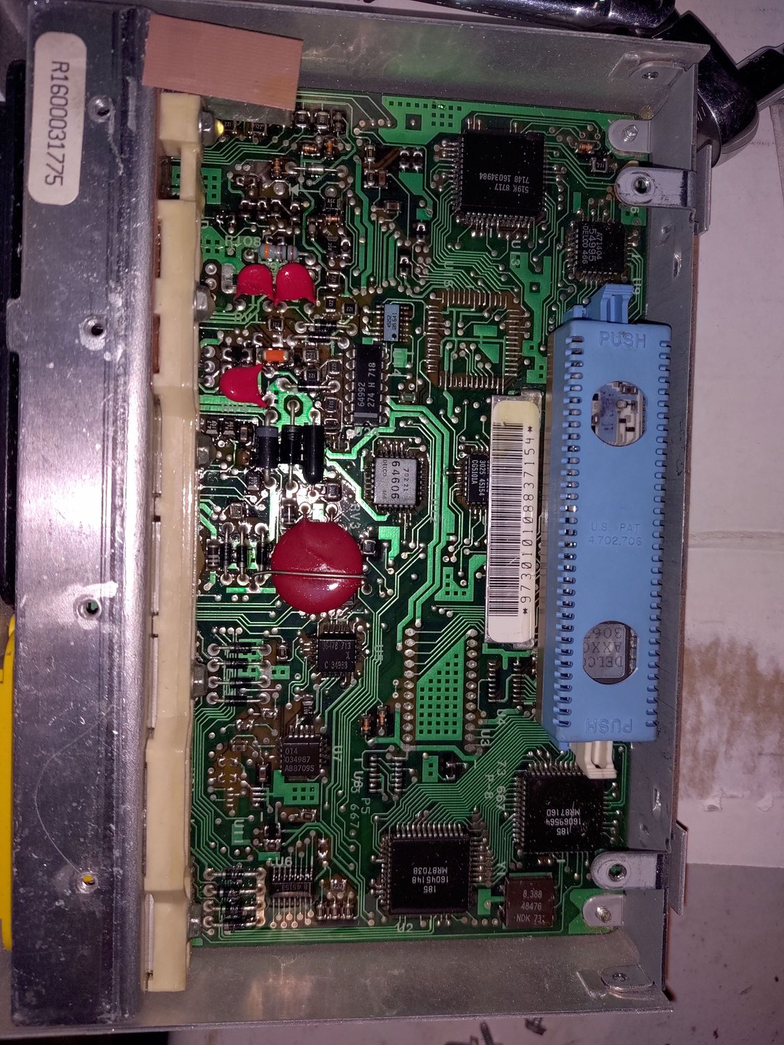

Hello friends. I have a 92 Camaro Z28, 305 TPI Manual trans. Bought a 01227730 ECM with a (EBL P4) tuner installed. I thought this was the ECM all 90-92 TPI used, but when I pulled the one out of my car it says it is a 16198262. Also has a number inside the case R1600031775. When I search them numbers I get 0 hits. Anyone know if it is normal to have this ECM? Just curious what I have been running, and whether the ($D8) is still a good bin. to start with? Thanks guys

The 16198262 service number is just a newer number for the 1227730 ECM. The stock '90 - '92 TPI ECM maskid is $8D, but you need to use a BIN that was supplied with the EBL P4 system. There are four for TPI cars.
