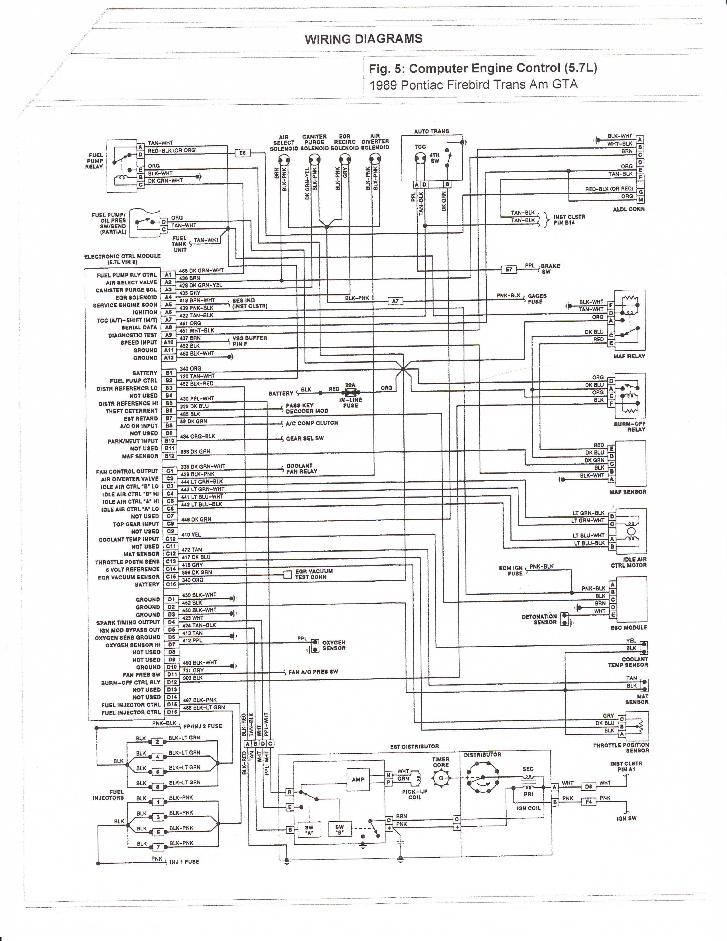

I guess this post should have been posted in the electronics forum. But I have one more question. one time my primary fan didn't turn on when I jumped the ALDL A B terminals. I checked the ground on the relay and it was reading real high around 43 ohms. After that I checked the wire by its self, and it's resistance read .3 ohms so that was fine. I'm guessing the ECM isn't grounding it right. I already looked at the ECM grounds and they turned out okay the highest I got was .5 ohms. Is there something wrong with my ECM?

A high ohm ground is more likely a corroded/dirty connection. Unplug and plug will usually help. Look for green or white powder. Use an anti-corrosion type grease.
