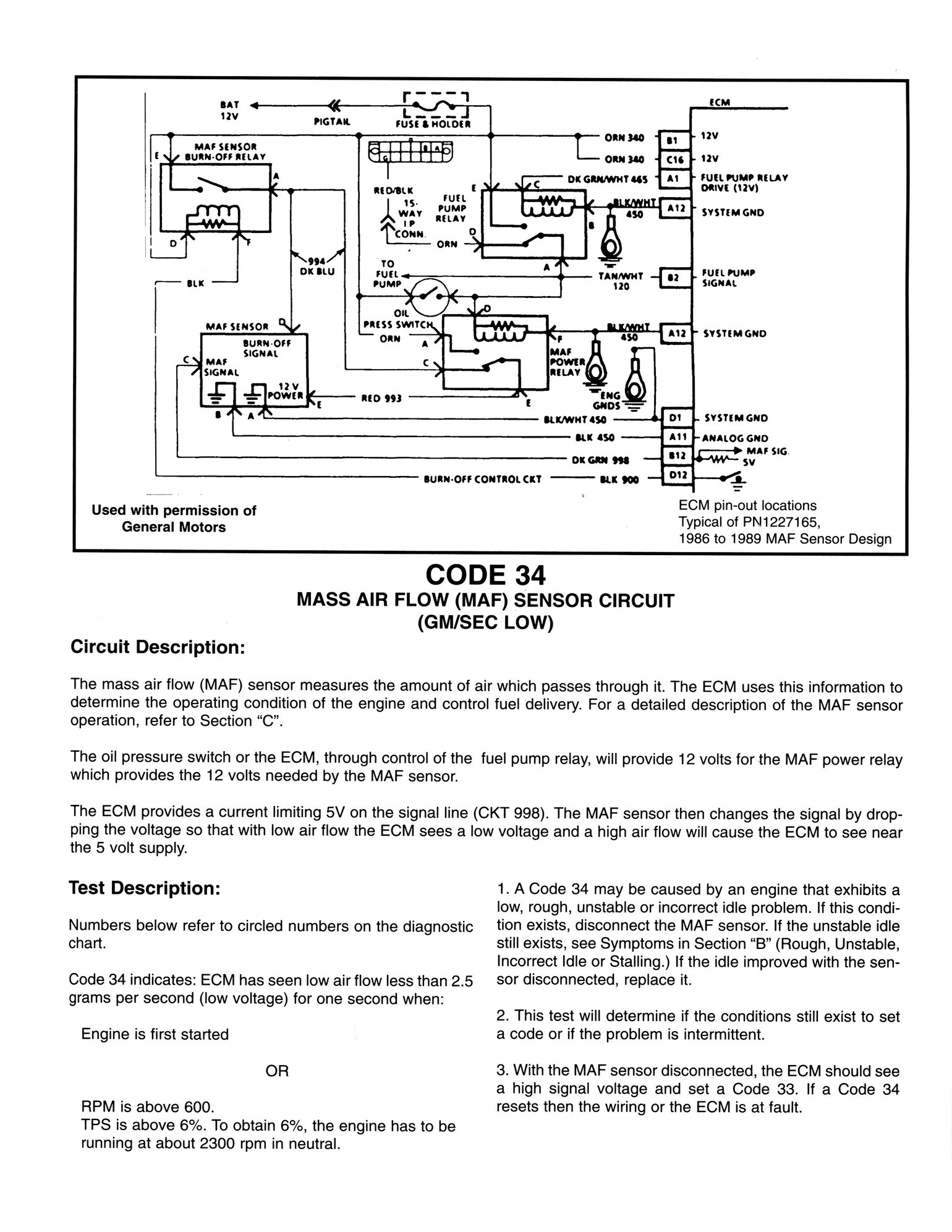

Codes are 12 and 34, brake cleaner will start car, it idles ok, once I give gas it climbed to 2800 then dies off fast Then runs bad. Fuel pressure at rail is 40.
Dad died in 2016, I’m in the Corps and just got his car home. Not a lot of time to work on it.
Just sprayed down the MAF tonight. Has new fuel filter. Bought a fuel pump and assembly, but think the pressure checks out.
It’s a 89 formula. Think dad replaced the distributor. I found some new cam sensors in his tool box and 4 injector o-rings...? I disconnected the fuel supply the other day keyed on twice then disconnected the return and did the same. And that allowed me to get it up one time, I got it to 6k rpms before it died out. Now it’s back to 2-3k rpm.

Original grey body injectors?
fresh fuel ?

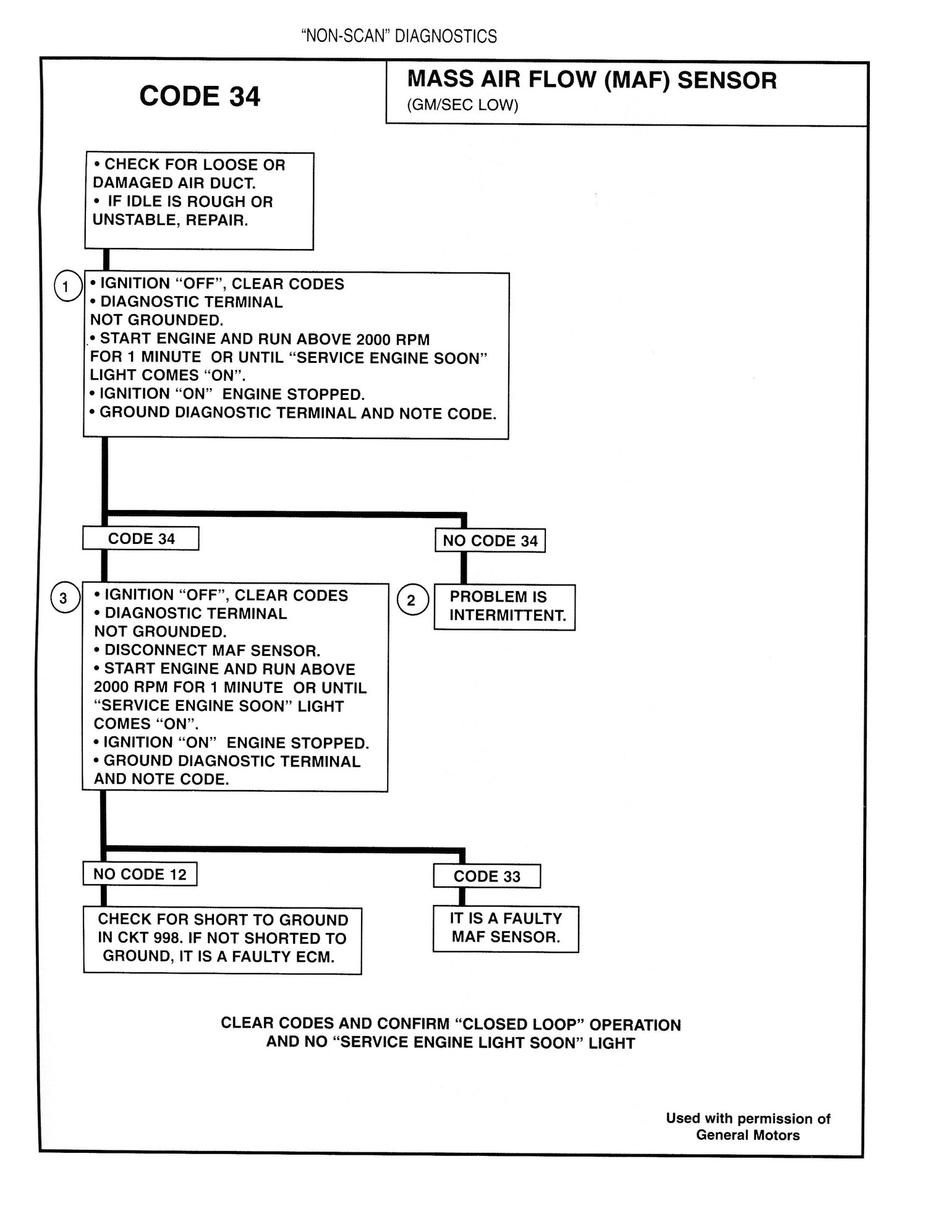

have you diagnosed the maf code 34 with a service manual?
maf cleaner used on the maf or brake cleaner?

Well verifying it with your chart. I was worried at first it might be Ecm.... but MAF disconnected it runs better. Which checks out with what you just sent. And with it disconnected I’m now going from code 34 to 33 which checks out ECM should be good! I just ordered a new MAF from auto zone think it was about 150$ be here tomorrow to see if this fixed my issues. If not I’ll check the injectors next! Thanks brother! Keep you updated. Next I was thinking about some Koni shocks I heard they are amazing. Then would like to see about getting a bit more power. Interior is great, just got new hood supports. And need a new spoiler (cracked) Hawks is a bit pricey at 479 plus 200 for shipping to Ca. Any advice on those parts, or what I should do for some more power? (Once she’s running smooth again.

There are a lot of junk mafs made for tpi . Some don’t even have a burn off wire but can be addressed with tuning out the code 36. Delphi and Used Bosch are the best .
but has to be for 86-89 , 85 tpi maf is different

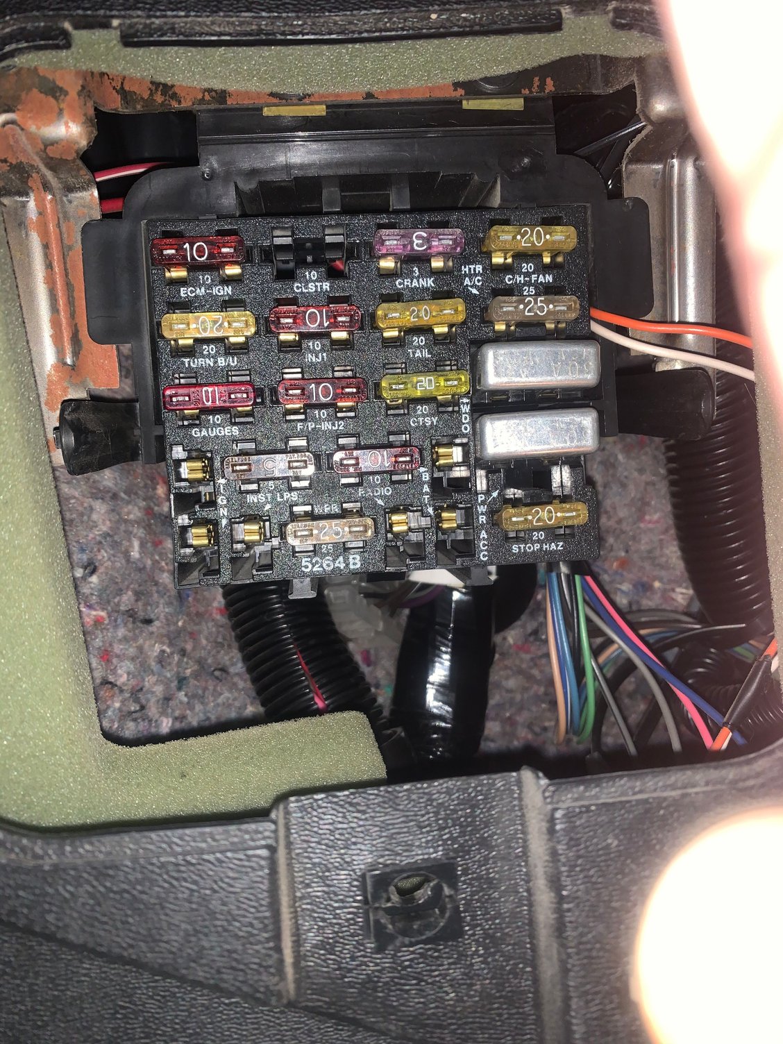

Well replaced MAF, code was still there. Disconnected battery, reconnected and code went away. Still no start, I found a fuse panel diagram that is different from the fuse box fuses. Online it calls for a 20 a on the injectors x2.... the print on fuse box says 10a, and it’s missing 10a for fuel pump, and oil pressure, electric cluster. (But fuel pump runs..?)See photos below, not sure if they are correct (diagram off YouTube) thanks!
Old Sep 1, 2020 | 09:13 PM
Fixndadscar's Avatar
Joined: Aug 2020
Posts: 27
From: California
Car: 1989 Pontiac Firebird formula 350
Re: Hard start, dies out around 3k rpm

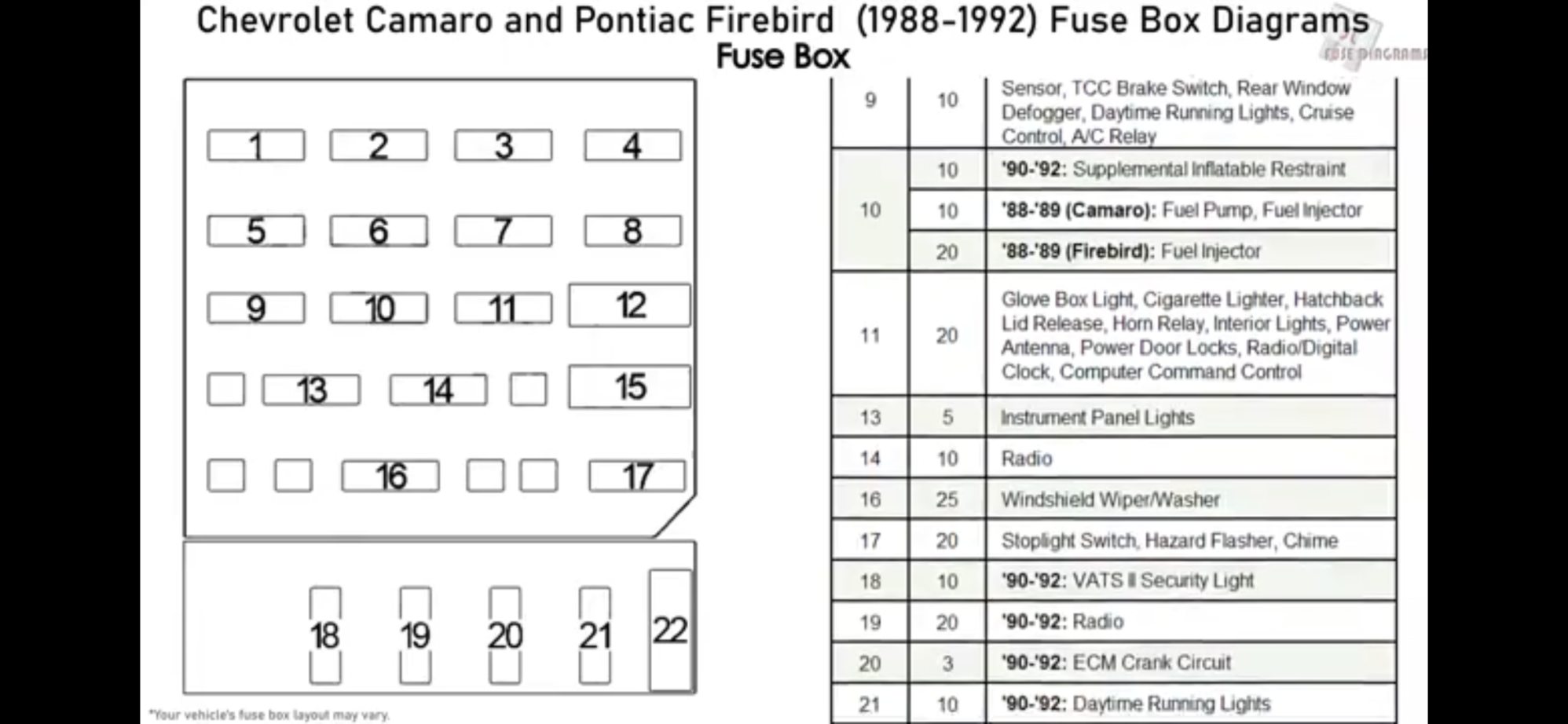

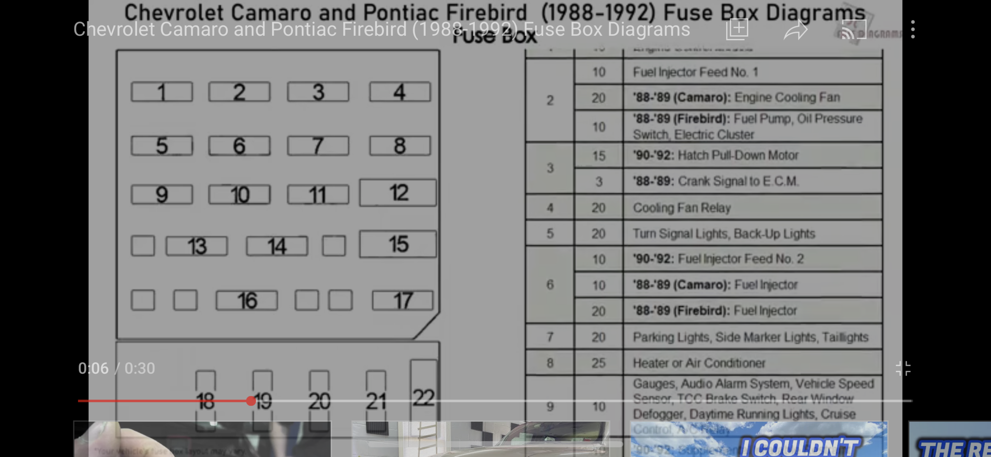

After climbing back in there to add a 10a it’s a blank in the top spot.. not sure what else todo.. now it won’t fire up even if I use brake cleaner..

With the no start, check basics. Injector pulse with a noid light, spark and fuel pressure. Also try spraying starter fluid in the vacuum line to the vacuum booster. This will be a big leak but just to see if it pops off. The injectors fuses should be 10 amp and there should be a 20 amp fuse for ecm and fuel pump next to the battery.

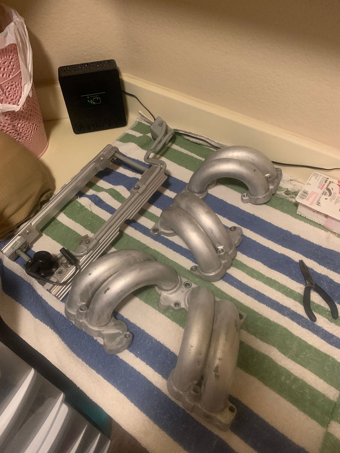

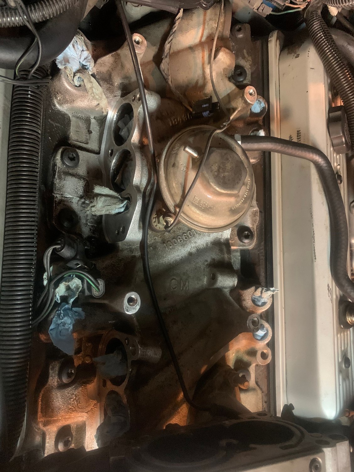

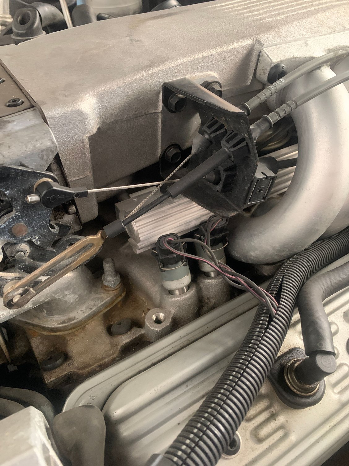

She’s alive, still struggling new injectors next. Just got to figure which ones on that site, I’ll just call them. No more service light after the MAF. Trying to upload a video but it’s not letting me... 500-700 rpm random bounce at idle, 40 psi strong. Good signs this morning!

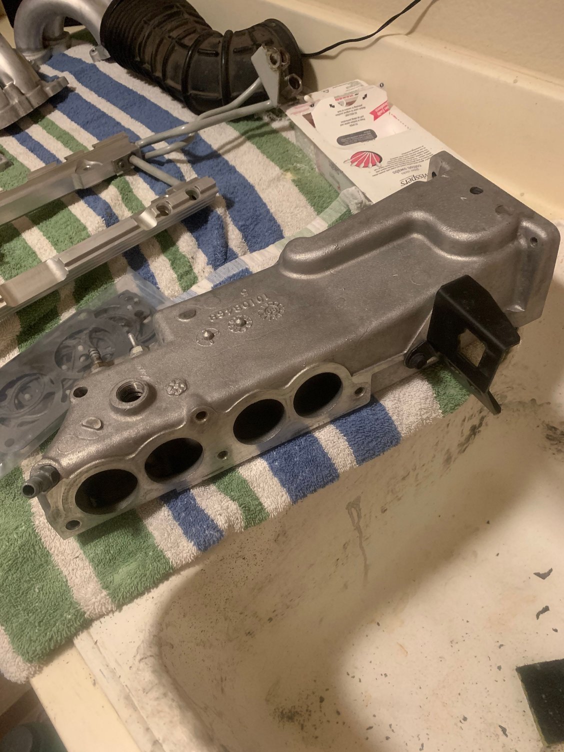

Rob, I let it sit over night, disconnected fuse for ECM. Trickle charged batteries (they dropped to 37%, it’s new, just a lot of starts) then brake cleaner to start. Drove down road about a block, tried getting on it, did not jump in RPM with gas peddle floored, died. Disconnected the number 7 injector (5ohms) brake cleaner and was able to get back.
Tuned performance, I called that company they said I need injectors with 22 lbs, part # 4447 at $165.99. But they are out of stock and won’t get more for two weeks then would still have to ship then to me here in California.

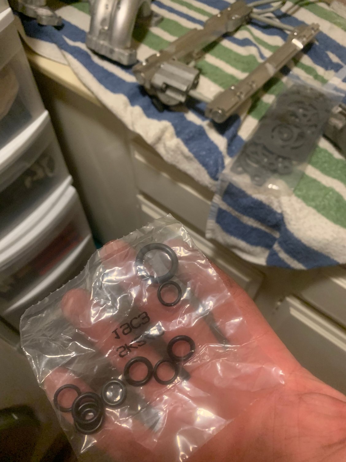

Well just hit up fuel injector connection. They offer 22 Delphi with lifetime warranty for $412... hope these are worth it. They said South Bay are rebuilt Bosch and not very good and that’s why they were so much cheaper?

Ya no idea haven’t bought from either company. Southbay was just out of stock and would take about a month. So I paid double, but will have them by Saturday... just want to get car running, then maybe look at power options.. still learning this car and who to go with.

He said that the injectors I bought are dry, that the old version had fuel run through them that these 22 Delphi are one of the best out there. Think I over paid? You guys got me wondering if I should have waited the month lol.

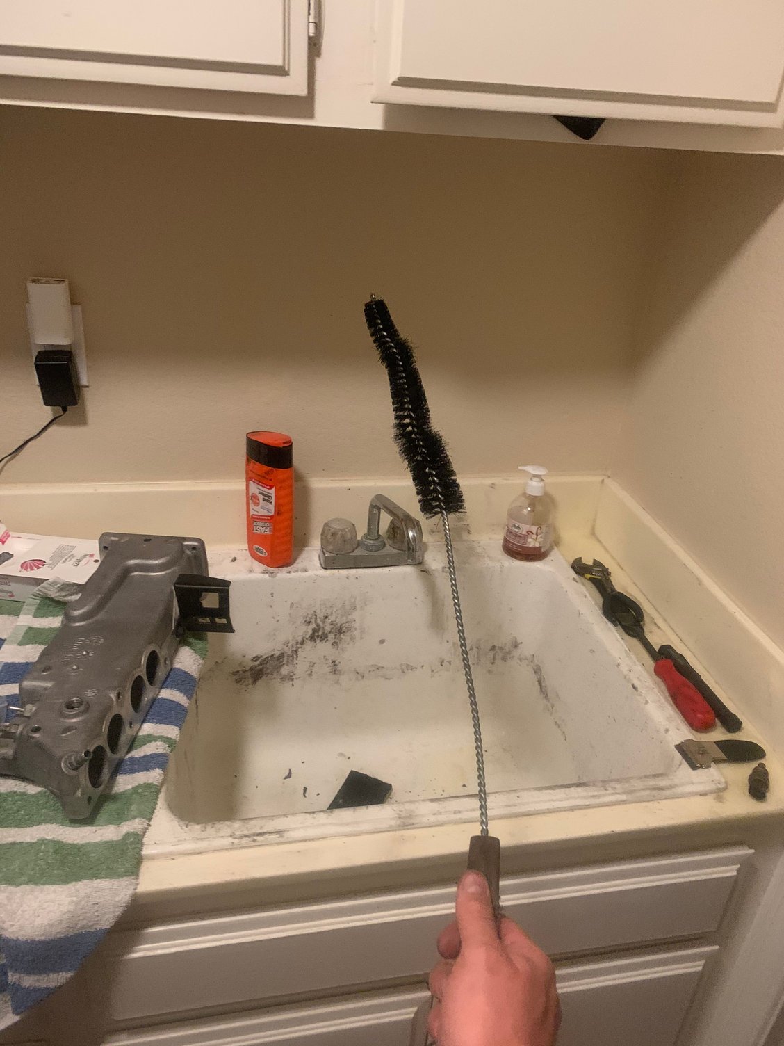

Alright gents,
dirty car, leaking gaskets Ect. Been a pain in butt with four kids and a wife haha. I have been taking my time, soaked and scrubbed plenum, runners, removed all gasket and started cleaning the top of my engine. Egr valve looks old but looks ok... any advice on if I should tear more down or replace anything while I’m this far? I’m almost ready for reassembly. Still got some more cleaning to do. (Used super clean from Autozone, it’s amazing, left a bit of a haze on runners but used the heavy duty gojo wipes)
I was also recommended that I should have went to 24 lbs injectors instead of 22..? When I ordered my injectors I received a set of orings (see photos) any idea what those are for? They are different sizes, and injectors came with some on already.
im also trying to find torque specs for the fuel rail, runners, and plenum. And gaskets do I just push tabs in and bolt, nothing needed to add to them?
then on a side note, ever done a miny ram? A guy suggested it to me. Never done one..? Also is there time frames to remove things like the charcoal canister or anything?
as always I appreciate you helping me restore my dads old car,
-Josh
Old Sep 8, 2020 | 01:15 AM
Joined: Aug 2020
Posts: 27
From: California

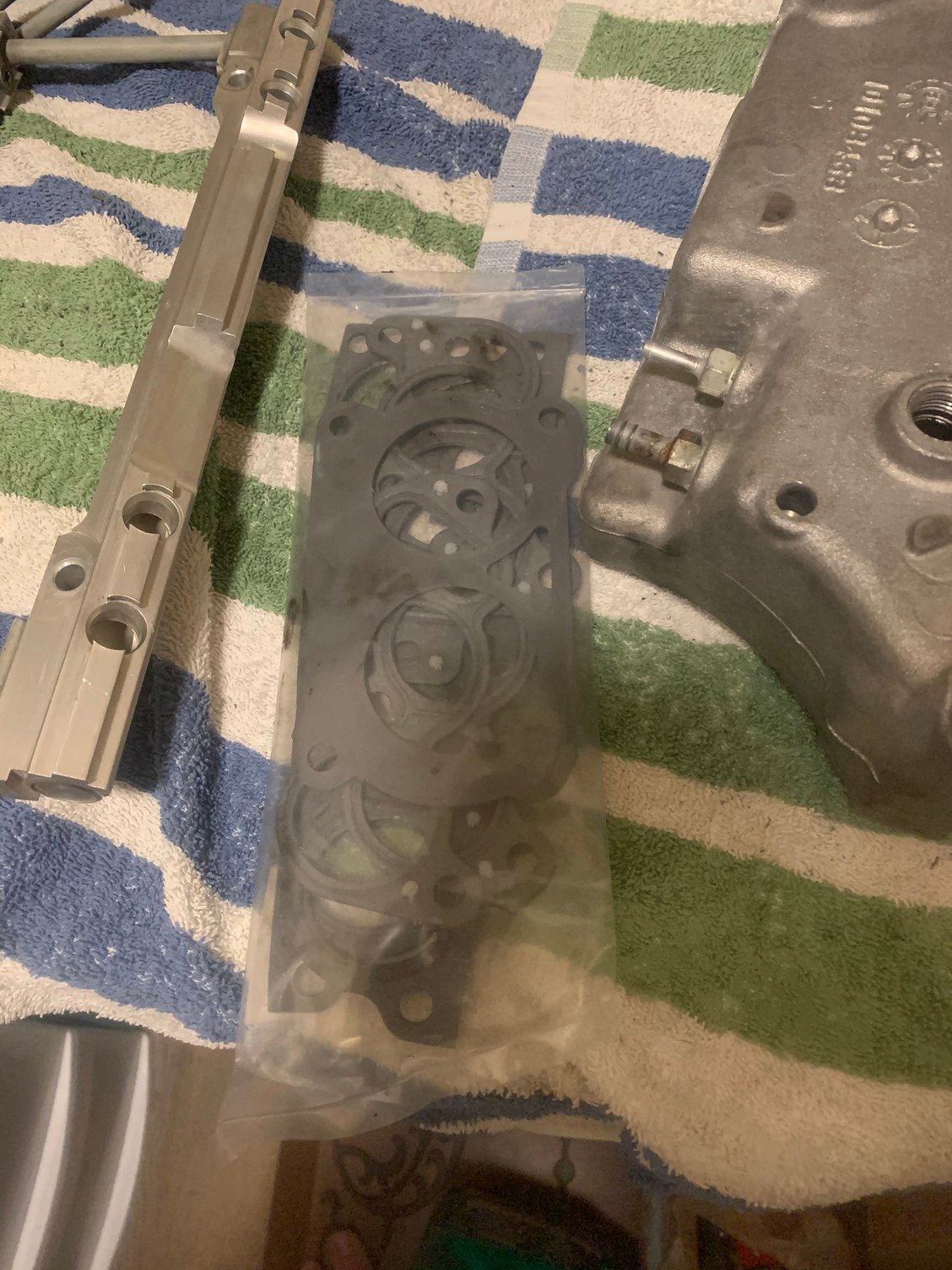

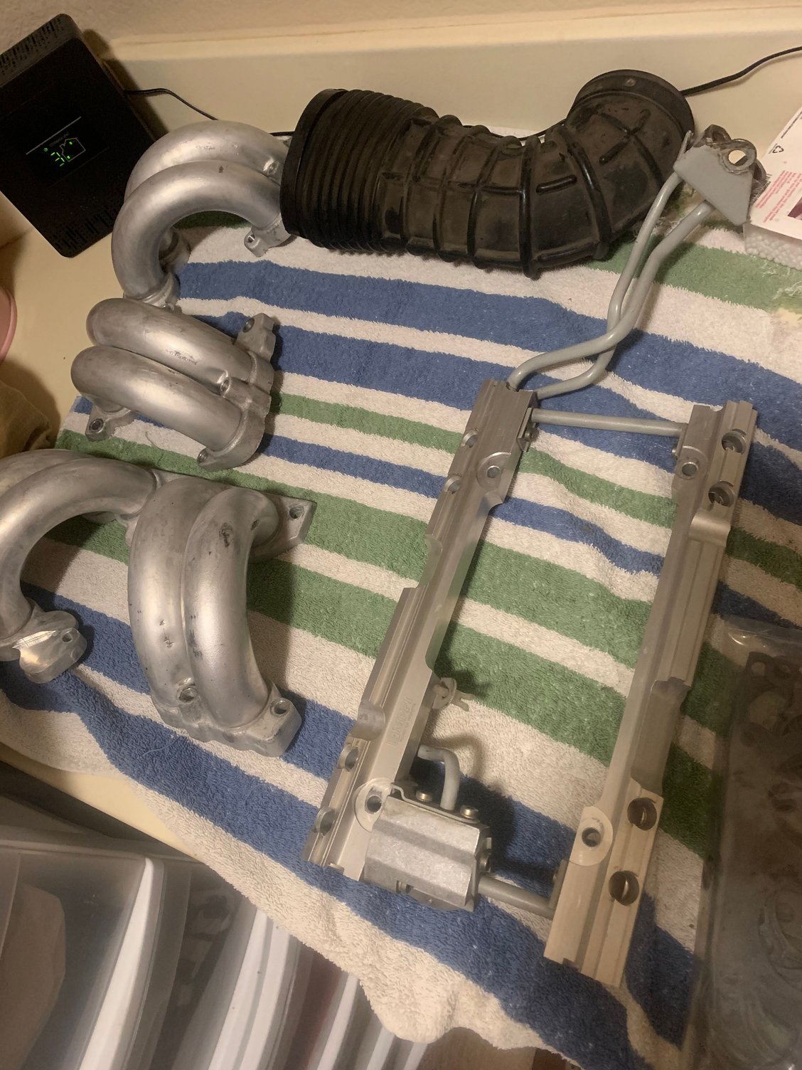

Here’s the photos:
Super strong 10-15 minutes filling runner tubes and rinse, spotless. From autozone
Little rust, replace, no issues I know of yet.
After using cleaner
Almost ready to install, just need torque specs.
Dryer duct cleaner brush from Home Depot, easy to manipulate to clean runners and plenum
What are these (standard p# SK24) all different sizes...?
Do I need to add anything to these or just tab in bolt and go?

If you search ttop350 posts you will find a relocation picture of the cop.
no need to goto 24#hrs on a stock 350 you don’t need more fuel it would just require tuning that’s not needed. If the intake gaskets not leaking might as well leave alone. The pegs hold the gaskets in place.
watch the gaskets orientation. The oval slot is not the same on each side.
i just snug down the plenum and runner bolts might be able to find a spec online maybe 11-15 ft lbs just a guess.
Old Sep 8, 2020 | 01:18 AM

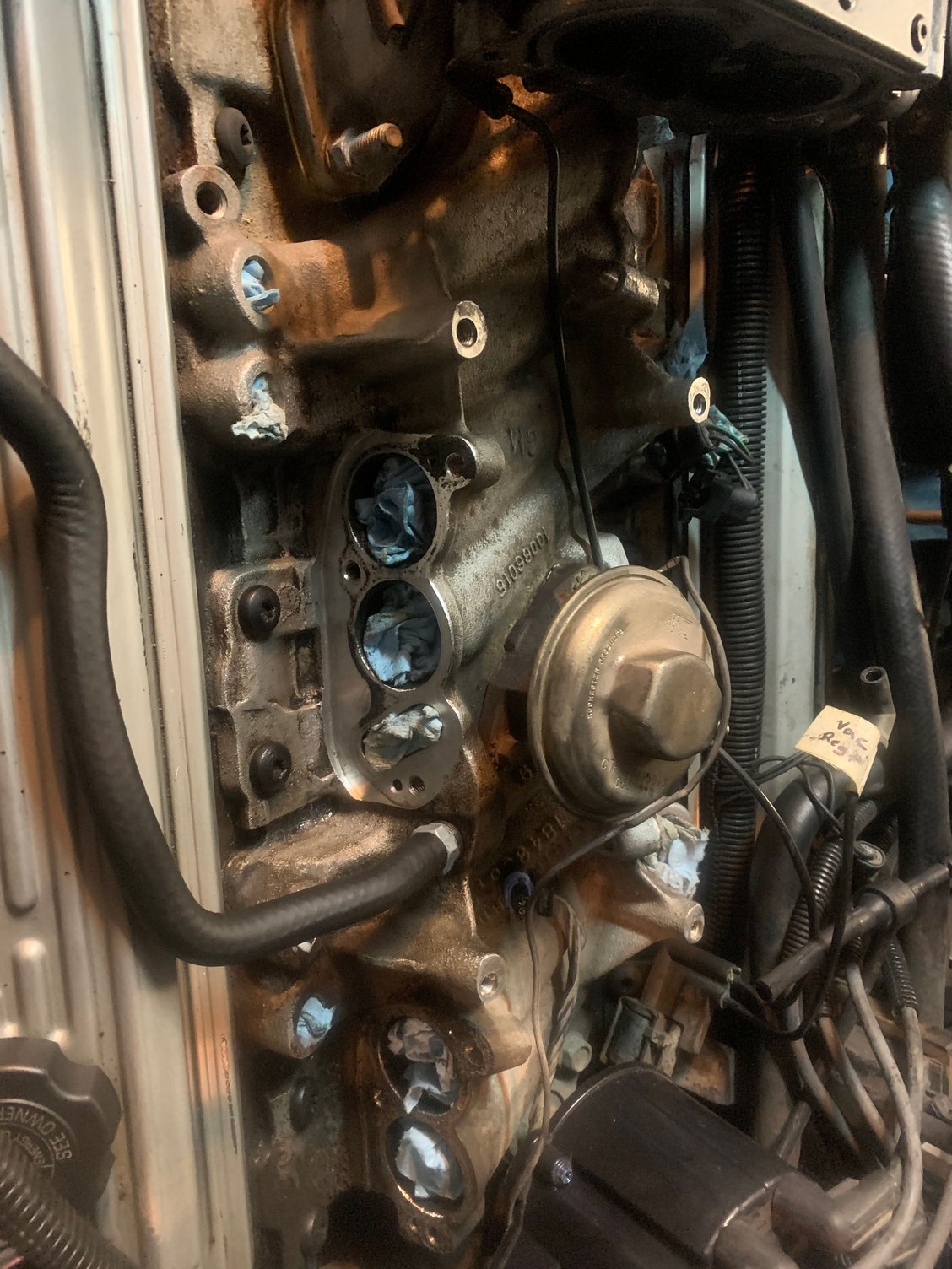

The o-rings are for the fuel rail. Sine it’s a 89 you will have a small one and large one left over from 85-88 cold start injector.
Old Sep 8, 2020 | 01:20 AM
Joined: Aug 2020
Posts: 27
From: California
Is that for if I tore the fuel rail apart? I pulled it as one assembly.. should I tear it apart then?
Old Sep 8, 2020 | 01:48 AM
Tuned Performance's Avatar
Community Influencer
iTrader: (95)
Posts: 16,906
Likes: 1,014
From: Mile High Country !!!
Car: 1967 Camaro, 91 z28
Engine: Lb9
Transmission: M20
It’s a good preventative against a fuel leak and fire to replace the o-rings.

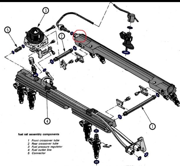

What did you circle in red there? Mine does not have that screwed into fuel rail. Looking up the photo for the cop relocation not seeing it yet. The bolts were tight as hell on the fuel rail. Do you happen to have the torque for those?
Old Sep 8, 2020 | 02:13 AM
Joined: Aug 2020
Posts: 27
From: California
Disregard... it’s late I’m going to bed, cold start injector.. as stated above. Just need those torque values if you got them in the am. I’ll tear this apart. Thanks again brother.

Seems alittle high for torque values.
TPI Torque Specifications
Below are the torque specifications as designated by GM for Tuned Port Injection intakes. Please note that some specifications are in lb. ft., and some are in lb. in.
Manifold to Runner Bolts 25 lb. ft.
Runner to Manifold Bolts 25 lb. ft.
Fuel Rail Attaching Bolts 15 lb. ft.
Throttle Body Attaching Bolts 18 lb. ft.
Throttle Position Sensor 18 lb. in.
Idle Air Control Valve 13 lb. ft.
Throttle Body Coolant Plate 27 lb. in.
Throttle Body Cover Plate 30 lb. in.
Power Brake Vacuum Fitting 108 lb. in.
Fuel Line Nuts 20 lb. ft.
Fuel Tube Bracket Bolt 25 lb. ft.
Fuel Pressure Connection 115 lb. in.
Pressure Regulator Base to Rail 44 lb. in.
Pressure Regulator Bracket 44 lb. in.
Outlet Tube to R/H Rail Retainer 44 lb. in.
