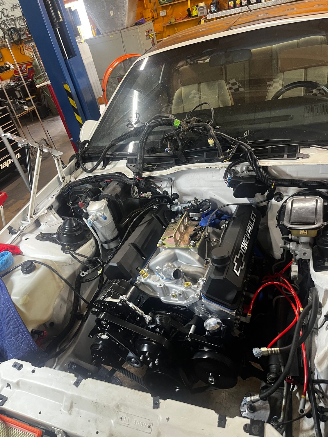

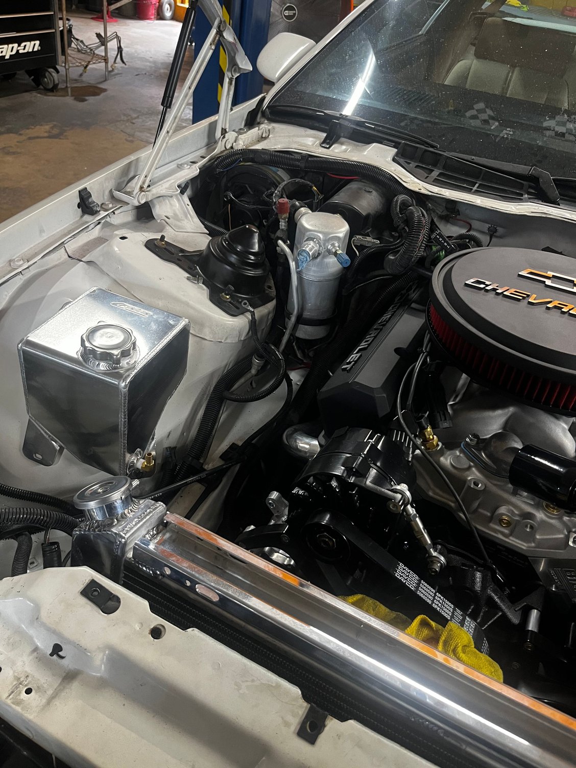

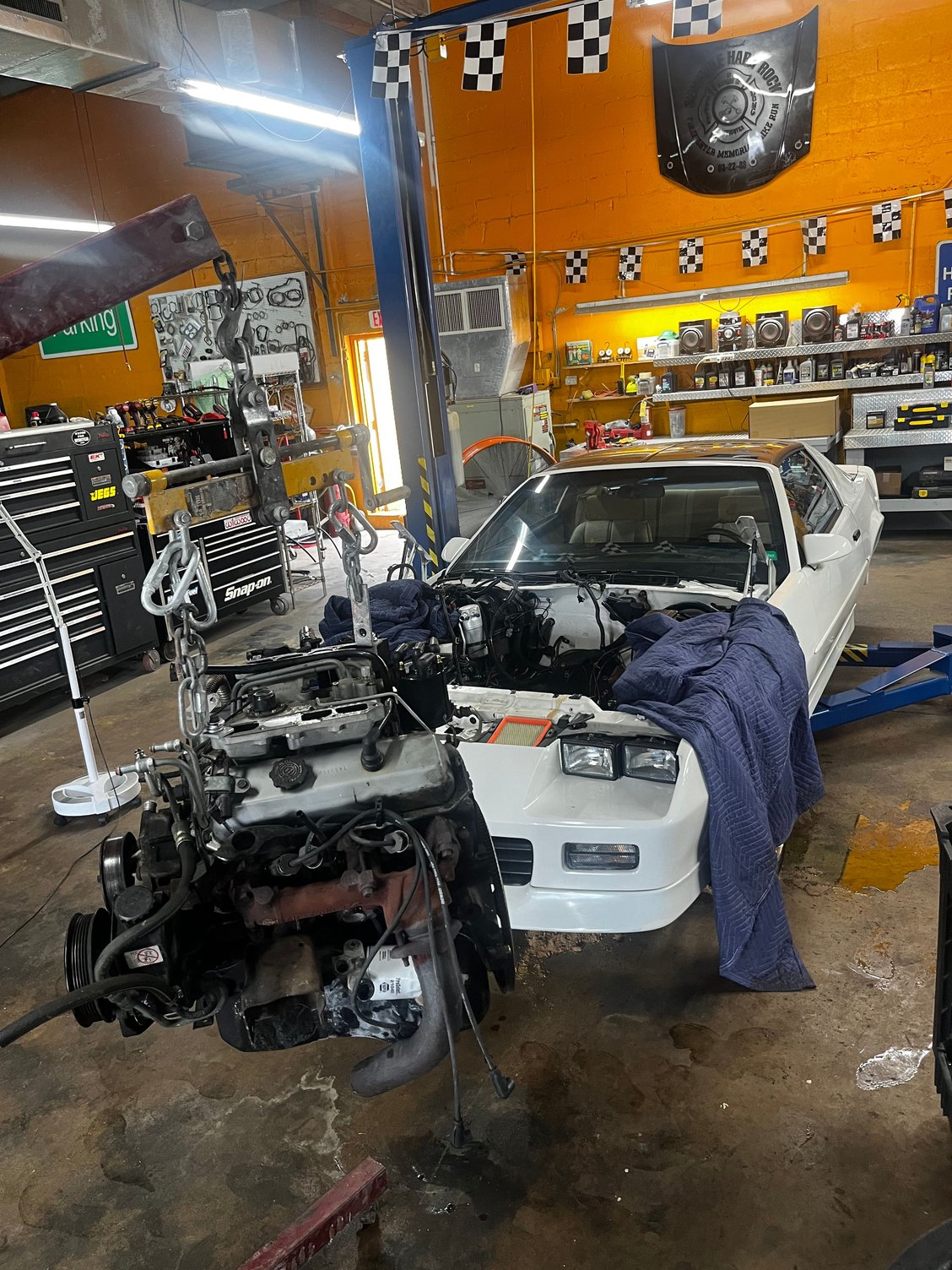

So I’m ahead of myself here, but I’m trying to get an idea of what I need to do since I can’t find anything regarding my combination.
We have the 2.8 out and the 383 currently in the car. Wrapping up the rest of the rear end / brake work currently but then we’re on to wiring. This is my first swap and first car project. While I’m moderately mechanically inclined, I’m a newbie with electric.
It’s a Holley injection system on the motor and I’ll be swapping the original gauge cluster with a Dakota digital VHX cluster. My question is, can I still keep the factory ecm in place, run my sensors through the firewall to the Dakota ecu and lengthen the stuff I need off of the pin harness behind the original cluster to the Dakota ecu as well? When I’m going through this in my head it just seems like it would be a mess. What can I get rid of from the harness’s under the hood? I know I need my 12v, iginition and tach from the original harness that went to the coil.
thanks in advance for your help and going easy on me lol

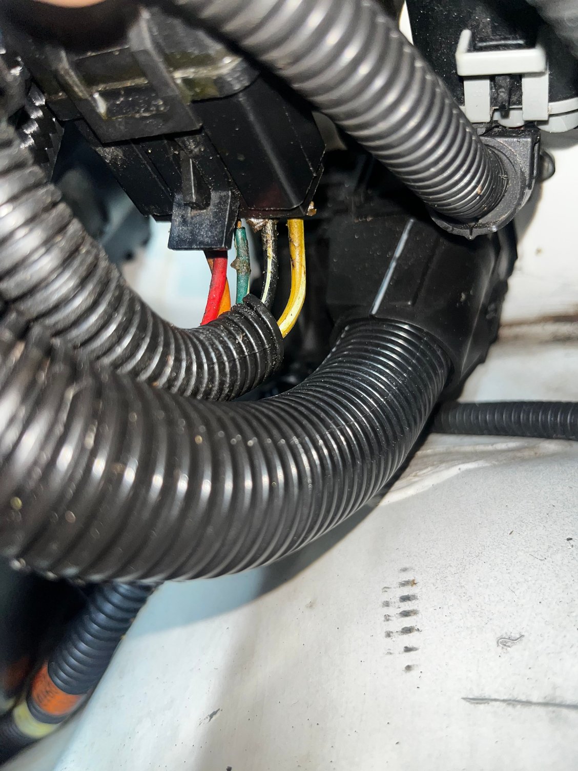

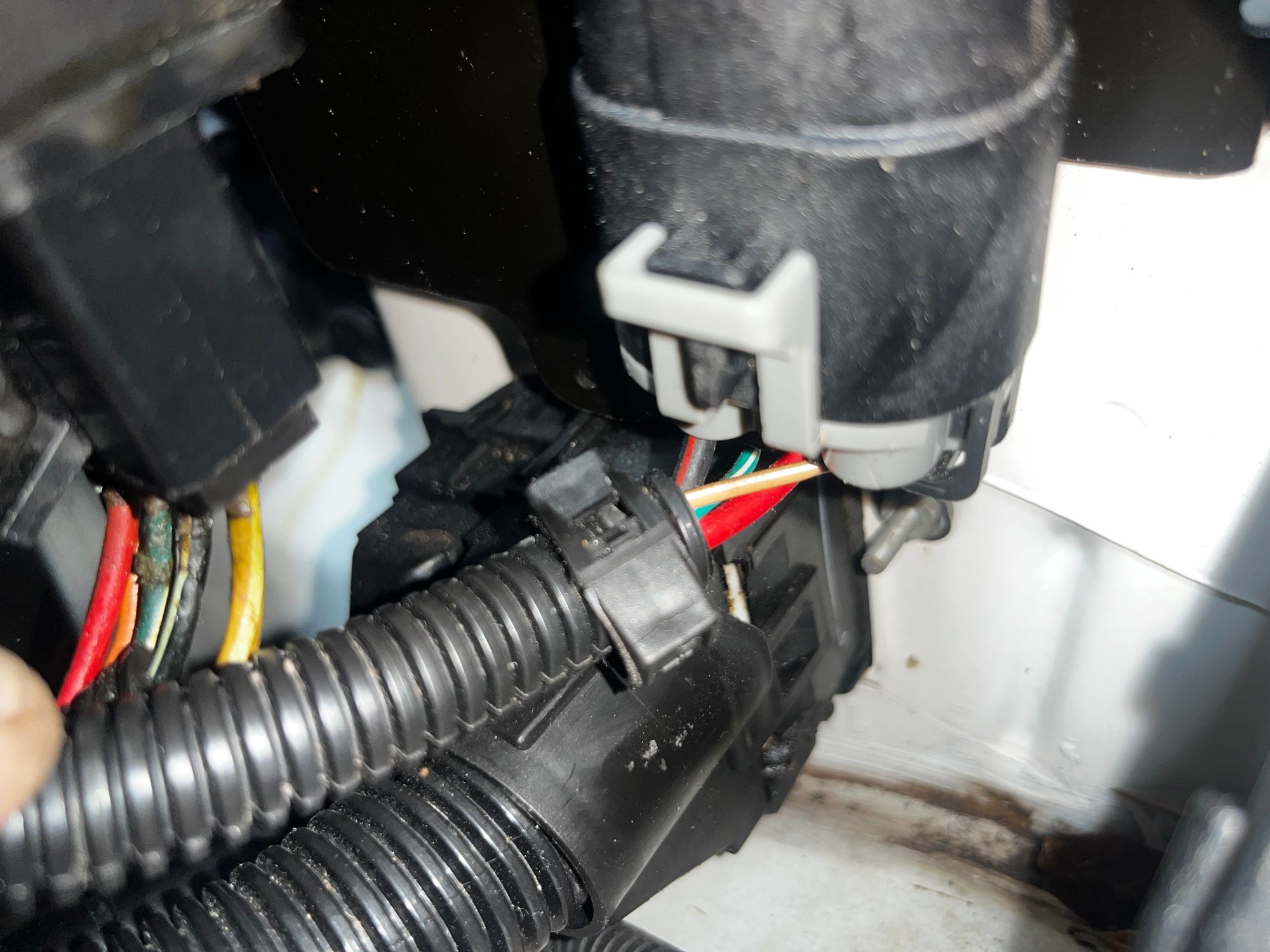

what about the tan wire for the fuel pump? Cut and splice after the relay? Or is there a better way? I think this is the right one.
