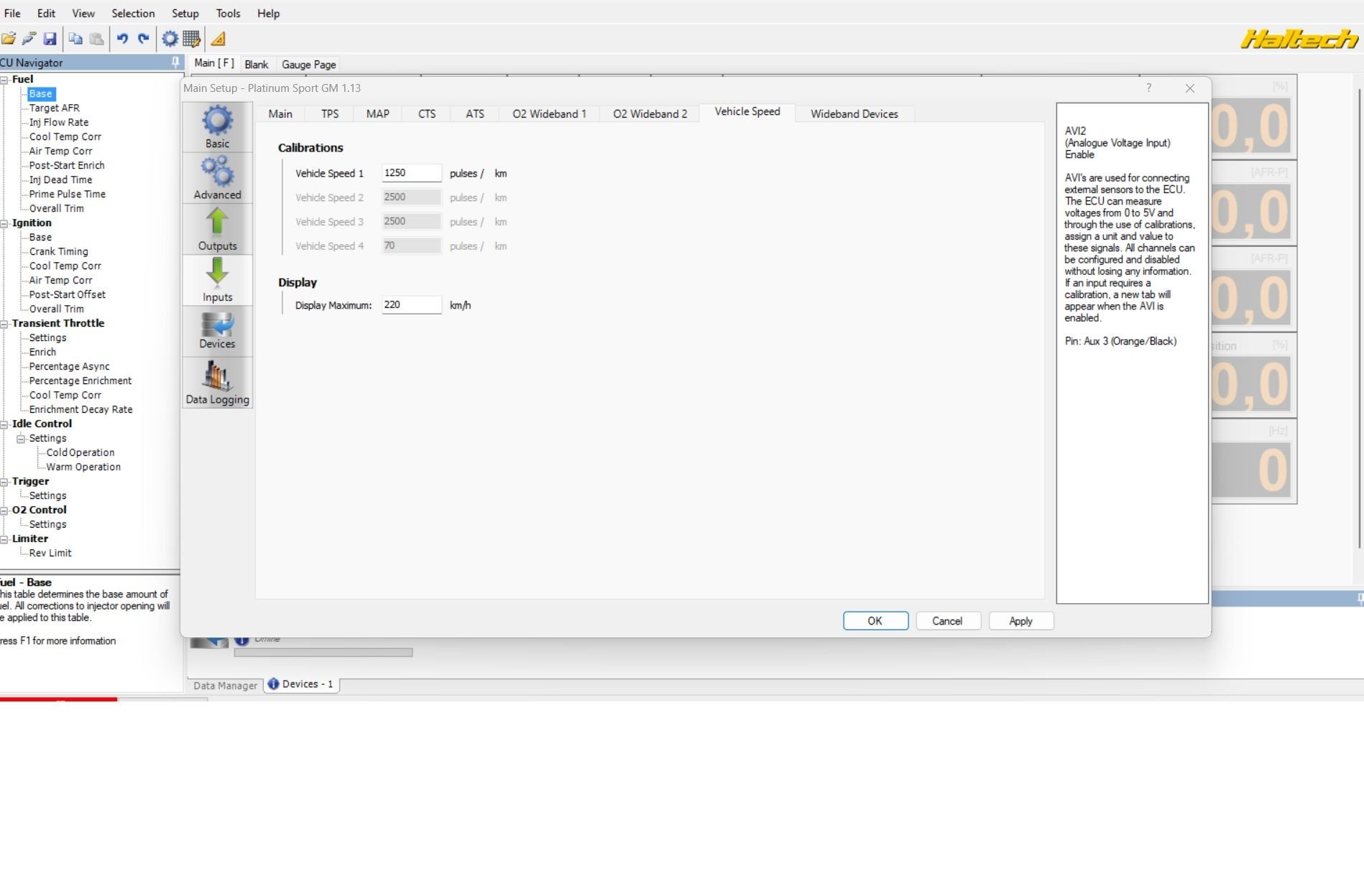

I think I have found the conditions for the OD order here, do you confirm?
Old Nov 22, 2022 | 01:17 AM
bigjim08's Avatar
Joined: Nov 2022
Posts: 14
Re: Haltech Platinium Sport GM + camaro Iroc 1988
and here the value to put for the taking into account of the speed... It is the info which arrives from the counter the small yellow box??
I find this value small... What do you think?
Thank you for your answers

The TCC settings look OK. The VSS PPM may be off a bit, but should give a reading.
RBob.
Well I checked, I have the speedometer pulse information, I continue to search...
