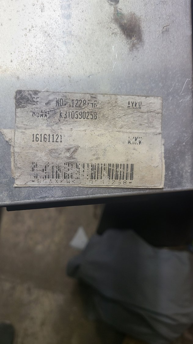

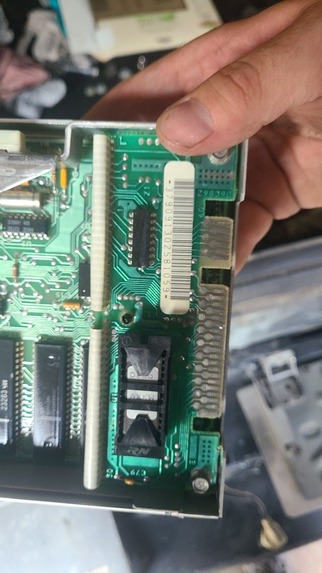

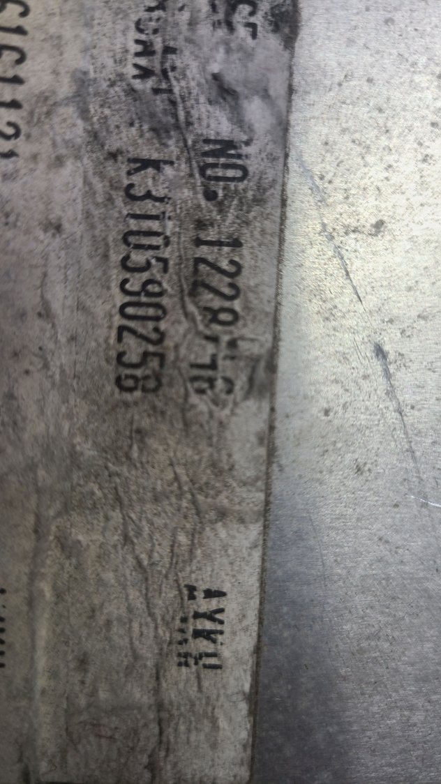

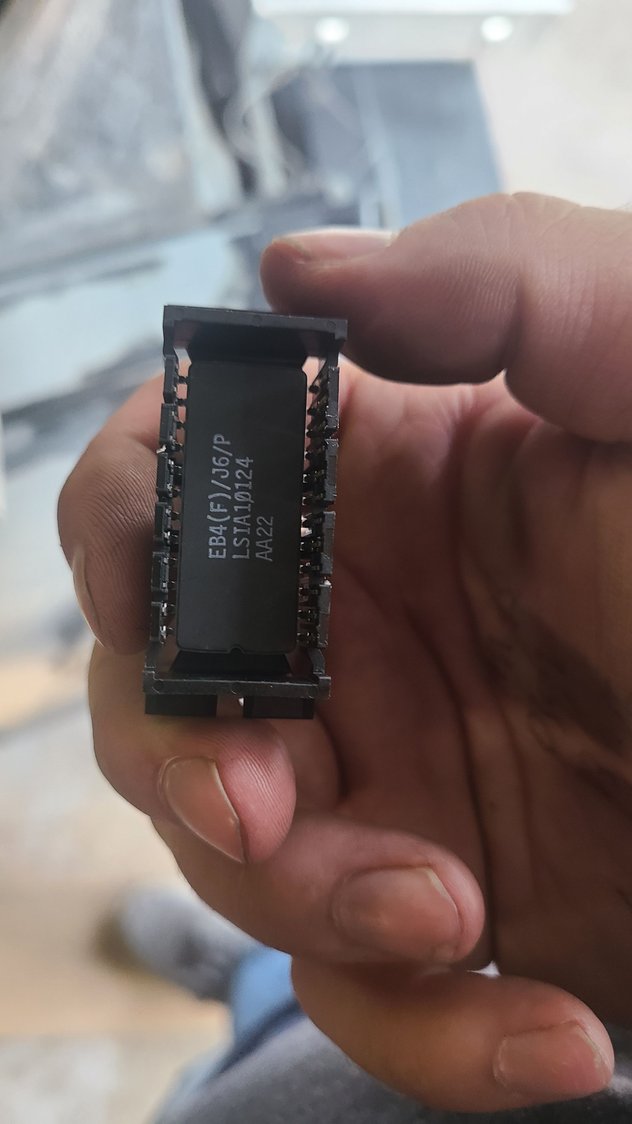

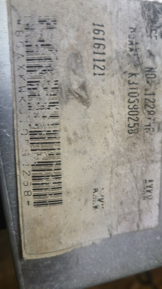

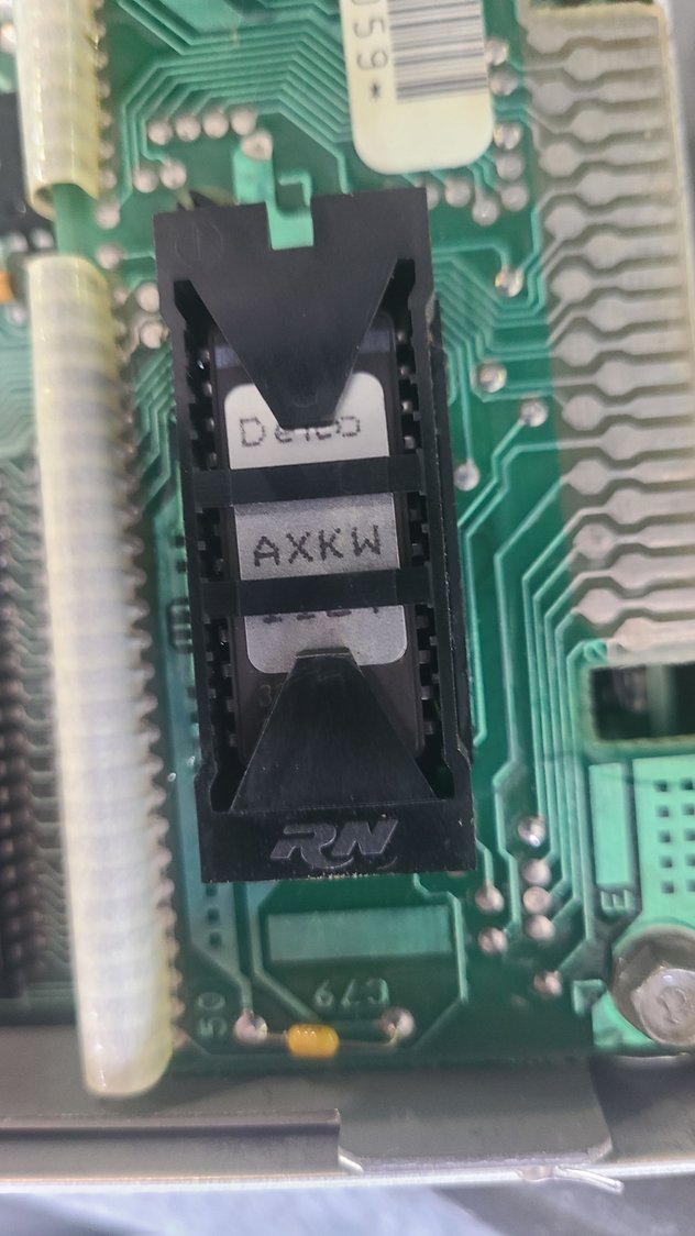

Hey guys, have an ECM out of my '91 305 TBI that I need some help confirming details about. I tried looking up the numbers on the tag but didn't have much luck. Here's some pictures of the p/n, and Prom. From "testing", I know it isn't limited at 95-99 MPH like I'd expect on a 305 TBI RS, so was wondering if it may be out of something else. PROM looked like a stock Delco unless I missed something.

AXKW is a stock chip for '89 - '92 Camaro & Firebirds with the L03, T5 & FED emissions. Need to go a little faster to hit the speed limiter, 108 MPH.

Awesome, thanks guys! I kept trying to search for 1228596 and kept wondering why I wasn't getting anything lol.
