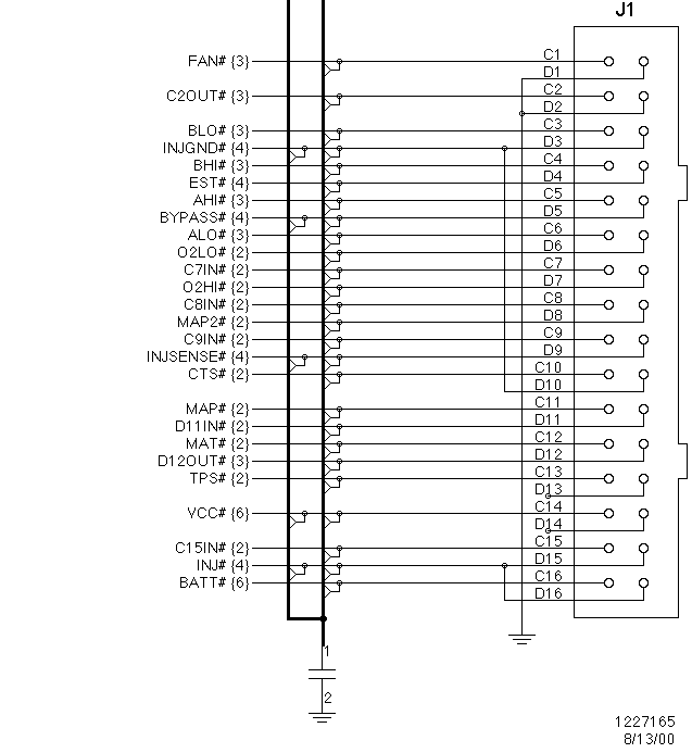

I think while you are getting the assembler stuff taken care of we should look at the choices for pins. The wb has an output of 0-5 VDC and this is what most of the sensor inputs for the computer are. I have cropped some images from Ludis's site (I hope he does not mind) in order to show what I mean. The 165 has two unused Map ports that may be used for signal input.
This is the a/d chip in the 165. It shows map2 on channel 0 and map on channel 3. We will use this information to write the software for the input. We need only hook the output of the wb to pin c11 or d8 and make the appropriate changes to the code to allow us to store, manipulate, and log wb data through a scan tool.
John

Looking at Lugis site I see several inputs that maybe usable, I am looking at the unused MAF input
I would stay away from pins that are not ground seeking. The way the MAF pin appears to work is that the difference between 5v and sensor voltage is taken on the resistor. This means current flows to the sensor. This may or may not be a problem. The sensor voltage is also inverted. This is something you would need to account for.
I think that the TPS2 or MAP2 pins would be more appropriate. This is the way I did it for the 8d code
HTH
John
HTH
John

Thanks John, I'll go with your suggestion and use the MAP2 pin. Presently dis/*** my bin, and comparing it to yours to see if I did it correctly. Other than changing the Knumcyl to $00 (8) and changing the injector size to reflect my injectors I have not made any further changes to my bin, ABYN base. cheers, Bob

is there no follow up on this, it seems to me that any aid in finding out what our engines are asking for, would save time and put the stand alone engine managment people in there place,,, i would really adore being able to view the AFR in Craig's software... tuning my 6e with a mod/MAF would be alot easier and allow me to add other options, {namely a ECM controled Electronic Cut out}....
Posts: 858
From: Elkton MD, USA
Car: 1985 Camaro Z28, VIN F
Engine: 427 sbc, HSR
Transmission: T-56, self rebuilt 700+ hp
Axle/Gears: Moser 12bolt, 3.42 trutrac
'7730 MAP ECM,and there doesn't seem
to be any available ground referenced
inputs to feed the WB data into.
It may still happen, but it may be alittle more
work than the code-only '7730 hac.
mike

that will work too, i have a 90 vette/auto, that i could test it out on, so if it works out as a great addition, i will definally switch to SD on the Bird
Now I have the 730
.But it would be nice to have a switch in winbin to turn on w/b input.The coding is the part I can't do.But is seems to be a popular idea.So could'nt you programmers out there make it happen?I'm sure there is enough talent on this board to do it,no problem.
.But it would be nice to have a switch in winbin to turn on w/b input.The coding is the part I can't do.But is seems to be a popular idea.So could'nt you programmers out there make it happen?I'm sure there is enough talent on this board to do it,no problem. Joined: Aug 1999

Originally posted by 87400tpi
Now I have the 730
Now I have the 730
.But it would be nice to have a switch in winbin to turn on w/b input.The coding is the part I can't do.But is seems to be a popular idea.So could'nt you programmers out there make it happen?I'm sure there is enough talent on this board to do it,no problem. switch/flag, but changing 7 bytes and
adding 100 bytes of code.
A "patch" program would be relatively easy
to do (I know some VB programs already
exist) but would be custom for each BCC.
I just presented the base bin with the hac
applied to it so people that are used to using
editors like Winbin, could just add their
custom data to a base bin already containing
the hac..
mike
