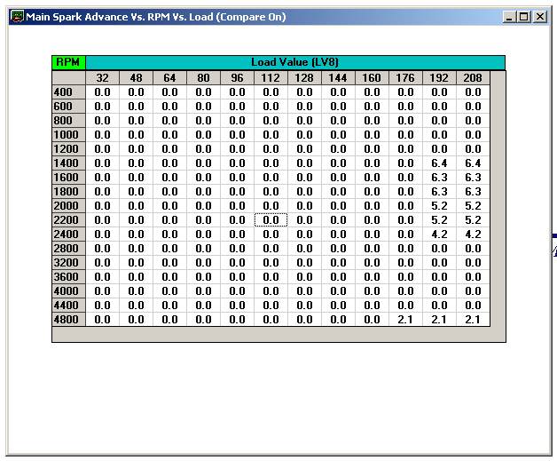

the hypetech chip that I have personally read and seen is from an 89 305 TPI 5-speed car. The only changes to the chip were as shown and lower fan on/off temps, that's it. The comparisson is to an APYS file for a similar configuration. The chip isn't radically different from a stock chip.
