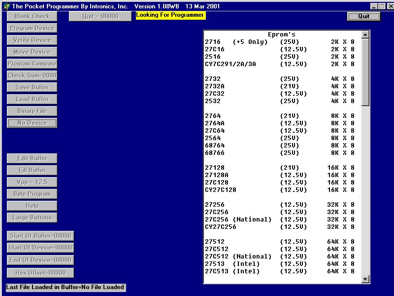

What's with the windows software? Looks like it's for the pocket programmer, not what you've got, or do they have the same exact guts, different shell?

No doubt. Exactly the same. Wonder if it's a clone. Maybe the Pocket Programmer is a clone of this? Anyways, there might be issue with that.

He did say that it had a $15 license for the software so maybe that explains it. They're paying Intronix for its software?
Yes it is by Xtronics, but its an OLD version. That version is only 1.08W from March 2001. If it is an earlier version, then there were a lot of bugs with it. I couldn't get Xtronics software to work properly on my computers until around the V 1.20 (Summer of 2001).
Also, does it allow you to get the "upgrades" from Xtronics?

I have it working with win 95 & 98 (haven't tried XP) by using the software for the Pocket Programmer II. Surprise..they are the same programmer except one is center pos the other neg.
