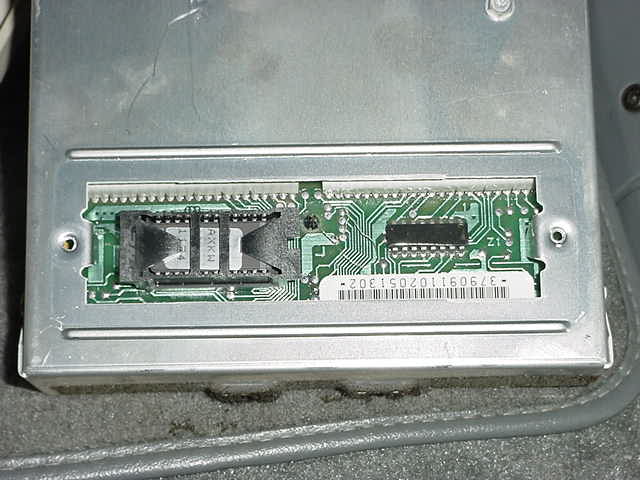

One more thing...I forgot I had a pic of the chip before I removed it. As you can see, the notch was facing toward the inside.
Man, you really had me freaked out there for a minute...

Just to completly eliminate any PROM issues...
You had to remove the chip itself from the carrier, Correct? Are you sure you placed the PROM back in teh carrier in teh right direction?
Just thinking of other possible scenarios.

Well, I pulled the PROM out and verified that the notches were both facing the same direction. In the process, I noticed that some of the pins didn't appear to be properly seated in the plastic holder and I just KNEW I had found my problem. I put the pins in place, relpaced the chip, reconnected the battery, fired it up......nothin'. It is still throwing a code 51 and I don't believe the injectors are spraying any fuel.
Does anyone know how I could use a voltmeter or something to verify that my ECM is OK, the EPROM is OK, and that the EPROM is getting a good connection to the ECM? Man, this is so frustrating...I've got a brand new engine/tranny combo and I can't even try it out. Thank goodness I have a spare car to drive for now!
