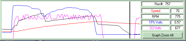

Log file
Here's a log of the O2 getting on the highway.

My site won't behave so I'll just do it this way

maybe?
I think I'm chasing a ghost!
After adjusting the lower Ve table to appropriate values my BLM are real close to 128.
But on my datalogs I read rich when there is no correction being made.
Question:
Could my O2 have an offset to it?
I realize the accurracy issues with these as far as actual volts to content but what if my Bosch (I've heard) is just reading incorrectly. When I read lean (only at 2500 and below) I have plenty of power and very good drivability. After adjusting to get the 128's I've got stumble from off idle and some close stalling.
None of this occurred previously but was reading 150 on my BLM for these cells.
Question 2: Should I adjust the AFR in the bin lower and keep the values I used to get the 128's?
Question:
