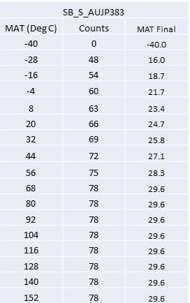

I'm confused now. I just went and looked at the $DA3 LT1's (BDLD M6 and BDZL A4) and they're both showing the Inv lookup table enabled. I know they don't have the IAT sensor in the intake manifold.
Their tables are different than the $8D tables though (and I threw in Glenn's table for kicks).
So if the LT1's are also running the Inv look up table enabled and they're clearly in the IAT category, when exactly would you want to deactivate that table?

So I took the car out out for a run yesterday. I had put in the $DA3 LT1 MAT values and it made a noticeable improvement in throttle response and overall pep. Definitely made the conversion worth the effort!
But the curious thing were the temperature readouts themselves and it got me to thinking...
I have an ambient temperature readout in my rear view mirror (see below)
The sensor for this is located right in front of the air filter under the front bumper. Before the car even starts up, there's a built-in ~4°F delta between the mirror temperature and the scanner readout of the MAT sensor. Attributable to simple variability in the two devices. Though keeping the built-in difference in mind....
So when I'm driving 75 mph on the freeway, I would expect no more than that same 4°F difference, yet I get a ~12°F difference given the amount of air flow passing over the two sensors. That got me to fundamentally thinking more thermally... particularly self-heating effects (given RBob's explanation in the opening of this thread)
The plastic body MAT sensor is sitting in a rubber grommet, in a rubber air tube elbow, which constitutes a very lousy thermal path for self-heating. Intuitively it should be very well insulated against self-heating. Despite that, we know the sensor element will still pick up some small amount of self-heating from it's surroundings. However, with significant air flow it should be able to lose heat to the air stream faster than it's self heating, which means it should cool down to the air stream temperature. But yet, I'm still getting that significant temperature difference, which implies significant self heating. So why would that be?
So I started thinking about what else could be putting heat into the sensor element and then it dawned on me: the freaking wire harness. In my setup the wire harness runs from the firewall, under the intake manifold, and drops down in front of the fan. It's a long run of copper wire with a lot of surface area to pick up heat (which there is plenty of). Since copper is a superb conductor of heat, it's going to very easily conduct that heat to the nearest heatsink. With heat always flowing from hot to cold, and the air stream cooling off the sensor end of the wire via the air cooling off the sensor element itself, my guess is that the heat in the rest of the wire is seeing the cooler end and flowing to the sensor element, thereby causing self-heating from the inside out.
My next step is to re-route the wire harness off the engine and see if I can get rid of that temperature delta. It may not seem like a lot, but I'm also thinking that when driving around town, with less air flow, the difference is going to be significantly greater (and much more difficult, if not impossible, to quantify), which would ultimately prevent me from taking full advantage of the colder air coming in.
BTW, I also thought about electrical resistance vs temperature, but that appears to be only a very minor contributor...
For copper... R(T) = .1 * ( 1 + 0.0039 (T - 20) ) where T is the measured wire temperature in °C and 20 is the baseline temperature 20°C , above which every degree results in a .39% increase in resistance, and the .1 ohm is what I measure at room temp
So for 180°F (82°C) steady state engine temp (assuming the wire reaches that temperature)
R(T) = .1 * (1 + .0039*(82-20)) = .124 or, in other words, a .024 ohm actual increase in resistance on the circuit. Negligible in my opinion.

I have relocated the MAT to the airbox entry instead of under the plenum. By doing so there is less variation in MAT readings and heat soaking is cleared quickly. My MAT tables had to be completely retuned, so maybe I got a different curve slope. OEM curve was like ANHT.
Here it is:
Now this table was tuned in conjunction with MAT Inverse Term Lookup Delta Mult. vs Airflow. It is tuned to max out pass a certain level of heat soaking. The calculated final MAT is what the ecm will use for air density purposes at WOT. This was necessary to stabilize real AFR in PE when IAC sensor is heat soaked. It limits the amount of fuel pulled at WOT. The BLM/INT will take care of air density variation when in CL. At idle, on hot engine, outside air temperature as little effect on air density in cylinder.
Here it is:

I disabled my Inv MAT table altogether. With the MAT sensor no longer mounted in a metal plenum on the engine, didn't make sense to run that table. The air spends so little time in the metal intake (short runner Miniram) and I have a non metallic air tube so I didn't see the air having enough time to get preheated.
I can see the Inv MAT table being dependent on engine and air intake configuration as well as sensor location, but to me air density is air density regardless of anything except temperature and pressure.

Interesting...
I went back and looked up the BDZL/BDLD (93 LT1) as well as BKFS (96 Corvette) calibrations and they all have the Inv MAT table enabled...
With the IAT in the intake duct and not the metal manifold, I wonder why GM would be trying to factor this in?

Who knows eh?
I did keep them enable even if relocated the IAT to air box. I’m trying to remember why! Definitely had to retune them. I believe no matter where you get your reading from IAT there is still a difference between idle and WOT heat transfer. So I might have tuned it that way, basically adding fuel as the air flow increases.
I find that relocating IAT gave me ease of tuning not have to worry about large variation in MAT readings. And also, sensor heat soaking dissipates more rapidly.

Another question...
If you wanted to move the BLMs by say, 4 points richer by altering the MAT compensation table at a particular temp, how much would you move the MAT table value?
IOW, Is there a correlation/formula between MAT counts and BLM? Like on the VE table, you'd simply scale the VE cells by the ratio of your BLM against 128. Is there something analogous for the MAT table?
Yes there is a certain correlation (if we can call it that) between the MAT "count" and the INJ BPW, before BLM/INT correction.
First, here's the formula for INJ BPW on $8D:
Second: "Air (Kg/m3)" is the calculated air density based on MAT input. Now we know the MAT input is modified before being used in the above formula. The "Inverse Term Lookup Delta Multi. vs Airflow" (table 0x80E) can play a role if enable. The MAT input is adjusted using 0x80E and CT input. Formula is the following:
- CT - MAT = Delta
- ECM uses an airflow g/sec calculation based on this formula:
(INJ Flow Rate/60/60)*1000/2.20462 = Air Flow in g/secCyl. Vol. in ml * 4 * VE% * MAP/Baro * ((Baro*1000)/(287.058*(MAT+273.15)))/1000*RPM/60 - It then looks up the g/sec using 0x80E which returns a multiplier
- Adjusted MAT = MAT input + (Delta*multiplier)
What ever value is returned by the count entered in the table 0x7FD, I call it "Final MAT". This is the value used in the above formula, Air (Kg/m3).
Third: So you can see how many moving parts there are:
- If Air (Kg/m3) is adjusted +/- x% it will results in the same +/- y% in INJ BPW before BLM/INT.
- It has to be Air (kg/m3) delta, not Deg.C delta.
- It should be an inverse relationship between Deg.C and Air (Kg/m3). The hotter the less density.
- Air(Kg/m3) = (Baro*1000)/(287.058*(Final MAT+273.15))*0.99 (Humidity is locked at 50% for simplicity).
- So BLM would have to move in opposite direction from "y", at the same rate
- Problem is, the BLM will adjust based on the INT. So INT would react first to keep INJ BPW stable. Then, BLM would adjust if thresholds were met.
- BLM can only +/- by 1, which is +/- 0.8%
Fourth: Problem is, the nonlinear regression above. Every +/- count does not always = the same +/- "Final MAT", thus not the same +/- Air(Kg/m3). So you have to know what impact each count have on Air(Kg/m3).
Example:
Increasing counts from 30 to 40 = 4Deg.C to 11Deg.C = 7 delta
Increasing counts from 110 to 120 = 42Deg.C to 46Deg.C = 4 delta
Increasing counts from 30 to 40 = 1.282Kg/m3 to 1.250Kg/m3 = -0.032 delta
Increasing counts from 110 to 120 = 1.127Kg/m3 to 1.113Kg/m3 = -0.014 delta
Increasing counts from 30 to 40: x = -2.5%
Increasing counts from 110 to 120: x = -1.2%
Fifth: Example:
- Everything else being equal
- You increase counts from 30 to 40
- "Final MAT" increases from 4Deg.C to 11Deg.C
- Air (Kg/m3) decreases from 1.282Kg/m3 to 1.250Kg/m3
- x = -2.496%
- y = -2.496%
- INT has to go up 2.496%
- If INT is at 128, it needs to go to 131.2, rounded to 131 or 132, don't know
- Probably not enough to trigger BLM adjustment (needs +4 INT for a certain duration, I believe)
