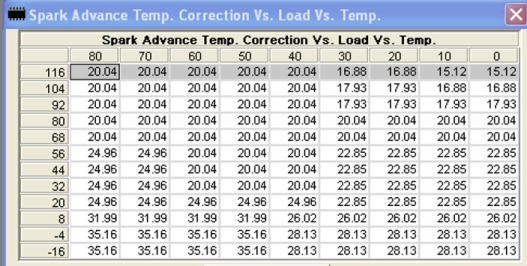

My initial distributor is set to 11.95, Spark Advance Max 41.84, Spark Advance Base Temp corr Bias 20.04,

SA temp correction vs load vs temp
