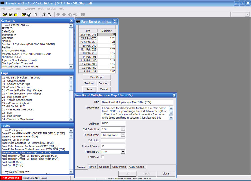

Ty1295 just sent me a New $58.xdf and I put it up on NWSTP.com. This XDF file is still a work in progress. Look it over give feedback if you find any other errors.
Some of the fixes are for RPM fuel cut (8 cyl) and RPM fuel cut (6 cyl) plus some other kpa/PSI conversions to the labels for easier editing.
We added a ton of notes from Brian Green (made the syty code 3bar back in 97) that make it nice to know what each item is for. All the notes are from this page.
http://www.nwstp.com/forum/chiptable.asp
Just hit F2 in TunerPro 4.x to see the notes on a item.
Here is what it looks like.

Quote:
Or, even better and easier, open the item in the editor and hit F10 to see the "real" item comments window. :-DOriginally posted by skwayb
Quote:
I saw that screen before but couldn't figure out how to add text to it.Originally posted by Mangus
What did I miss?
Quote:
What did I miss?
Heh... the text that is shown in the description field of the XDF item editor in Paul's screen shot is the text that is outputted in the item comments window (F10).Originally posted by ty1295
What did I miss?
Make sense?
Make sense?
I am either still missing it, or maybe something is wrong.Originally posted by Mangus
Make sense?
Hit F2, get description of table.
Hit F10 with same item highlighted, get a blank screen that I can't type in either.
Open the table. =)Originally posted by ty1295
