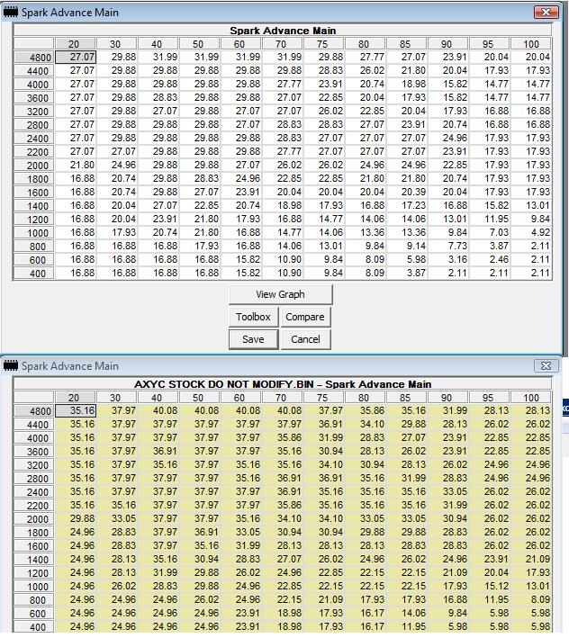

Attached is a picture of what i modified in the SA table of the bin. I kept the same curve but took out 8* from the whole thing. I also changed the injector constant to 19.7 ish since my fp is at 35psi vac off, and the inj are rated at 22# at 43.5... Also i took out some timing from the lower end (idle) of the closed throttle vs SA table.
top is mine, bottom is what it was stock.
check it out and lemme know what you guys think. I did also notice that the car ran smoother, but especially smoother with the heater blower motor on...?HUH???
any help is great! thanks again guys.

Re: What can cause this???? EST discon.=Runs better??
Anyone see the attachment??
So I have noticed that about a week after running this calibration code 42 pops up...HUH???
Is this common??
I have been running this bin for a while and it has seemed to help with the misfiring. Judging by the diagnosi (plural of diagnosis
) it is an ignition related misfire. I suppose it may be the balancer slipped like what dr. fiero suggested... Anything else you guys would do??
Thanks so much for all who contribute. I know this is a tougher one to help, but multiple inputs are better than one! thanks guys
Is this common??I have been running this bin for a while and it has seemed to help with the misfiring. Judging by the diagnosi (plural of diagnosis
) it is an ignition related misfire. I suppose it may be the balancer slipped like what dr. fiero suggested... Anything else you guys would do??Thanks so much for all who contribute. I know this is a tougher one to help, but multiple inputs are better than one! thanks guys
