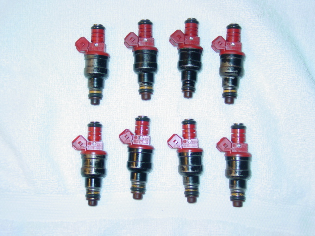

no, most likely these are the ones hes running. those arent the EV1 type ford SVO 30lb injectors.
these are the 30lb SVO EV1 injectors AKA redtops, same ones im running
http://www.uribe.ws/images/caprice/DSC05981.JPG
EV1 is the same style injector connectors as our stock wiring harness

The ones I posted are ev1. Those are the ones I'm running. Anyway sorry for going offtopic thread starter.

im running the ones customblackbird posted
