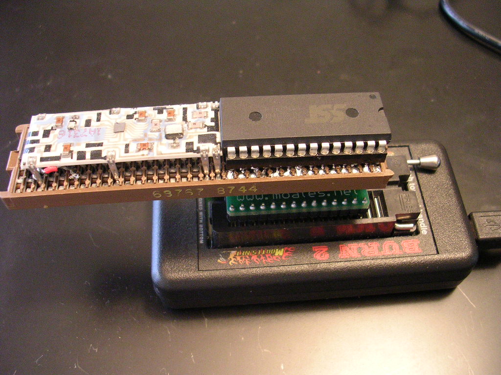

I have modified a V6 memcal for a V8 TPI using a 1227727 ECM. I have the engine running on the engine stand. I'm getting an error code 43. I checked the knock sensor, 100K ohms. I have the knock sensor wire connected to pin A11. Could the modified V6 memcal cause the ESC error code 43?

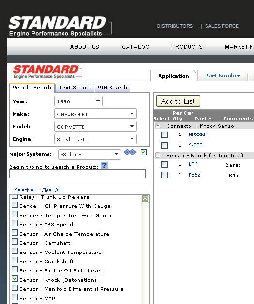

Thanks RBob, I will figure out a part number for a 3.9K - 4K ohms Knock Sensor.
I figured because I was using a 1990 TPI roller 350 engine with the '7727 ECM, the correct Knock Sensor would / should be from 1990 Vette?
The application is correct, it is the wrong sensor for that application.

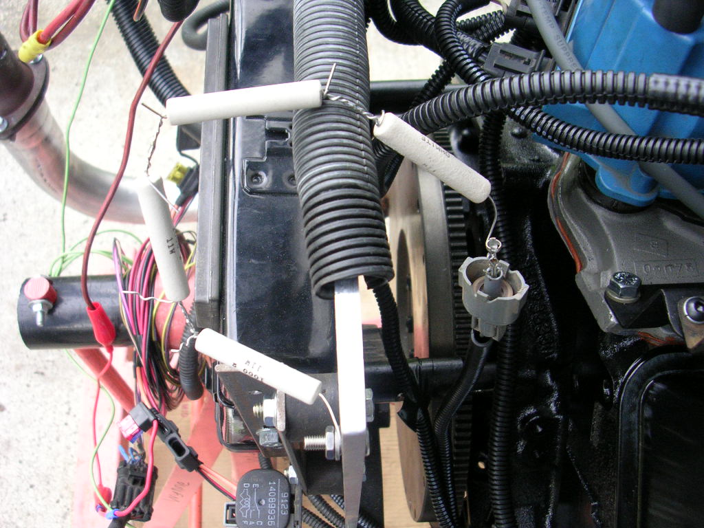

I figured out two things that will fix the error code 43.
1. Programming the PROM so Error Code 43 will not set.
2. Using 4.06K ohms of resistors instead of a Knock Sensor.
Today was not a good day to use a DVM at the parts store.
dave w
