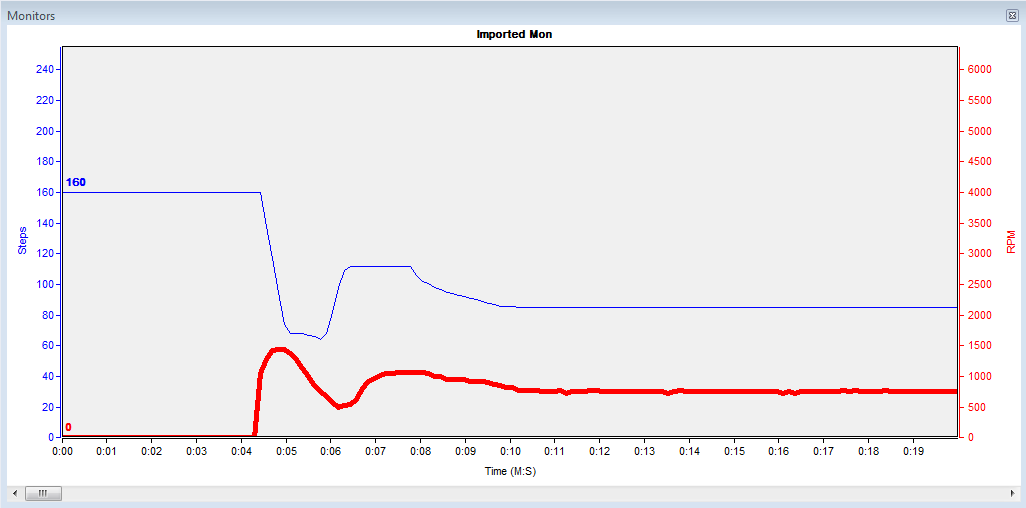

i am trying to tune my brothers car and the main thing he wants fixed is the start up. It will fire up good, then stumble, and then catch itself again. i run the same tune on my car and don't have this issue. both cars are 87 '165 6E. mine is a 5.7 and his 5.0. Thanks for any input

Here is the start up of my car. the IAC positions are completely different despite being the same settings. any ideas?

I would first set the minimum air and the TPS at idle.
I really can't see that the ECM would set the IAC at 0 (closed, maybe 1 or 2 steps) for cranking. Doesn't make sense.
And having the IAC at 160 for cranking is rather high.
Are these both cold starts at the same engine temperature?
Would be better if we could look at the BINs. A short data log of each would also help (in formatted text or .csv format)
