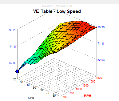

Ok after 6 cycles of VE Learn with just a NB (narrow band O2 sensor) things are slowly getting better.
I ended up with this as my VE Low graph
Thanks to finding the smoothing function in TunerPro I did a 0.05 across the board smooth and ended up with this
However it smoothed everything UP...which I didn't really want.
So now how do I get things back DOWN in areas and learn how to smooth DOWN or at least neutral?
Thanks for tagging along for the ride.

Re: TBI crate motor EBL Flash 1st timer
Don't do that...
Back up to the previous BIN.
RBob.

Going back to previous BIN number 5 and won't use TunerPro smoothing....can I ask:
Do I need a nice smooth graph?
If so what is the best way to get there?
Big Thanks
Here is the VE Low graph for BIN 2011 VE Learn Version 5
I assume I am still getting too much fuel??
What do the colors mean? Too much or too little fuel? Or just rich vs lean or ??
Should I manually drag things down to be smoother using TunerPro?
Here is the BIN that matches that graph and the DAT file from EBL Flash ( changed it to a TXT file to get it to upload, just download and change back I think)
In the end, mostly.
Yes.
The colors are just a representation of the VE% value in the table (0 - 100%).
You can do that, the short VE Learn does show how far to reduce the VE table. Leave it a little on the richer side (higher VE), as that is better then too lean.
Then continue on with the VE Learns. Be sure to get the head casting number so you can get the right spark advance table in there.
RBob.
