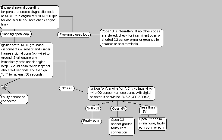

Well, no cable today...I did install a heated o2 sensor (3 wire) I get an o2 service engine soon after reaching cruising speed, but it goes away and doesn't seem to do it idling. Are there any parameters that need to be adjusted for this change? Thx again. That cable better be here Monday lol

What code 13,44,45 ?

Oxygen sensor voltage stays between 0.35 and 0.55 volts for 60 seconds. I'm wondering if your lean condition is causing this.
Diagnostic mode is connecting a to b at the aldl and running the engine. Closed loop is fast flashing of the check engine light.

Good point. Definitely running lean.

Re: 400 SBC TBI tweak
35c, COOL Min for CLS LP Enable
Not at home to review the datalog but it must be o2 signal related.
Tuned Performance is offline   Reply With Quote

Double post, sorry. Wow so some guy may have reversed the ground and sending wire on the 3 wire o2....
Mark Uptergrove is offline   Reply With Quote
Old 03-21-2017, 07:02 PM   #50
iTrader: (77)
Tuned Performance's Avatar
Join Date: Dec 2004
Location: Mile High Country !!!
Posts: 8,675
Not sure what we're looking at lol
