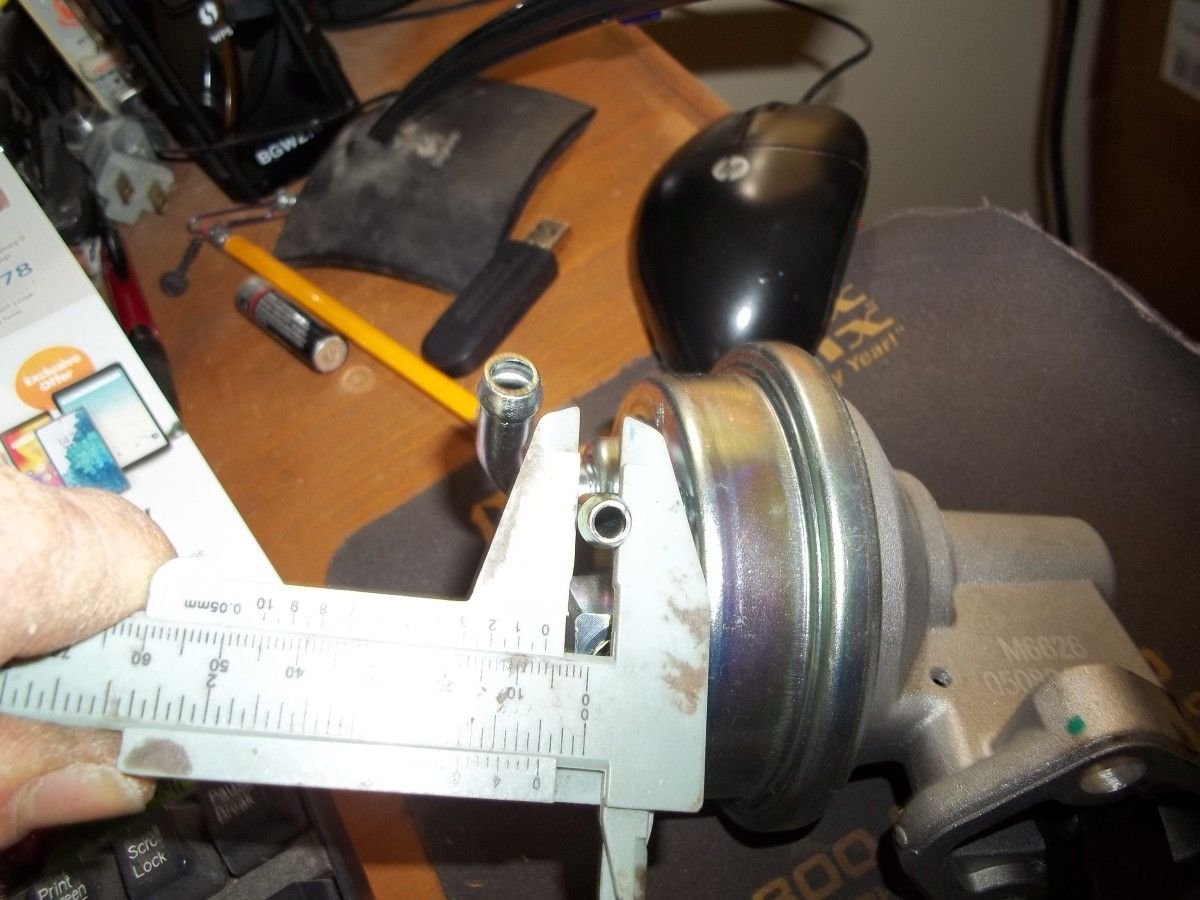

What was the original 3rd gen F-body carbureted V8 fuel return line diameter? The places that sell the so-called "reproduction" fuel lines are selling 5/16" return lines for the carb equipped cars, the same diameter as fuel injected return lines, but shouldn't carbed cars' return lines be 1/4" like the return line port on the original style mechanical fuel pump is? Also, my GM G-body catalog shows 1/4" for carbed fuel lines, plus the picture in my 1986 Camaro assembly manual shows the return line being significantly smaller than the 3/8" fuel supply line.

Which fuel pump are you referring to? The Carter M6626, which is the mechanical fuel pump specified for carbureted 3rd gen f-bodies (and the other manufactures version of that pump) has a return port that is only 1/4" diameter. Are you sure you're not thinking of the fuel injected electric pump? There's no stock mechanical pump that I can find that has a return port of 5/16" as you said.

My aftermarket fuel pump I ordered online and it's NORS made in the US. It's not a made in China or Mexico pump you were referring to.
I don't think that GM would have used any different fuel pumps on 3rd gen F-bodies than they did for other makes getting the LG4 engines. I'm sure the same 305's that went into Firebirds and Camaros also made their way into Caprices and Monte Carlos.
Also, I don't understand what the point would have been to use as large as 5/16" fuel return lines on carbureted cars. I suspect very little fuel needs to returned to the tank with a carbed car using a mechanical fuel pump. Cars were made without fuel pumps with return ports for decades before they started using ones with return ports them in the late 70's. I suspect the extra return port was added to mechanical fuel pumps as much to help prevent vapor lock as anything else.
