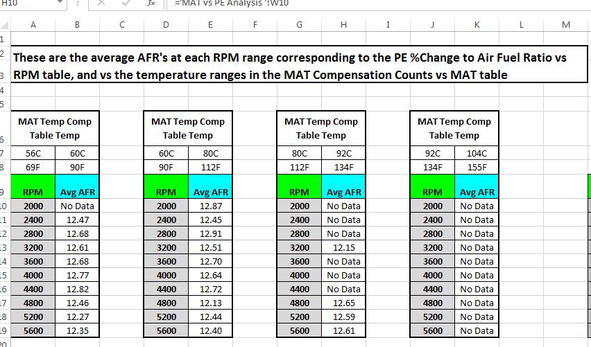

I generated the tool and it really works great!
The image below a screen capture of the output... You can see how it plots average AFR for each standard $8D PE reference RPM range vs the $8D standard MCC reference temperatures.
You can see how for this run, I didn't quite hit all the RPM ranges for one of the higher MCC temp ranges. But you can see how the PE average AFR's hold pretty constant from one temperature to another.
It's basically gathering all the AFR data points recorded during all the time spent in a given RPM range and MCC standard temperature range, then simply takes the average of all those AFR data points.
It wasn't warm enough out here lately to get a good amount of data at those higher MCC temps like the 80-92C range (and with my CAI tube, I never get above 92C anyway). So it'll be interesting to see how it performs when it gets warmer. But at this point, it doesn't look like it'll be too far off. In areas where there is no Tunerpro data captured for the given RPM range and temperature range, it returns "No Data".
So with this kind of tool, you basically tune PE's at one MCC MAT standard temperature range using the PE tables, preferably the lower temperature ranges when the car is at max coolant temperature, but still "cold" in terms of underhood air temps.
Then you tune the PE's at the other MAT temperature ranges only using the MCC table (no PE table adjustments). The end result is you get that "cold car" feel indefinitely.
