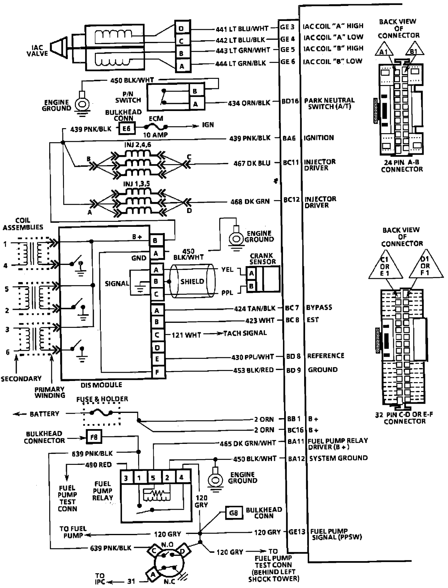

I have attached the .bin I am using as well as the wiring diagram I used to wire it up. If that helps.
Drew
