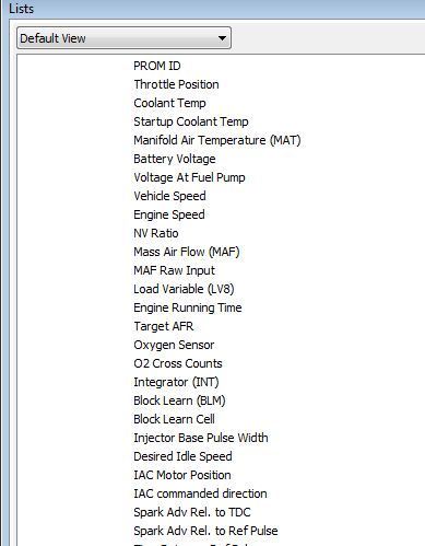

I'm taking a look at some TP data from a 6E car and when I go to list view in TP, I see the parameters, but there is no data being displayed? Dash view works though... when I go to the dash view, I can see the names of parameters with data being displayed..
Using the 1227165_6E.adx and the 6E xdf from Tunerpro.net...
This is all I see in list view while replaying the data...

Recall that the ALDL can be run at either 160 baud or 8192 baud. With different data streams.

Rbob, thanks. Though I'm not sure I understand.... Is there some setting on my end or his end that needs to be changed?

Seems to be fixed in the latest update.
http://www.tunerpro.net/downloadApp.htm

Boom.
You da' man!
It works now. Thanks!
And frankly the TunperPro guys are da' man's too for continuing to support and update the software for the community!!
