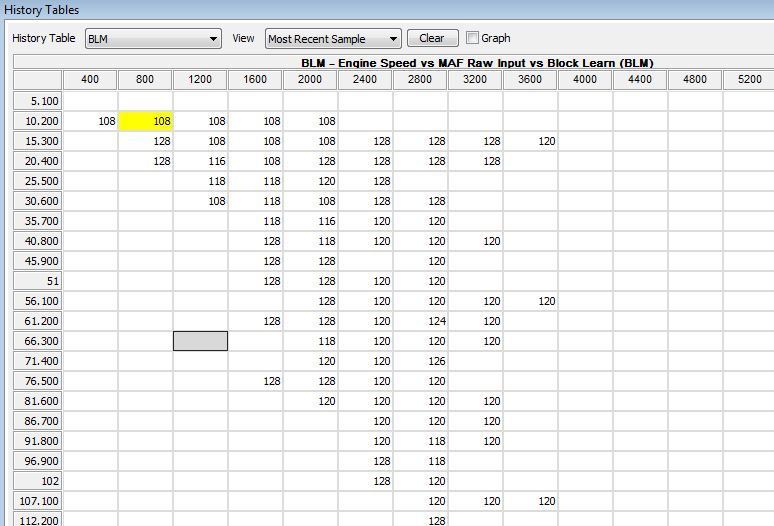

Let me know if this makes sense...
So I generated this histogram... I plotted BLM vs raw MAF counts and engine RPM. The MAF column increments every 5.1 counts across 50 table entries (255/50).
Once the playback populates the histogram, I can copy it out to an excel file... at which point I guess I need to convert the raw counts to volts in order to see what tables are impacted and which airflow values to modify?
Old Apr 1, 2019 | 03:45 PM
RBob's Avatar
Posts: 18,432
Likes: 234
From: Chasing Electrons
Car: check
Engine: check
Transmission: check
Re: Dumb question... how does the fueling work on $6E
This thread explains a lot:
https://www.thirdgen.org/forums/diy-...scellanea.html
