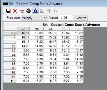

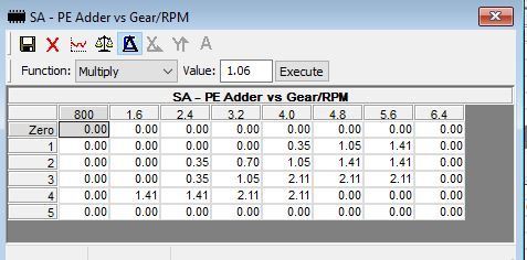

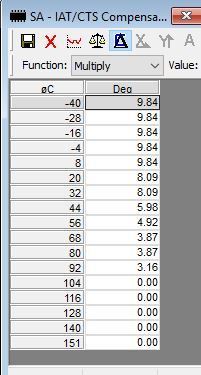

Thanks Rbob, I'm double checking the logs. At 3200 RPM I'm at 30* advance and 97KPa, and all the way up to 5500 RPM it doesn't go above 32*. And Confirming the SA Main and Extended table show 35.16* in every cell from 90 to 100 KPa and 3600 to 6000.
SA-PE Reduction vs MPH is zero'd for all cells. I'm showing the other tables below. The SA Coolant Bias and SA IAT Bias constant are both set at the default of 9.84.
I'm afraid I still don't understand why I am not getting up to 35 degrees advance. Can you suggest what I should change?

Re: Timing Adjust
Timing is being pulled via the "SA - IAT/CTS Compensation" table. Any value less then the bias is removing SA.
Also, check that the "SA - Maximum SA with Positive Value" is set to 41.85°.
RBob.
