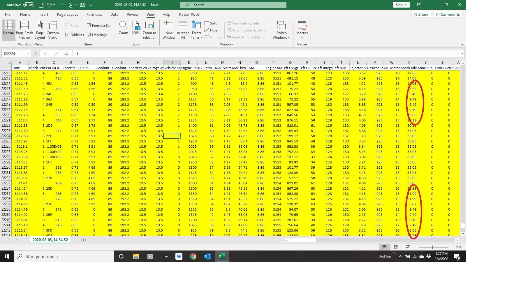

I think ur right Larry. However, I took another look at the datalog and I believe attached is an example of what RBob was describing above with Stall Saver. U can also see the Rich/Lean thing happening.

Yup that will NOT help. Need to disable that.

RBob,
There is a Closed Throttle constant which I have set at 20*. Also the flag is checked to allow Closed Throttle SA. Don’t see a table in the .xdf I have.

I checked and the table I thought was closed throttle is closed secondary ports. The one thing I noticed in the above screen shot is that the low timing is somewhat relative to throttle opening being near 0%.
But something is going on, just not sure what.
RBob.
That’s right RBob. That’s the reason I highlighted those areas because it looked like what u had described was happening.

Well, I have scanned the log closer after seeing a pattern emerging. My observations are:
1. An SA of 9.49 initiates at TPS% <= 1.17%
2. But only if MPH <= 15mph
3. Once RPM is <= 1000, timing appears to be restored back from the 9.49 default value.
So my IAC Max MPH for Idle Mode is set at 15mph,
That's 0x7CA in the $D0A .xdf
My IAC Max TPS% for Idle Mode is set at 1.17%. 0x7C7
C/L TPS% Threshold is also set for 1.17% 0x6B2
Finally, there's a SS recovery rate (assume blend rate) of .49%/sec. 0x48
Again, I have the SS params =0 as outlined by RBob. Initial(base) SA is set at 5.98* with Closed Throttle SA = 20.08*
