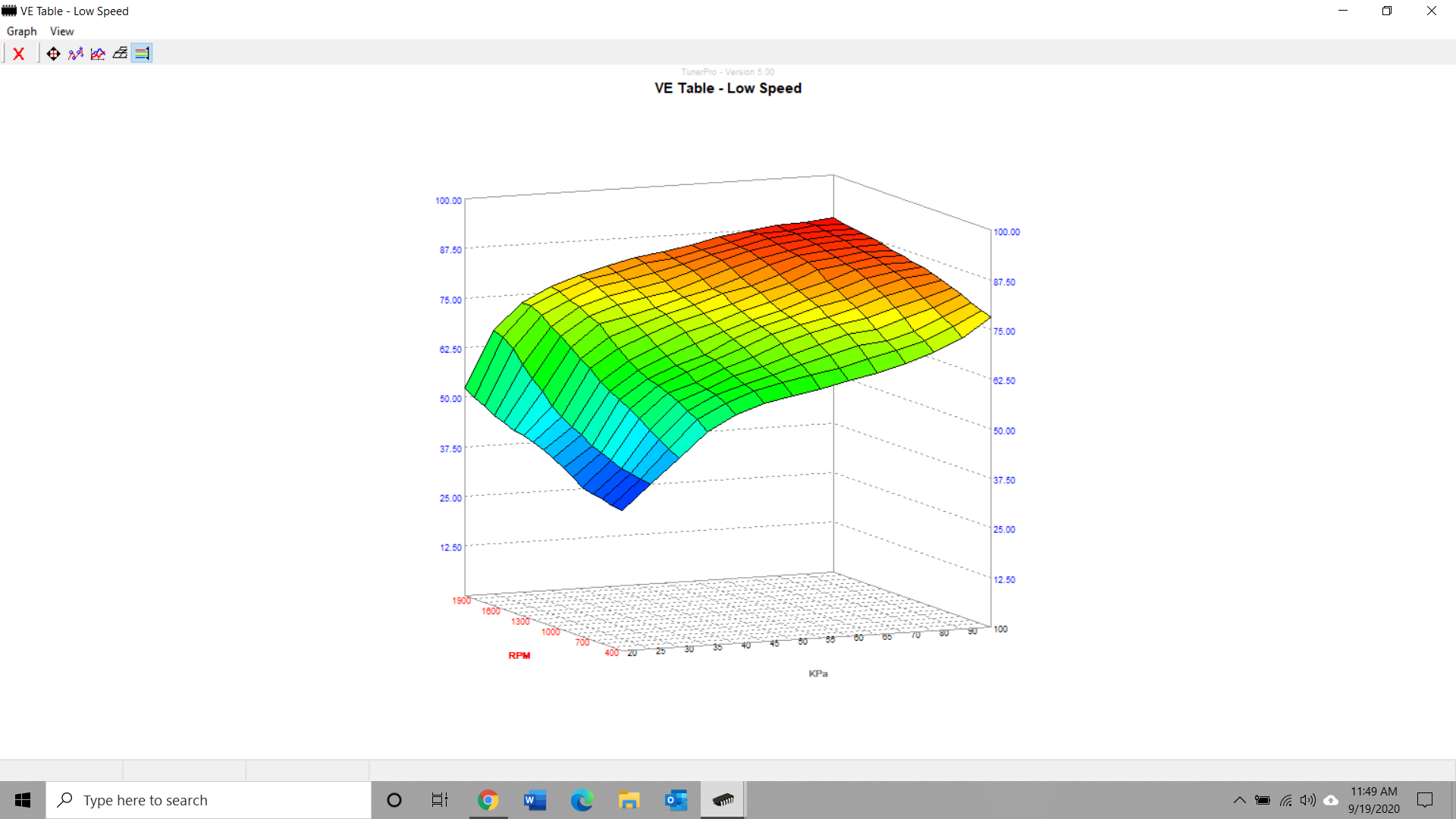

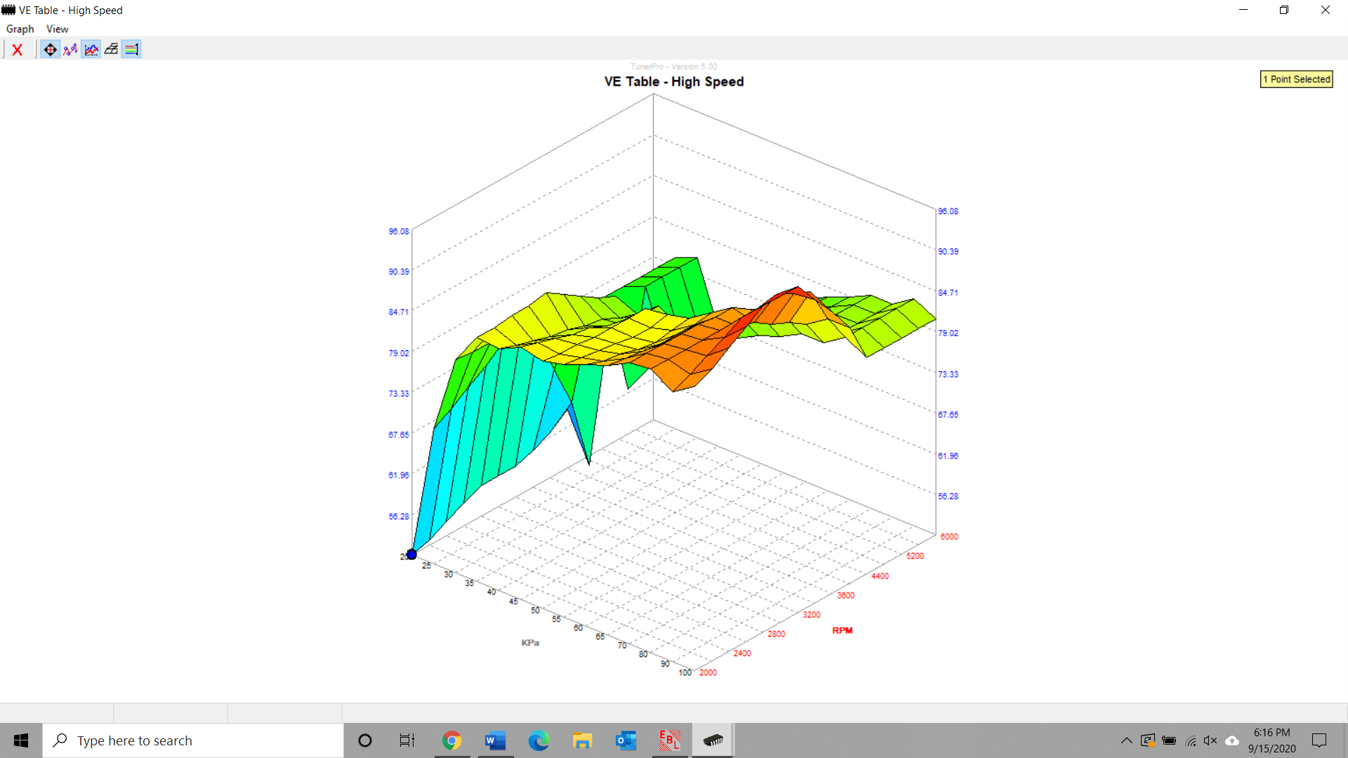

Rob, these are the before and after VE smoothing shots. Should I keep smoothing? Am I doing it right?

Excellent. See how she is smoothing out? It must feel great at that RPM now, great job. If you need help with the AE tables by compensating for injector size or pressure just say the word, unless everything is stock (injector size and fuel pressure) then just leave it alone. Great job!

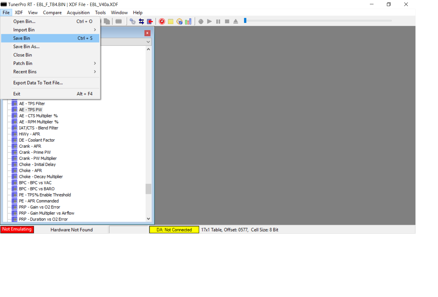

Follow these steps Jamie;
* Upload your most current bin into Tuner Pro (I'm using TB4 as an example), and open up the two Acceleration Enrichment tables that we are going to change; AE - TPS PW & AE - MAP PW...
* Drag open each pop up box so that the Value box is visible. Highlight all rows at the same time in each pop up table (will turn gray shaded to indicate you highlighted them for a change, as in the pic), and set your function right above them (in the pop up) for Multiply, as well as using the Value of 0.77 to the right of Multiply. When this is confirmed, then hit Execute to the right of the Value box...
* After you hit Execute, you will see all of the values you highlighted change (decrease in value), as well as turn red indicating they were changed. You will do this one pop up box at a time. Again, I am using the TB4 bin as an example, but the values might be the same in yours back in the first picture above, and if they are, make sure they are now the same as the Red values afterwards...
* Now you need to save your work. Click on the floppy disk in each pop up box (see the added red arrow above the word Function in both pop ups to find the Floppy Disk, it is very thin when I added it in, but it is there), and click on it...
* After you click on the floppy disk (save) in each pop up, they will then disappear. You made the changes, however you need to finalize the saved work in the bin you are using. Click on File on the top left in Tuner Pro (see pic below), then click on Save Bin which is highlighted below...
If you want to double check your work, you can close out of the bin, then re-open the bin and click on the same two tables you changed, and make sure they are now displaying the changed values that you see above in Red. If they do, then all is well. You can now Flash it into your EBL system...
- Rob

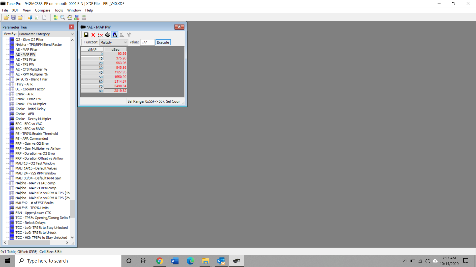

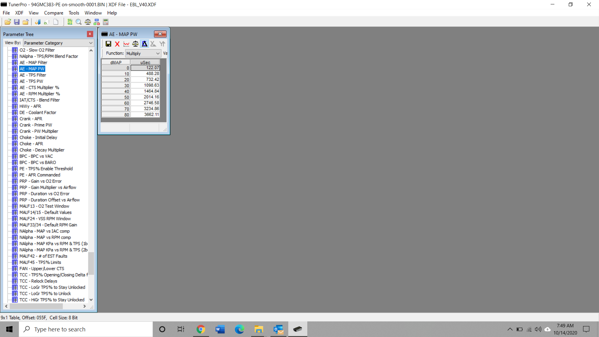

OK, I've tried it again and I got it to save, except, the numbers don't match up with the numbers I got yesterday by doing it long hand, (multiplying each line one at a time), on the AE TPS PW. Is there some other sort of math going on in the program?
The first line reads 122.07 on the AE TPS PW. After highlighting the numbers and multiplying, that first number does not change it stays at 122.07. I've tried several times and keep getting the same results after saving. With that said, when I use the multiply function the numbers are the exact numbers I got yesterday when doing it by calculator. After I save it, close it then reopen it the numbers are not the same and the first line again reads 122.07, same as before I multiplied. The number I had after I multiplied for 122.07 is 93.99 and that is what the number is when I save but is 122.07 when I reopen. I'm sending a screenshot. The first screenshot is the results of multiplying by .77. The second screenshot is before multiplying. And the one in red is after multiplying but before saving.
Looks like the screenshots didn't come out in order sorry.

Still came out with the same numbers as in the screenshots I sent a few minuets ago. Can those numbers be right? That doesn't really make sense.
Jamie, are you questioning why the numbers are decreasing in value, or something else...?

I know they will decrease because you are multiplying by less than 1. If you look at the numbers in red from my last post, they are the correct numbers, right? They are the same numbers I got with a calculator.
The first screenshot shows the numbers after they were saved. Notice the first line in both before and after screenshots, both numbers are 122.07.
In the before screenshot, (the one with the highest numbers), if you multiply them by .77 the numbers you get are different than the numbers in the saved screenshot, the saved screenshot is the one with the lower numbers that are not red.
Jamie
This is normal, the resolution of the AE PW values is about 61 uSeconds. So a value needs to change by at least 31 uSeconds in order to actually change to the next multiple of 61.
You can check the resolution of various parameters by looking at the conversion equation in TunerPro.
