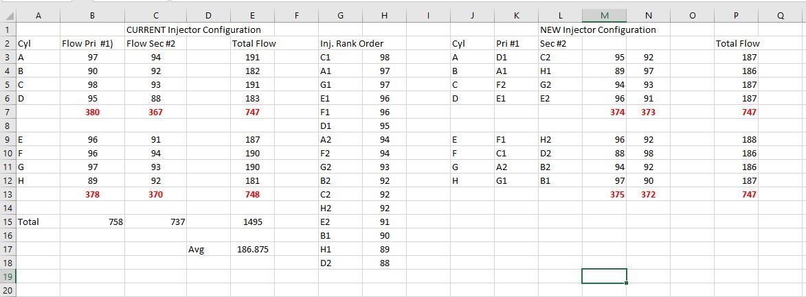

With the information of the flow test I was able to match up pairs of the injectors so that I was able to tighten the range of fuel flow(on a cylinder to cylinder basis) from 10ml down to a difference of only 2ml. when operating on all injectors. To me this also strengthens the argument for running all injectors during LT5 engine operation.
For idling operation, I was able to lower overall fuel and reduce the disparity between banks by 50%, albeit 1 ml.

Another update on this. The re-balancing of the injectors has had clear impact on how the motor is running. Much smoother and quieter. However, I have found that in doing the necessary re-mapping of the VE tables, I have taken out about the 3-5% fuel, resulting in better mpg(>1.5mpg) and cleaner exhaust as evidenced by my exhaust tips. But since all fueling is dependent on the VE tables, I am also needing to re-visit my Acceleration Enrichment. Removing fuel from the VE tables is requiring me to put it back in for AE. I have been getting audible knock in certain circumstances resulting from an insufficient “pumpshot” due to reduced fuel. So AE now needs to be not only increased, but also lengthened in terms of duration.
This also would affect the PE parameters for WOT, but I’d rather do that on a dyno.
Old Jun 10, 2021 | 08:23 AM
Dominic Sorresso's Avatar
Posts: 1,997
Likes: 12
From: Bartlett, IL
Car: 92 ZR-1
Engine: LT-5
Transmission: ZF-6
Axle/Gears: SuperDana 44 4.10
Re: Flow Matching Injectors
Wow! What a difference! Increased AE, AE delay and the duration of AE phaseout. No knock. Thanks again to RBob for his help on explaining the code.
