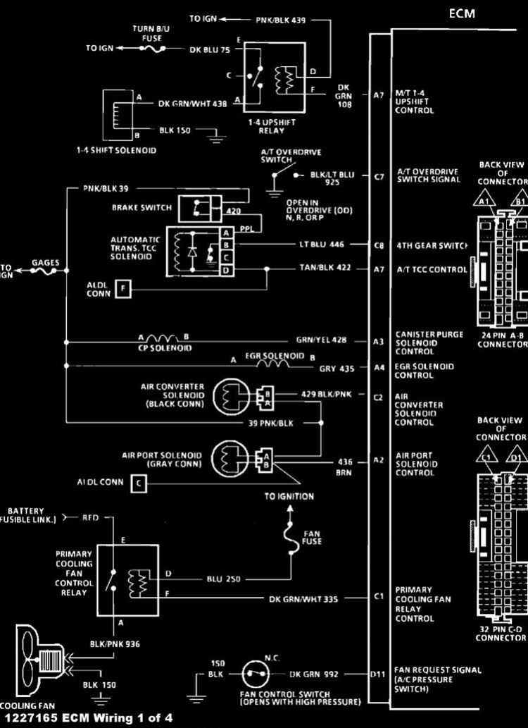

Hi guys,
I'm running the arap.bin with Tuned Performance's $6E.xdf file.
Scalars: All of the lock, unlock and the prevention speed are set to 16MPH. Coolant enable is 16C.Minimum load hysteresis is 16%TPS. Minimum high/low speed threshold is 16MPH. I'm sensing a pattern here.
If I drive in Overdrive, 1-3 shifts are nice and strong, especially 1-2. However, it surges when shifting into OD, going right back into third.
Should I leave everything as-is or should I adjust them? Running around in D is fun as hell but I'd still like to use OD. Any advice?

Something isn't right about what you are seeing. The stock ARAP BIN isn't set up that way.
Does the trans have the high gear switch to the ECM? If so you can set up the high gear (4th) tables to lock at a higher MPH.

I don’t know what that is or where to find it. I’m using TunerPro.

Oh! I thought you were talking about a setting in the bin. I'll check the connection. OD has always worked before, but I haven't really driven it since I uploaded this burn.
