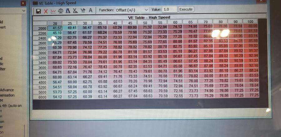

I got some choppy VE tables that I then learned how to smooth using information on this site. (I haven't ran this new table yet)

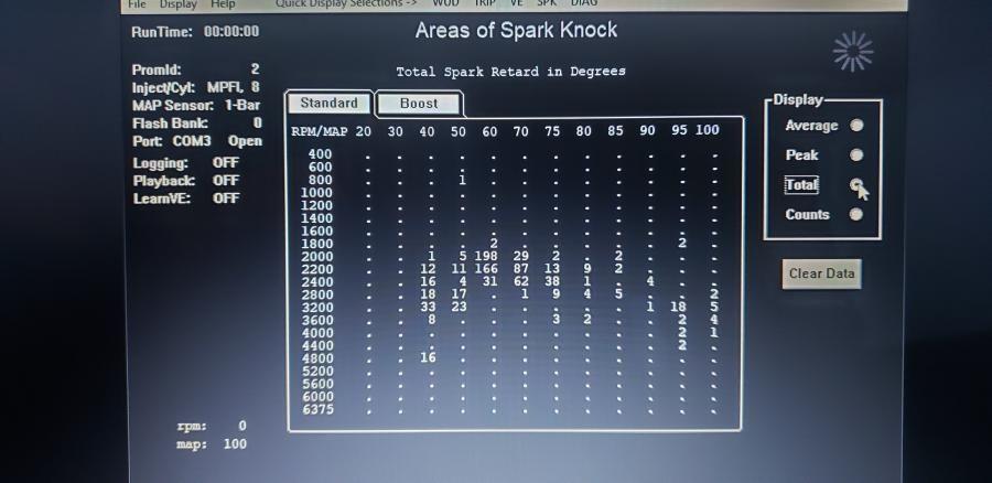

Spark retarding seems to happen the most at around 60 MAP/2000rpm and 2200rpm and around that area. (I had the base timing in the BIN set at 6 deg BTDC even though the dist was actually set at 12 deg). I then set the Base timing in the BIN at 10 degrees BTDC (distributor still set at 12) and had almost no spark retarding.
I'll post some pics of the What's Up? readings and the VE tables from TunerPro in a second from my phone.

Here are some pics of my data and tables: This is the spark retarding with 6 extra deg of advance the ECM didn't know about.
After pulling 4 degrees of timing

High speed VE tables which didn't change much on VE learns
