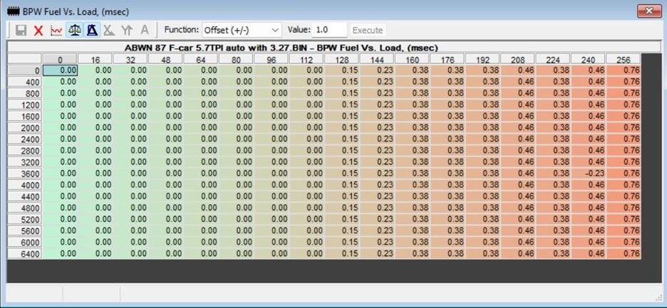

Read as 27c128 it’s a 16k file size
https://web.archive.org/web/20220507...using-offsets/
27C128 says memory range outside EPROM size. 27SF512 seems to work although I can't seem to figure out how I actually saved what I read.

Try that. No idea if I did it properly
File Type: bin
Corrupt!

Originally Posted by SbFormula
Corrupt!
Chip is a D12728A. I don't know if that means anything to you
Old Feb 5, 2023 | 02:32 PM
  #55
SbFormula's Avatar
Joined: Jun 2012
Posts: 1,371
Likes: 196
From: Canada
Car: '18 Chev Camaro SS 1LE
Engine: LT1 6.2L
Axle/Gears: 3.91
Re: What would you start with after engine mods?
Nope
Check online, you-tube etc.. There are videos on how to read a chip. Depends what you are using. The chip has to be aligned properly (nocth). But if the chip is already in the memory adapter (JET is), then you have to install the memory adapter into another adapter, that goes into the burner. You need to offset (skip) the first set of pin holes and make sure the notch is towards the burner handle (Moates)
You need to plug everything up before you open TunerPro

Your offsets are wrong if it’s a 32k file size
27c128 read chip address and buffer starts all zeros
end address 003FFF
Nope
Try that
File Type: bin
Old Feb 5, 2023 | 03:07 PM
  #58
SbFormula's Avatar
Joined: Jun 2012
Posts: 1,371
Likes: 196
From: Canada
Engine: LT1 6.2L
Axle/Gears: 3.91
Try that
Yep works!
I can't compare it because I don't have your '87 AT OEM tune. You have to extract it from your eprom.
Don't work!!! Is this a $32 or $6E BIN?
Yep works!
Understood. That's the one under the Blue cap in the ECM, correct?
Yep, but you can't remove it. You have to read it using the whole eprom and adapter
Old Feb 5, 2023 | 03:11 PM
It’s based off ABWN
Old Feb 5, 2023 | 03:13 PM

It’s based off ABWN
ok, so $32B. I don't have the XDF for that... yet lol
I hope it works. Really curious as to what you guys think of those expensive "gain 30 HP chips"
They basically added a bit of fuel on an already OEM rich tune (ABWN) and a bit of SA
EDITED:
As far as I am concerned, I can't see 30HP with just this tune. Impossible IMO.
EDITED:
I agree. That there is digital Snake Oil that 20 years ago I fell for. Mind you the information wasn't as easy to come by as it is today.
I'm no expert of $32B, but it seems that the MAF tables are used in ABWN instead of BPW Fuel vs Load. If it's the case, the modification to BPW Fuel vs load by Jet is useless.
Maybe @Tuned Performance could chime in.

I honestly don’t use $32 or $32B so not sure I use $6e
this answers a lot of fueling questions
https://www.thirdgen.org/forums/diy-...b-tunning.html
What's the reason against the 32B? Mind you I do see quite a difference between that and the 6E

A few reasons , easier to adjust maf tables, cold start injector disabled with cold start enrichment.
To me at least 32B seems a bit dumbed down, almost basic English and a bit more self explanatory. There's an EGR flag for example that can simply be turned off. There is no flag in the 6E. Some of the scalars seem a lot easier to understand however that may simply be my limited understanding. Just so I'm clear. The BIN can be programmed with either 32B or 6E?

I don’t use tunerpro much for editing but just depends on your xdf expanded $6e has a flag I believe but that’s just for the malf. To disable need to max coolant temp to enable.
is a bin is 86 it’s $32 , 87-88 $32b 89 $6e heck there’s $12p if going sd. Anyways edit bin with proper xdf. They’re not the same but yes any of these masks work in the 165. There’s even wideband tracking bins for d8 wideband input. Same with datalogging not sure but I think 86-88 is 160 baud upgrading to $6e not positive but think you can connect at 8192 .
might look at this xdf fir $6e I have been using TC
https://www.thirdgen.org/forums/diy-...code-36-a.html

Just read a 2010 article on MAF tuning. Cleared a few tings up. However I'm not sure where to start with regards to fuel injectors. I have the Bosch 3 M-9593-BB302, and I entered the v-bat/voltage offset per that table. The injector sheet says the numbers were done at 39.15 psi. Our cars run 43. I don't know if it'll do less than that even with an AFPR. I believe that makes them a 31 pound injector. Probably not a big deal. The issue I'm having right now is the long crank time. I did not experience this with the ARAP BIN. The APYP BIN acts like there's no fuel for about 6 seconds, then it lights off. Not quite sure what parameter gets changed to deal with the startup fuel shot.

add .500 1-8 crank pw multiplier vs ref pulse

So, if you changed the injectors size from 22 to whatever you have (31 or 32?), the ECM should spray too much fuel for the 350 at start-up. Not the other way around. The ECM opens the injectors for a fixed amount of time on cranking. So bigger injectors means more fuel, not less.
Initial timing still at 6*? Might want to bump that.
If you data log the long cranking, check what voltage you get, but mostly, check if RPM goes over 300. There is a bitmask on tunerpro for "Engine Run". It needs to turn "on" to activate injectors. ECM won't declare engine running until it sees over a certain threshold. I believe it's 300rpm. It's a common problem with TPI when the starter or battery get old. Sometimes when the car sits for a while, battery depletes or old starter needs more time to spin effectively.
Old Feb 9, 2023 | 07:53 PM

Formula goes like this:
305 engine with 19# injectors = 19/305 = 0.063 ratio (OEM)
350 engine with 22# injectors = 22/350 = 0.063 ratio (OEM)
350 engine with lets say 30# injectors = 30/350 = 0.086 ratio
Adjustment = .063/.086 = 0.73 factor
Means you have to multiply the table Injector PW vs CT by the factor to reduce fuel. That should get you in the ball park then you can fine tune after.
ARAP and ARPY have 1-8 zeroed out. So they're should be no difference for the OP right? That's not what is causing the problem IMO. It's only 8 DRP, far from 6 secs.

Added fuel to get the engine to pop off seems to help . Worth a shot . Some 305 tunes have pw in the lower drp cells.

ARAP and APYP have same DRP cranking multipler! Unless your ARAP was modified
noticed that and could never understand why gm had such a difference
I would bump them up to 50 psi Key On Engine Off, multiply out the flow rate as well as offsets for the 50 psi setting. The 85 TPI setup I had on my G20 was set at 46 psi stock. It is also not hard to calculate the break point so that you can figure out where the base pulse adder ends. On the Raptor injectors in my Express it is at 1.6 mS. Minimal corrections needed on the 6.2L injectors.
