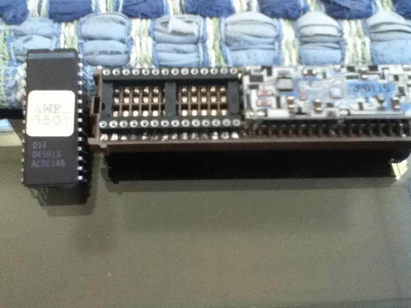

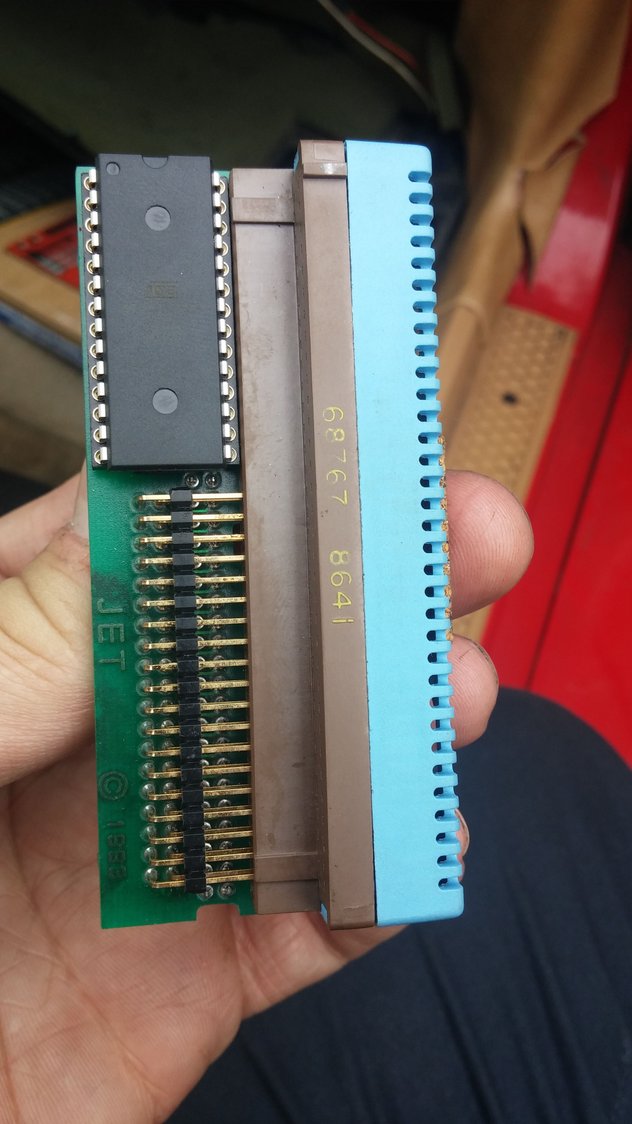

Re: What would you start with after engine mods?
I like to use a dip socket and then put in a sst program
directly with this header.
https://www.ebay.com/itm/12202987242...mis&media=COPY
This is my current setup

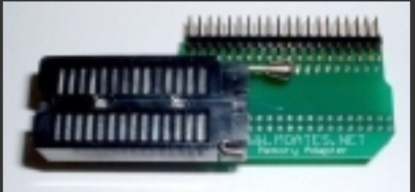

Old Feb 4, 2023 | 05:35 PM
Tuned Performance's Avatar
Community Influencer
iTrader: (95)
Posts: 16,927
Likes: 1,016
From: Mile High Country !!!
Car: 1967 Camaro, 91 z28
Engine: Lb9
Transmission: M20
A piggyback works, for tuning ease you can remove the sst and install a zif. Makes flashing faster. Long term not sure it’s a good thing for an automotive application.

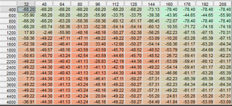

Here's a tool I use to adjust MAF scalars/tables based on BLM/INT values. You need a data log to determine in which area you are rich/lean, then make mods.
Now beware you could max out the MAF tables it your 350 likes to breath!

I think I'm going to load the APYP BIN. with the 6E. I've changed the Fuel injector voltage values with info from the Bosch 3 thread. Disabled VAT's and turned off the EGR...I think. Single and double fire scaler is set to 30# as well. @SbFormula , thanks for that thread. I took a look at the .BIN in that thread. Will that work with the 87 6E just in case I want to try it as a comparison. I'd really like to learn this on my own with the help of the community rather than just copy something over. I'm just using that as a guide at this point.

Apyp might be the best start for a manual transmission.
Haven’t worked with flowtech heads so the stock 113 timing might be to much.
using this bins easy, change fan switch setting, delete vats. D3 offsets and flow single and double fire. Datalog to refine
I noticed the base timing on this BIN is 16 degrees. Is that correct? That seems pretty high. The base timing at least on the F-Body was 6. Unless this is an aluminum head Corvette specific timing.
EDITED:
I don't think it is going to work well. Several reasons:
Start-up fuel has to be adjusted for 350cid and 30# injectors
Open loop has to be retuned using AFR gauge
A.I.R.S. has to be disabled also
100mv O2 adjustment for A.I.R.S has to be zeroed out
MAF tables are going to be out of whack because of 350cid... Probably way too lean.
Probably need to adjust O2 windows for idle (need AFR gauge)
Whole SA tables need tuning for your application because of your LV8 curve (torque profile) which will be different than the LB9 as well as idle/cruise
PE tables need adjustment to match your torque profile.
Fan is set to work with 195°F thermostat
Initial timing is at 6*
Cold start injector still in place?
That's just a few things I can think of for now.

It's not you who's confusing me lol. I'm doing just fine on my own in that regard. As for that fan data. What parameter am I looking for to make the 180 degree change? There's quite a few that mention fan. As for anything that mentions TCC. Do i basically zero all that seeing as I'm running a 5 speed?
On another not. I just read my very old JET Performance Stage 1 chip. Is that ever different. Base timing is 64 degrees and advance is set to 88 degrees, and look at that spark advance table.
If you use APYS, the AT parameters are already turned off for you from factory.
For the FAN, use TunerPro and bring it down to what ever you want. I like to set mine 10°F over thermostat temp, so for 180°F, I set 190°F. Personal preference. Others might chime in with their experience. If you have dual fans, you need to change the fan#2 switch on the engine for a lower temp one.
Please search TGO (I know it takes time). All your questions are most likely already answered.
When I bought my bone stock '89 IROC, the previous owner (R.I.P.), who knew not much about cars, wanted is IROC-Z to be faster as he thought she was sluggish. Little he knew, she needed some tune-up, etc... But that's another story. So his buddy, who I assume knew as much as he did, convinced him to buy a JET Performance chip. Well he did but never installed it. So long story short, when I bought the car, the chip came with it in its original box and invoice. I did a comparison with the OEM APYS from the IROC-Z and all JET did was up the timing at 4400-4800 rpm in the main SA table at maximum LV8 of 208.
Here's the kicker. The LB9 barely reached 192 LV8 from 4400rpm and up and SA was being pulled by the ESC anyway!!!!!!!!!. The chip was useless.
I copied it, kept the adapter and threw the rest in garbage where it belonged.
Problem is, I overwrote the BIN by mistake so I can't substantiate what I am saying. Sad story.
Ugh so much to learn.......
Attached the JET BIN. I'm interested to see if I can read it

Originally Posted by SbFormula
When I bought my bone stock '89 IROC, the previous owner (R.I.P.), who knew not much about cars, wanted is IROC-Z to be faster as he thought she was sluggish. Little he knew, she needed some tune-up, etc... But that's another story. So his buddy, who I assume knew as much as he did, convinced him to buy a JET Performance chip. Well he did but never installed it. So long story short, when I bought the car, the chip came with it in its original box. I did a comparison with the OEM APYS from the IROC-Z and all JET did was up the timing at 4400-4800 rpm in the main SA table at maximum LV8 of 208.
Here's the kicker. The LB9 barely reached 192 LV8 from 4400rpm and up. The chip was useless.
Well I have the chip in front of me. If I can figure what offset I'm supposed to use I'd be more than happy to get it to you so you can laugh allover again at what a ripoff it was
Read as 27c128 it’s a 16k file size
https://web.archive.org/web/20220507...using-offsets/
